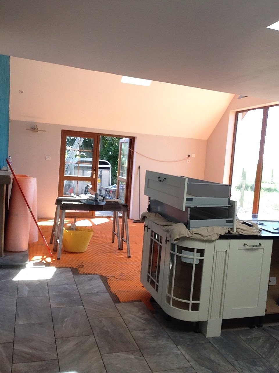

dude, it would then be 6mm ply screwed at 100mm squared intervals on to 25mm ply... thats more than good enough. 9mm would raise the floor too much as there is already a bad step in to the room. if i cant get a perfect lift on the old floor and it is uneven, then i will have to consider lifting the 25mm ply as well and replacing with 18mm caber flooring glued and screwed with 9mm screwed on top of that.
6mm ply?!
6mm on a perfectly flat solid newly constructed floor is fine.. agreed not good enough for anything else.... christ almighty.... clint eastwood once said.... opinions are like assholes.... everybody has one.
There are far better products these days than ply. Why not use a proper tile backer board?
would a bal membrane glued over the whole floor stop the sideways movement, because that is the main issue, but ply would also help with any vertical movement.
