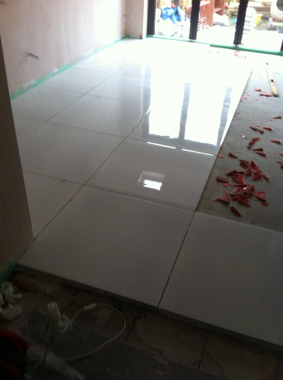

Sorry average, just saw your msg, well the height difference your looking at is the 2 rooms, so it's built up of underfloor heating board, self levelling compound, adhesive then tile, the adhesive is not too thick there, im planning to get some thick underlay and carpet, then if there's still a difference between rooms just get one to those strips to bridge the difference.
Well, I've tiled 60% of bathroom walls, enough to get a bathroom fitted over it, I still need to finish the rest, and grout walls and floor in there, then I can get back to the floor in the main room. I've been ill, out of the country, had other work done and all other excuses I can think of! Hope to get cracking again tomorrow, I've been having a nightmare removing the red spacers from floor and wall, some of them aren't cracking off cleanly, so I've been trying to bang down under grout line, or wrapping a j cloth around a scraper and trying to get adhesive/spacer out that way. I also choose not to centre around window, so I'm sure I'm going to get some flack for that when I post pictures.
