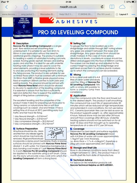

I have to agree with Alan - thermal shock on the slc.
If the floor had too much deflection I would expect to see a lot more crazing and loose areas in the slc rather than the way it looks here.
If you're struggling with Warmup on email (give them a day or two) pm me. I have mobile numbers for some very helpful people there.
is it possible for my warm up timing to of caused this?
Yes - if you heated it too high and too soon.
Also, if you fixed the Ditra while the slc still had excess moisture in it, then that trapped moisture could have fried the slc.
Do you know how thick the slc was and how soon you fixed the ditra after pouring the slc?
the slc is approx 8-10mm, from pouring to laying would be approx 48hrs.
it was jackoboard, not glued, just screwed.
image.jpg Norcros instructions, do not turn on for 14 days, and then bring temp up max 5c per 24hrs.
