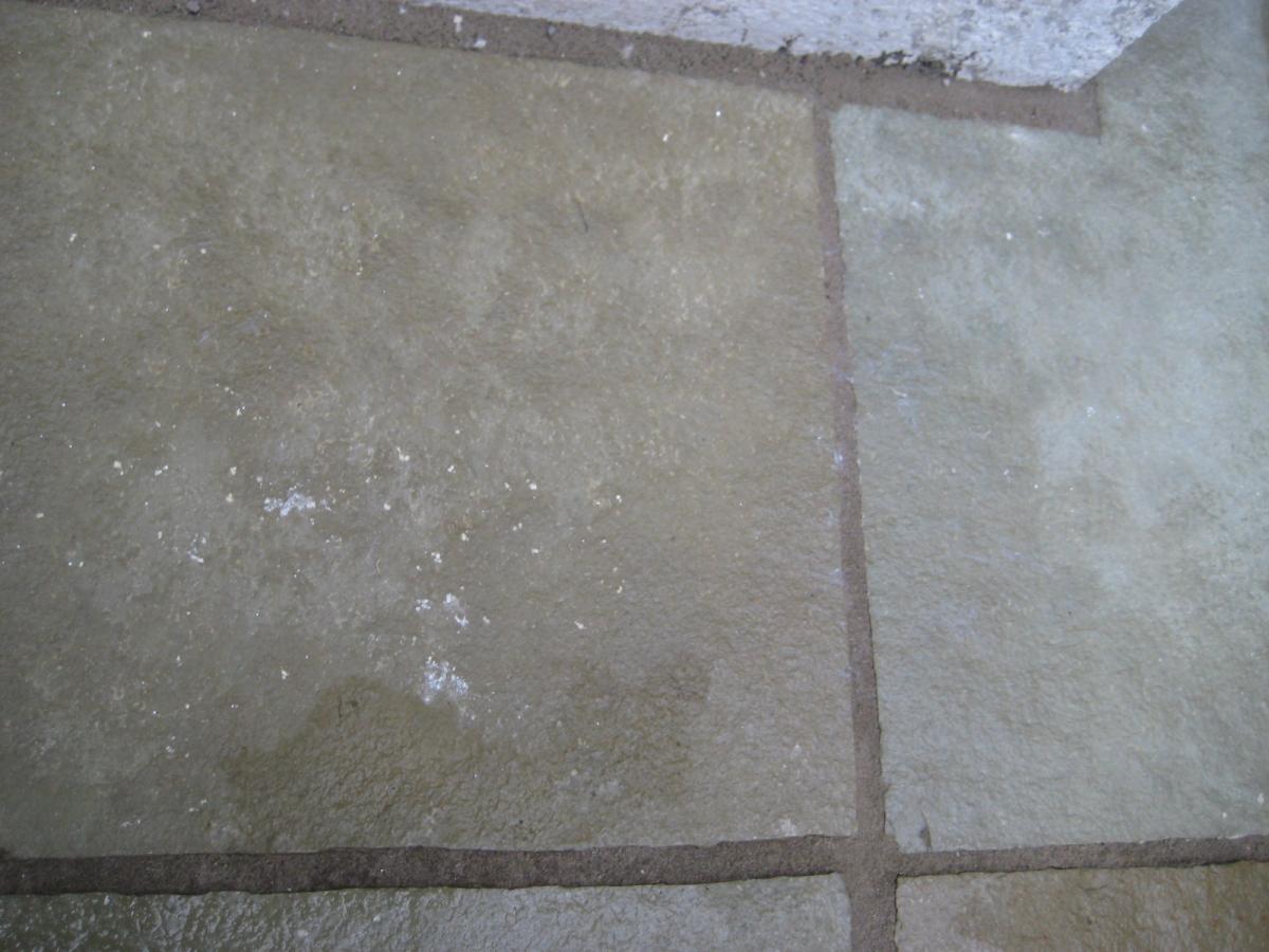

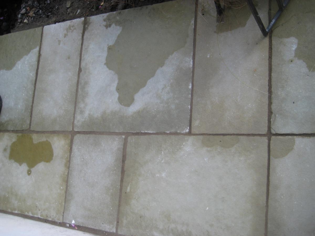

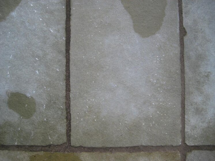

For Dave some pics from camera this time ignore some obvious rain patches. Overall it looks dirty. Hope I can do something. Jm

Ok.. As i thought.. the slabs must have been damp as they have attracted the geo-fix to lay on the surface after installation and hence has left a residue..
This can be removed with a residue remover.. the one posted above is a good one and Tile giant stores will sell that one.
After you have cleaned them then i would recommend a colour enhancing sealer which will give the colour like they are when they have been wet but not glossy look.
LTP colour enhancer from tile giant as well.. always follow the instructions carefully.
