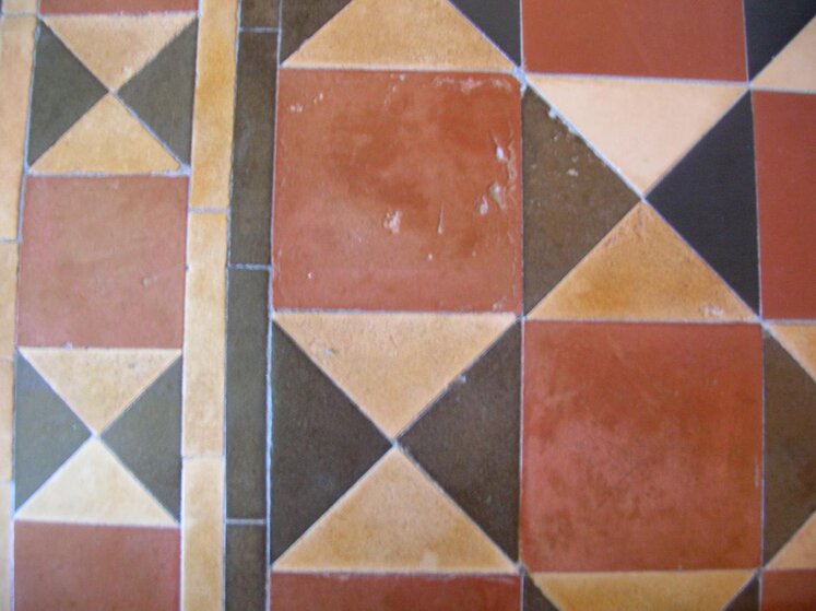

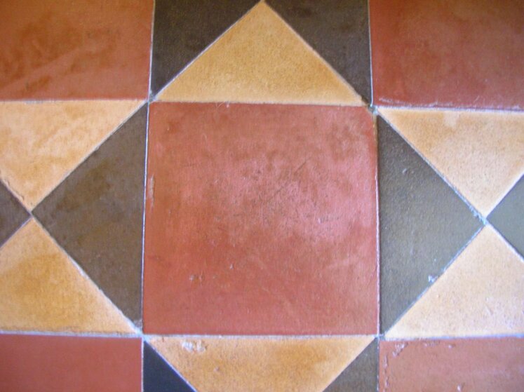

Here are some photos which I hope will help. From what I can remember they do look better when wet and the white patches show more as it dries. Thanks.

From the pics it does look like you still have some topical sealer left.. did you just apply to the pad and scrubbed or have you applied and left to dwell.. then scrubbed..
You do have to careful with over wetting though.. as this can cause further probs.. Quite a few of our viccy tile installers have tried and tested methods .. some even use Nitromors..
Hi. I just scrubbed it but did not leave it to dwell because i was worried about over wetting the tiles. I think some of the tiles do still have small areas of Golvpolish left on them but I don't understand why bits of them are white. I have tried re aplying Golvpolish to the white areas in the hope that it will lift the colour but it just looks the same. The white bits look like staining to me rather than efflorecsense but I am not sure.
