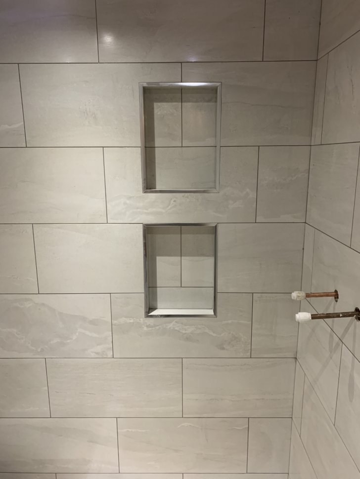

I bought a evolution chop saw and stand with a multi function blade (around £120 from Screwfix) if you have the room to set it up for the duration of the job it’s great as it cuts everything and leaves a great mitre 54D4BAEA-8D41-4CEF-AF9D-07610C4CC4CC.jpeg
I bought a evolution chop saw and stand with a multi function blade (around £120 from Screwfix) if you have the room to set it up for the duration of the job it’s great as it cuts everything and leaves a great mitre View attachment 111935
Just got to mind the old digits! 😉
