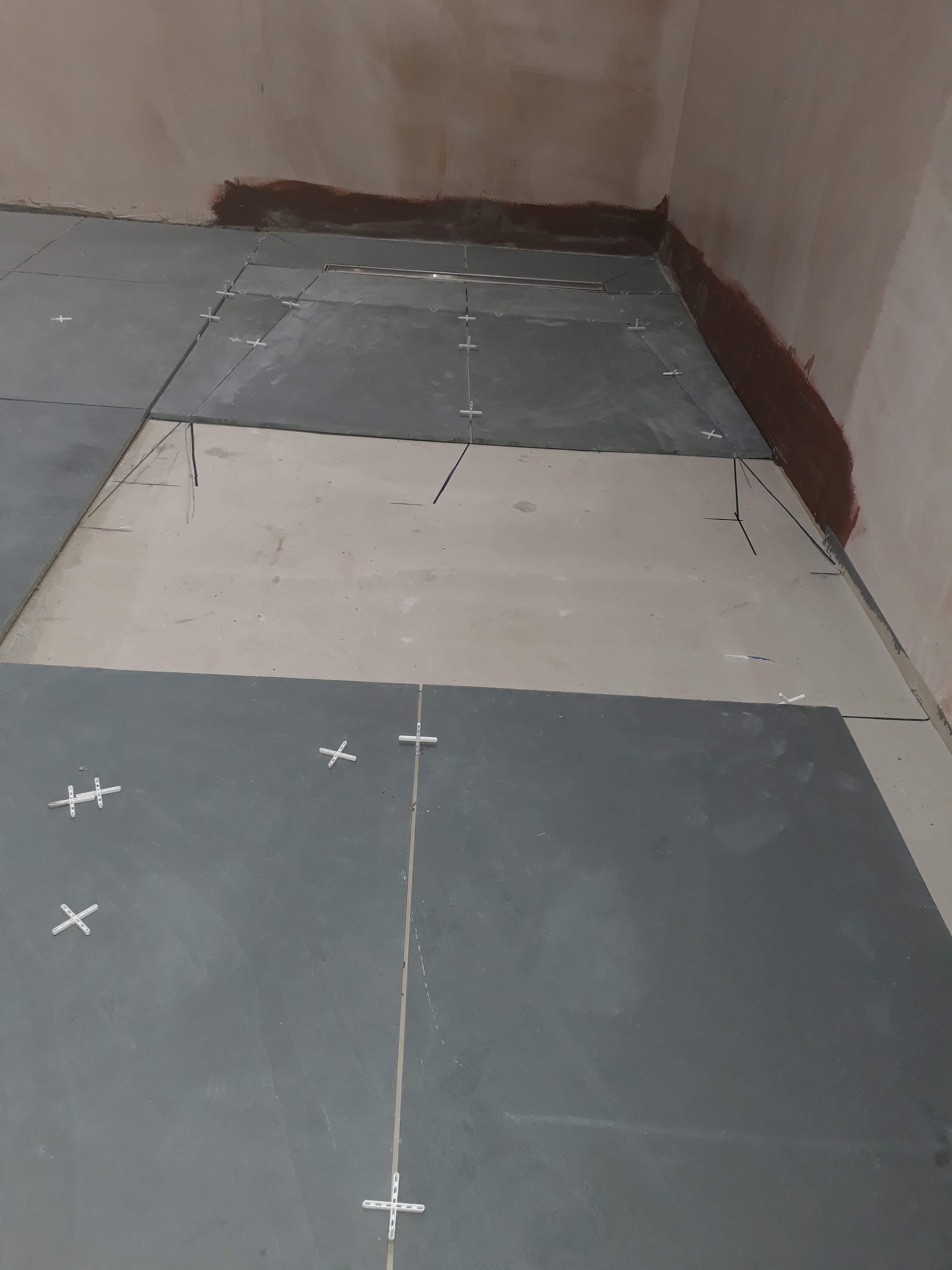

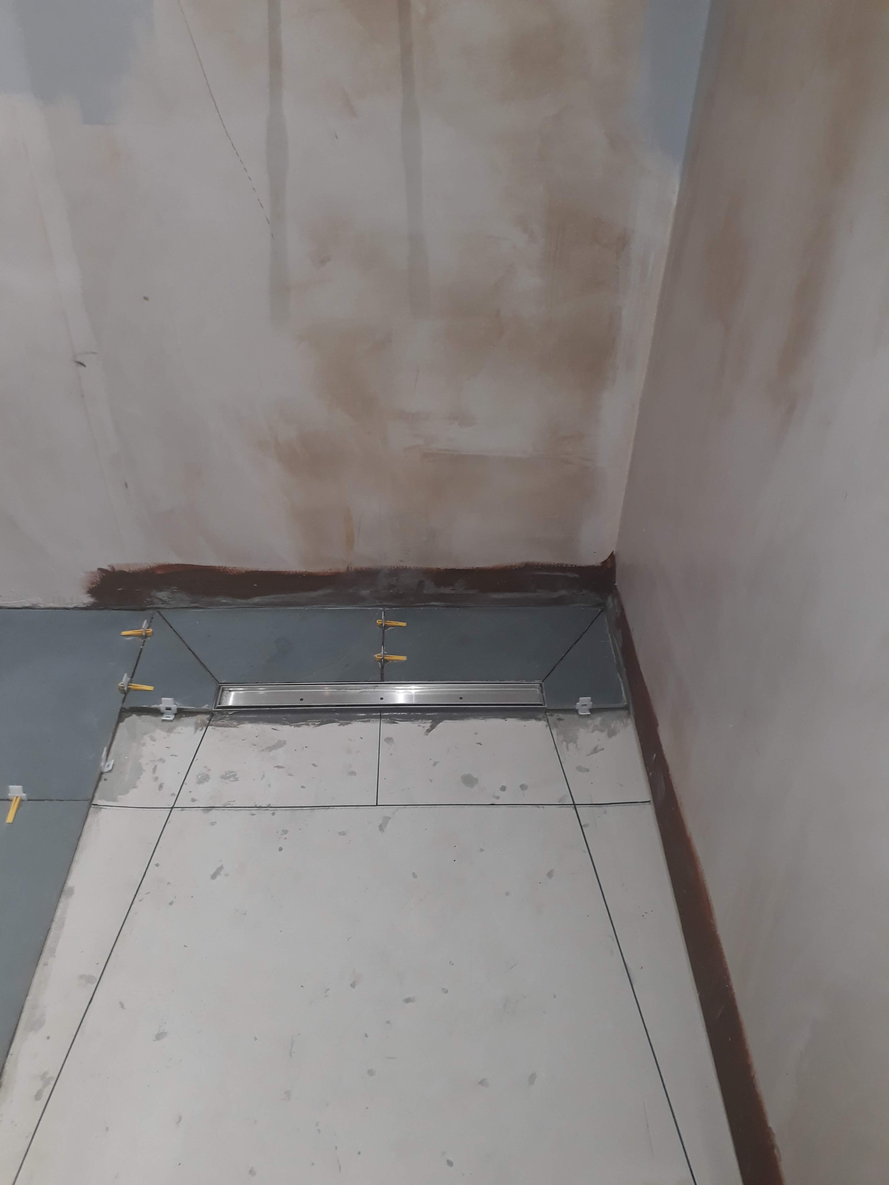

Hi guys what's the best way to finish off this and get the tiles back into bond ? Cheers w

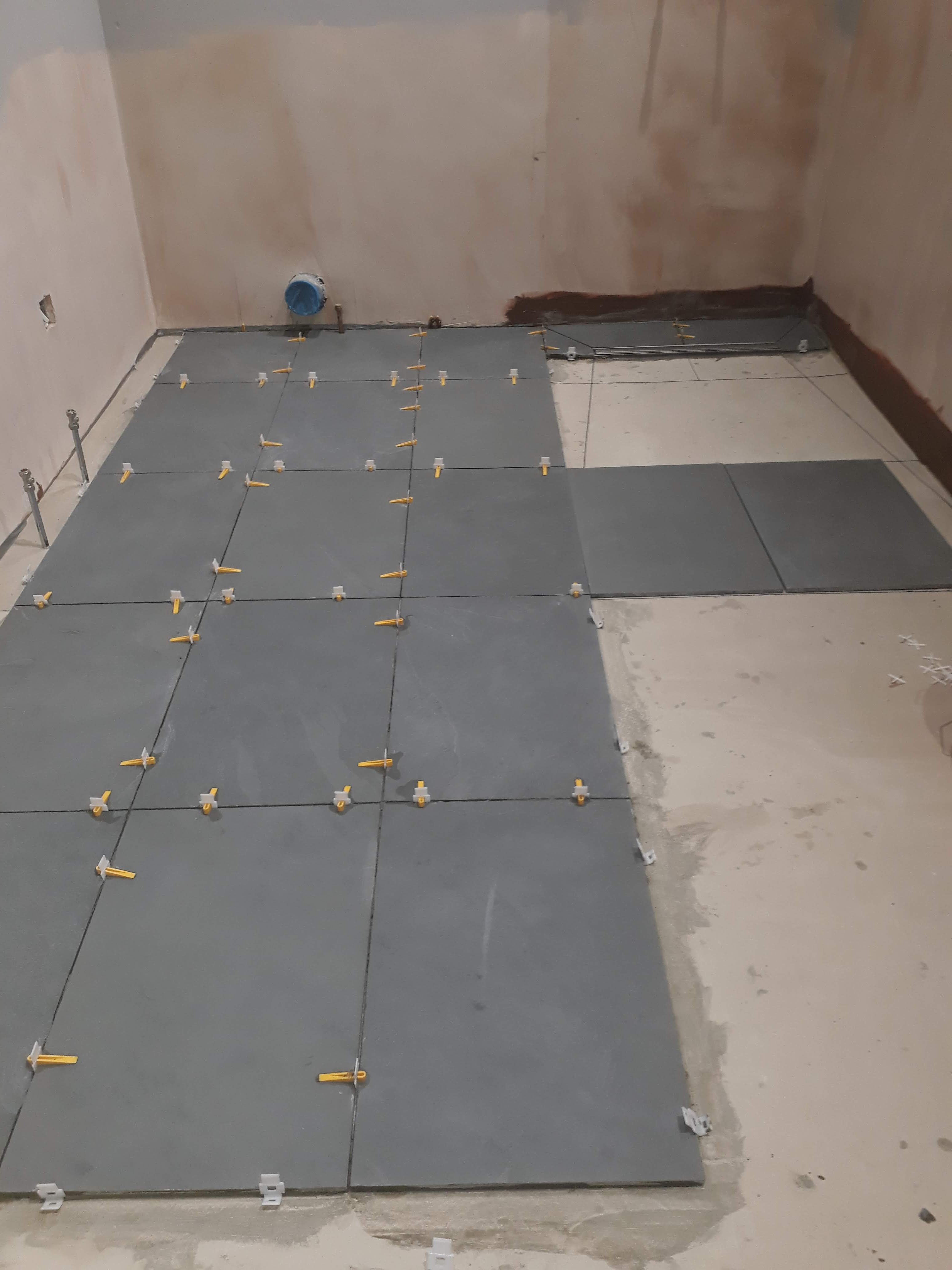

The envelopes should be cut out of the bond you already have on the main floor, looks like you've got a 100mm cut running down rh side, this should be followed through to the tray, is it all stuck down or could you rethink the whole floor set out?

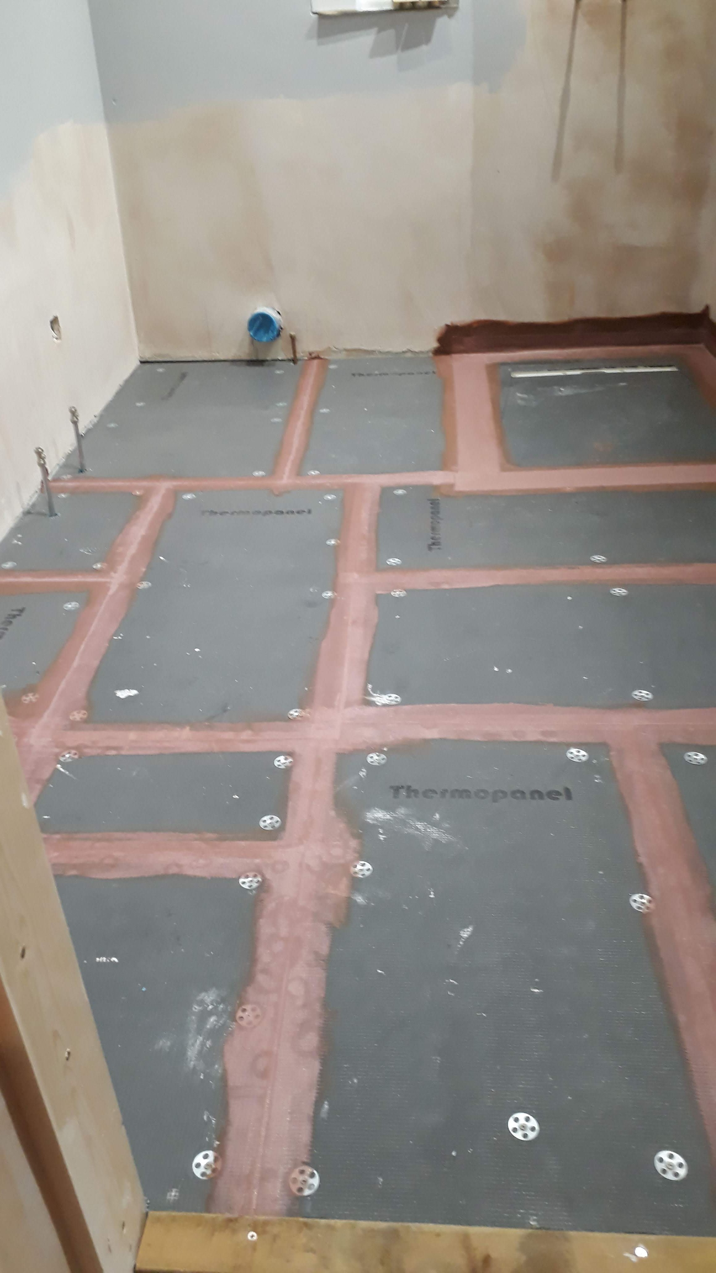

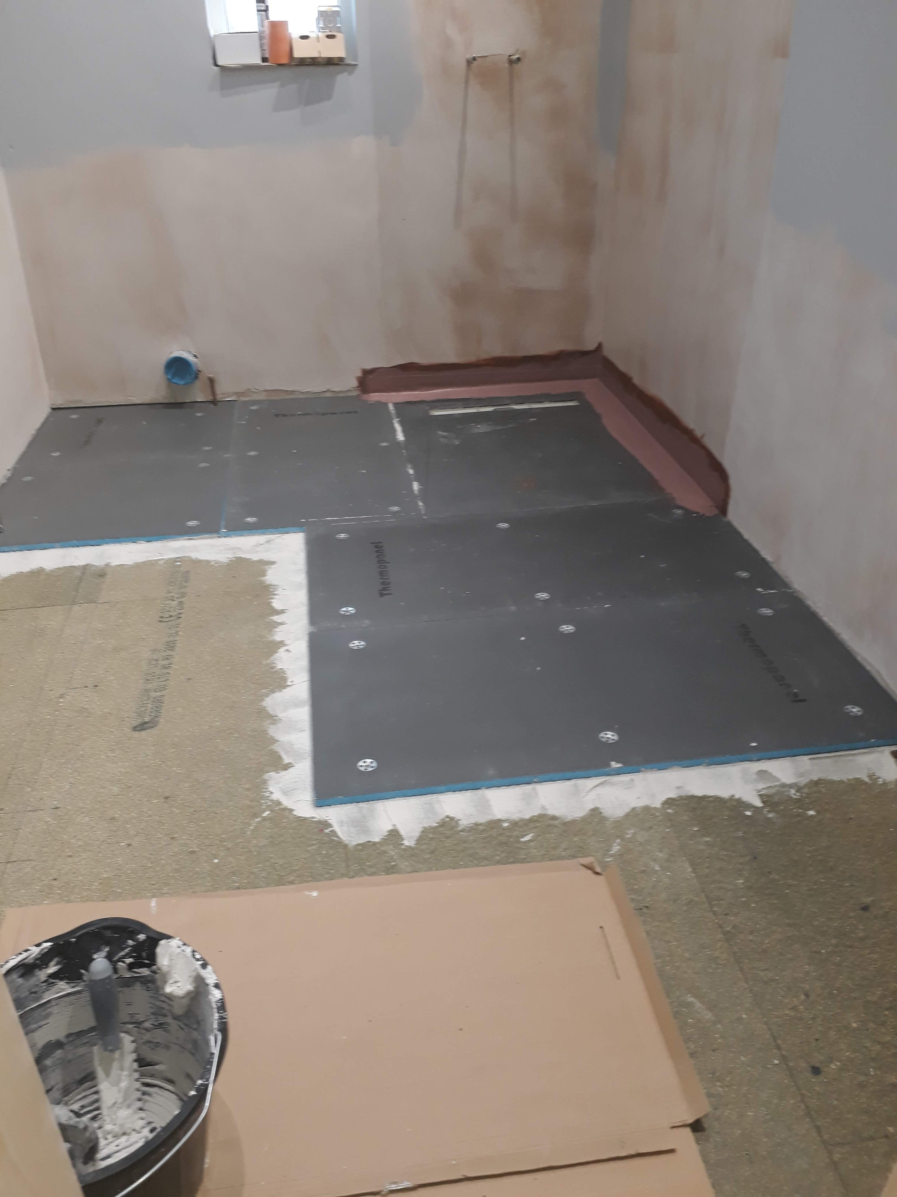

Can't see much evidence of tanking around the wet area?

Sorry guys still there i didn't flood that area slopes are still there you can see em on the marked out picture confident on the tiling just need to get back to the bond in the nestest way thought you guys may have few ideas ? if not will do the the remainder first and work out some cuts to get me back ? All the best Kop

Yes I see your predicament now - you’ve centred the outlet with a joint!
So as you say you’ll have to recut away to the side to continue the bond line of the tile widths. May have been a larger cut to both side walls with a tile centred on the drain outlet and then to follow the bond up the walls.
