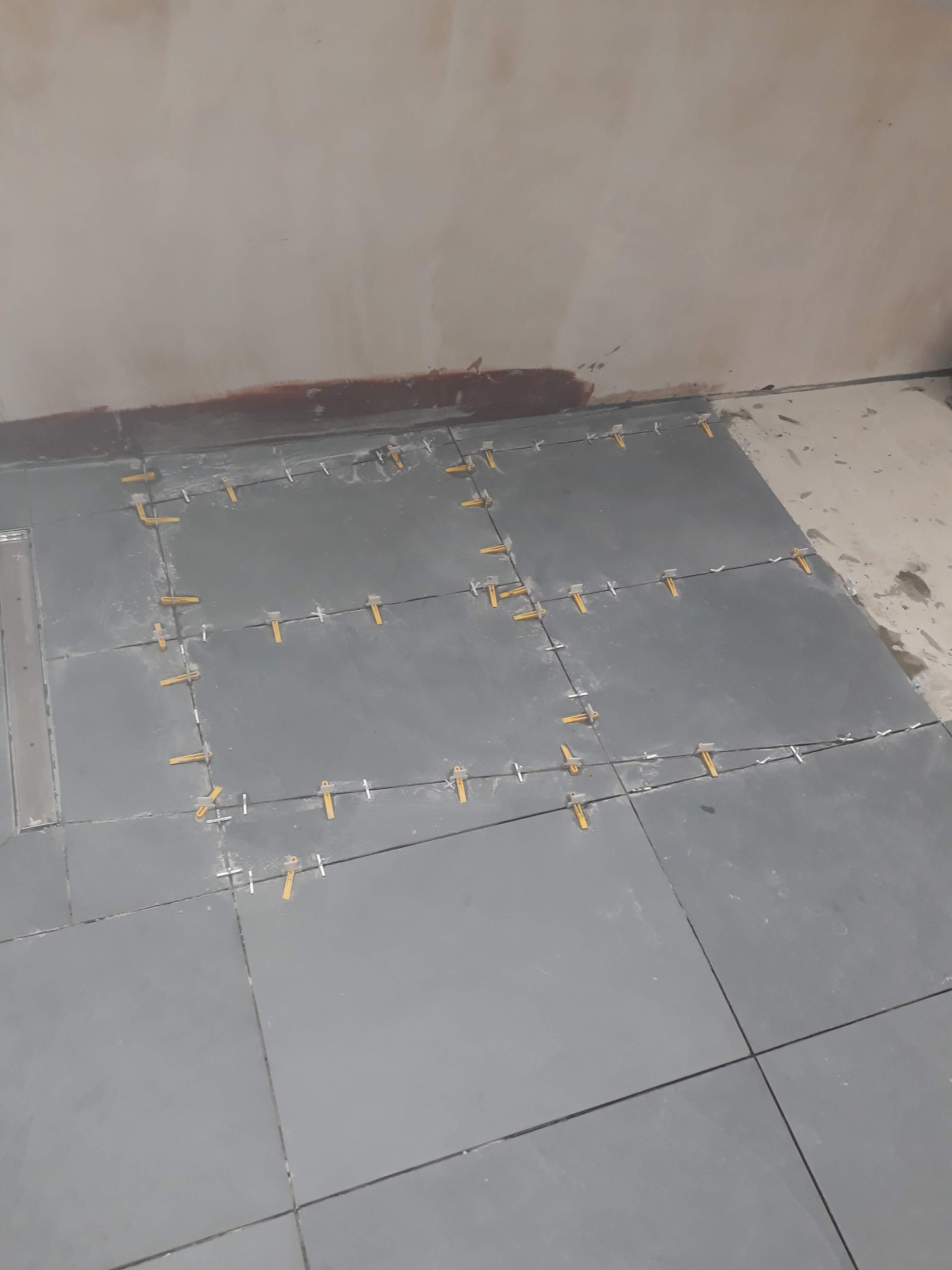

First attempt at a envelope cut into a linear drain
A Piece of glass is correct T , metro white tiles going on the walls in the shower area , appreciate your input guys my thinking is I will finish the floor to bond and re cut into the shower area only tile out of bond will be the centred tiles on the drain which I can live with. Cheers kop
Obviously not to scale and I don't know your tile size (and I didn't take the line out to the edge..) but basically cut tiles down to make a border.
Wayne- as you say, you only have a single misaligned grout joint. As you’re standing looking at the wet Dec in pic 1, does the bottom right tile meet the right hand wall as a full tile?
No bud it's more than a full tile that's why I centred it to save another joint ? what's the best grout to use usually use customer wants a lighter grey. Cheers kop
All good Andy think it will all work out ok can you recommend a good grout for a wetroom floor, usually use bal or mapie ? In light grey need something that's flexible and waterproof cheers w
An epoxy is the only waterproof grout available as far as I know.
Edit: Bal Micromax 2 would be fine though. Not waterproof as such but it doesn’t need to be.
