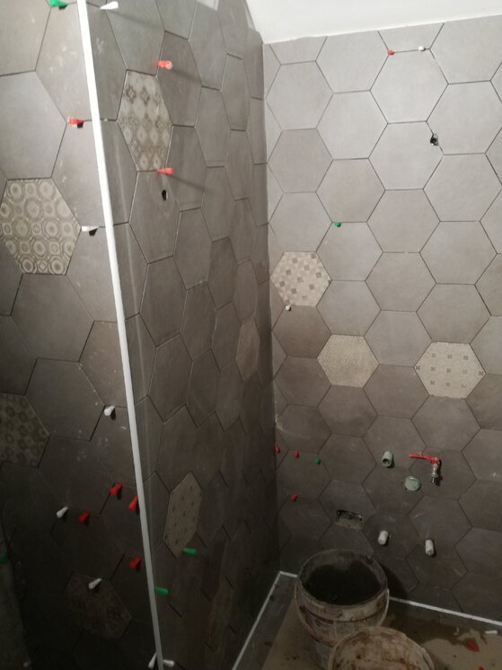

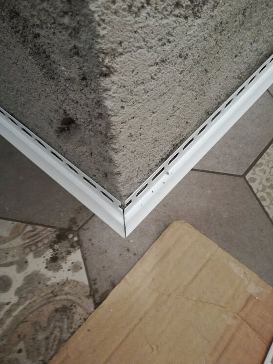

these types?
Impossible to say from the pictures really. If they are corner movement trim for floors then yes. Don't see why they couldn't be used on walls too. Are they the schluter ones?
But from what i can see, you appear to have done the floor first so no that looks like internal plastic trim for doing the insides of windows etc.......
