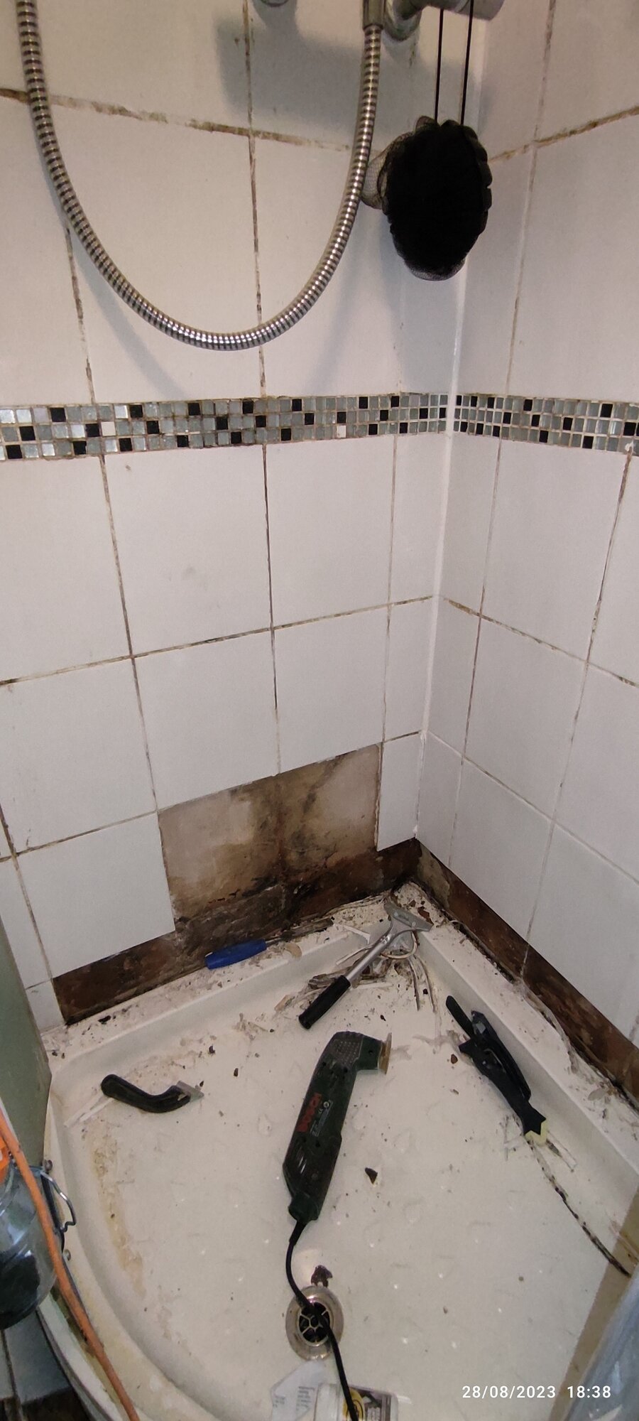

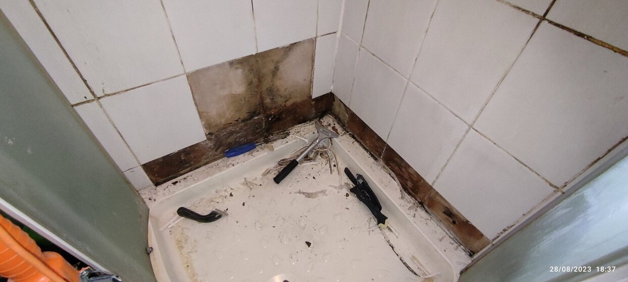

Hello guys ! My Q here is where is the tile adhesive !!!!!!
Or Tile adhesive without the adhesion !!! Anyone seen anything like this before ? ๐Ÿ™‚
Bottom 2 row of tiles could clearly see failed grout causing the leak. Everything solid even wet looking lower section can you believe !
Took out row 2 up as you can see mostly dry but , no adhesive !!!! (Adhesive is on the tile but just flakes off !!!) Grout rock solid !
This was done in the days before waterproof board In Liverpool and the major development of the city means all the good guys are 10Xs "double busy" ๐Ÿ˜‚ So unless you want free accomodation in Sunny liverpool its gona be me alone
Hoping to use Roger bisby no more leaks around shower tray after all dries out and feels solid then seal around the shower valve
but any sensible suggestions on way logical way forward ( apart from full rip out to stud) greeeaaatly apprecated

Yes but solid when dried out so it was plaster that must have had pva in to save it Tanked it with aquaseal and classiseal around the tray Rocketproof ! as you can get atm Thanks for the reply Sherlock ๐Ÿ˜€
