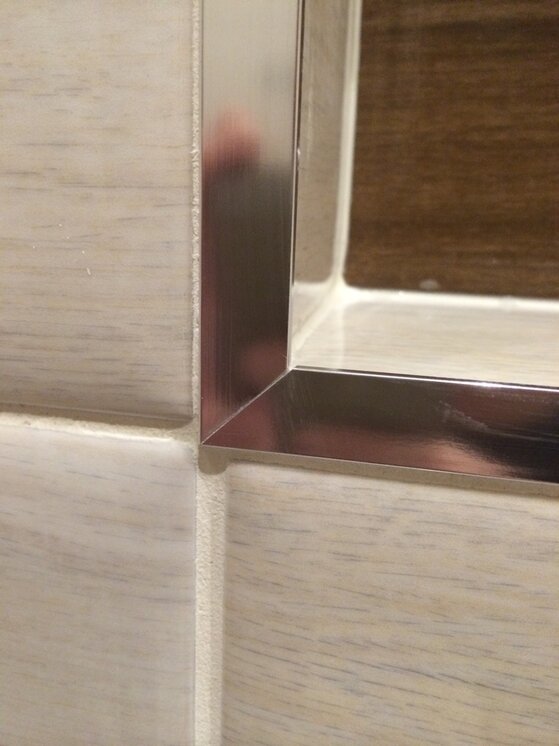

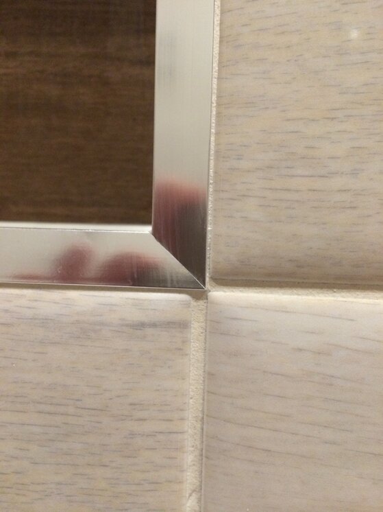

I used to cut them in tiny metal mitre block, but got fed up with it as the 2.4m length trim moved alot using the hacksaw so I ended up making my own mitre block, what do you lads use to make your life easier, like hearing how other tilers do it there way
Looks ok, I might try and invent what I made, it's easy to use and stops the trim from moving and gets ya 45degrees spot on
There you go,
These were done in a blue homelux box..
I'm going to get the one that Deano designed when I'm back in CTD.
I was using my Quansol box today, I keep forgetting I have it..
As above, swap out the blade on the angle grinder for a thin dronco carbon blade and the worlds smallest combination square.
Window trimmed in ten minutes!
