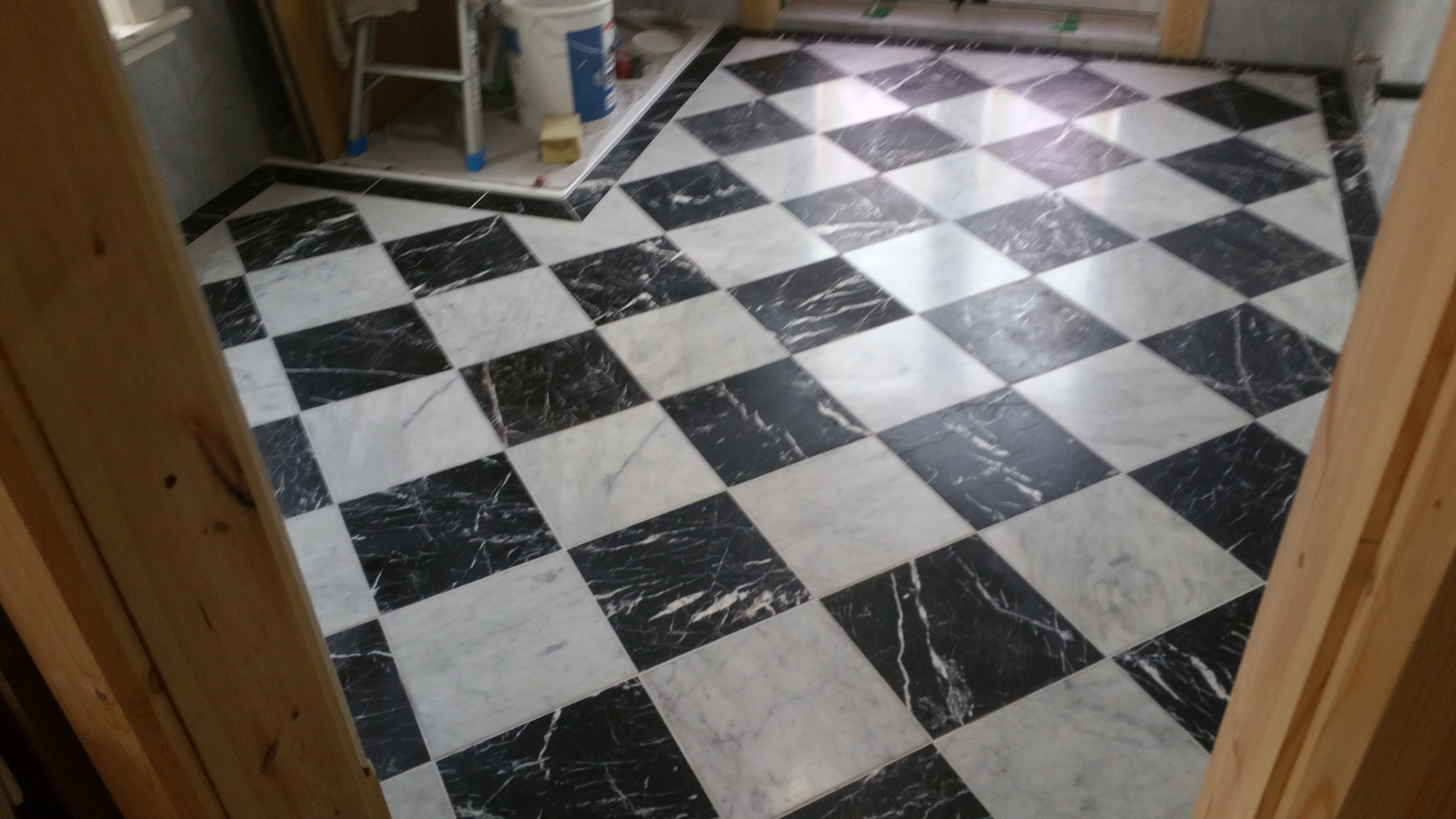

20161112_145648.jpg 20161112_145648.jpg Just grouted this this morning looking good got some boarders to fix round a mirror tomorrow then that's it bar the Silicon
The black was very fragile there was many different textures it was a nightmare many tiles broke soon as u applied and preasure to bed it into the adhesive
The tile was called acid washed something I can't remember
It looks like Carrara and Nero Marquina to me.
Marble etches and stains quite easily. When it's polished it's less pourous but it shows etching and scratching much more.
A honed marble is more pourous than polished naturally but it shows etching and scratching less.
Acid washed is an alternative to honed, effectively an acid has been used to etch the surface of the marble completely to give the effect it's centuries old and worn so it won't show any further etching. The downside is it's very porous and a little uneven. Think "antique" finish.
I have 30mm Honed Carrara kitchen worktops which were stain stopped with Lithofin. They etch and stain slightly but I find that part of the character of having marble so I can live with that.
