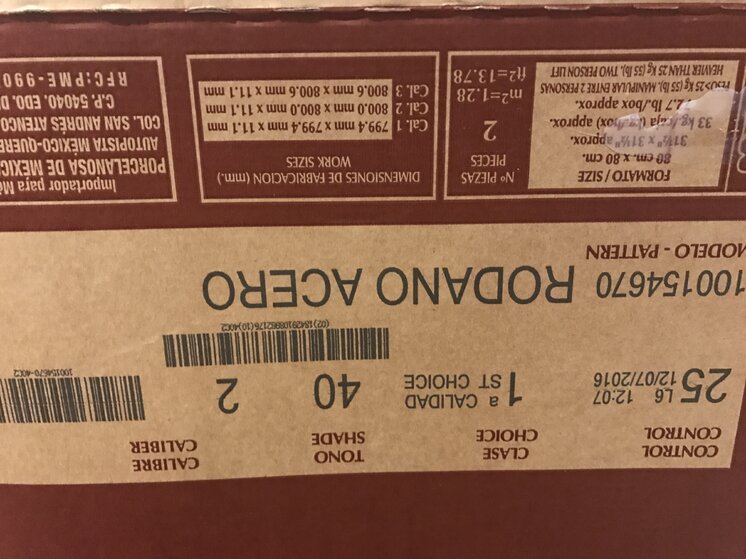

Customer phoned me, has ordered bullnose edges for his floor 800 long
Porcelanosa has told them it's discontinued, they have offered them 4 x900 and a few 330 strips,
They need 9 in total of 800 strips.
I've included a pic of the tiles does anyone know if there is a solution?
is it possible to cut a 900 bullnose without shattering it or cracking it?

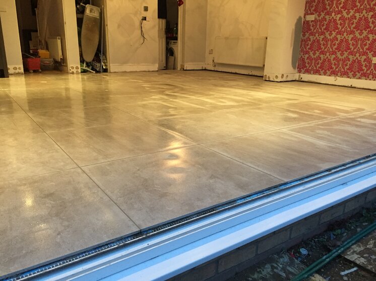

It's for floor edge, so when they open there patio doors it looks nice from outside.
They had me fit the floor tiles then was told they didn't have the bullnose tiles
How much of a bullnose could be made before the biscuit shows?

The bull nose must be possible if the factory have bull noses available but not just in you required size. The glazed finish won't turn over the edge on the factory edge either.
I didn't realise they were biscuit, but at 800x800 I would have thought they would have been glazed porcelain at the very least?
Ive never seen a tile that size being biscuit 😵
Sorry buddy I didn't mean biscuit meant underside of porc tile wouldn't match colour wise??
