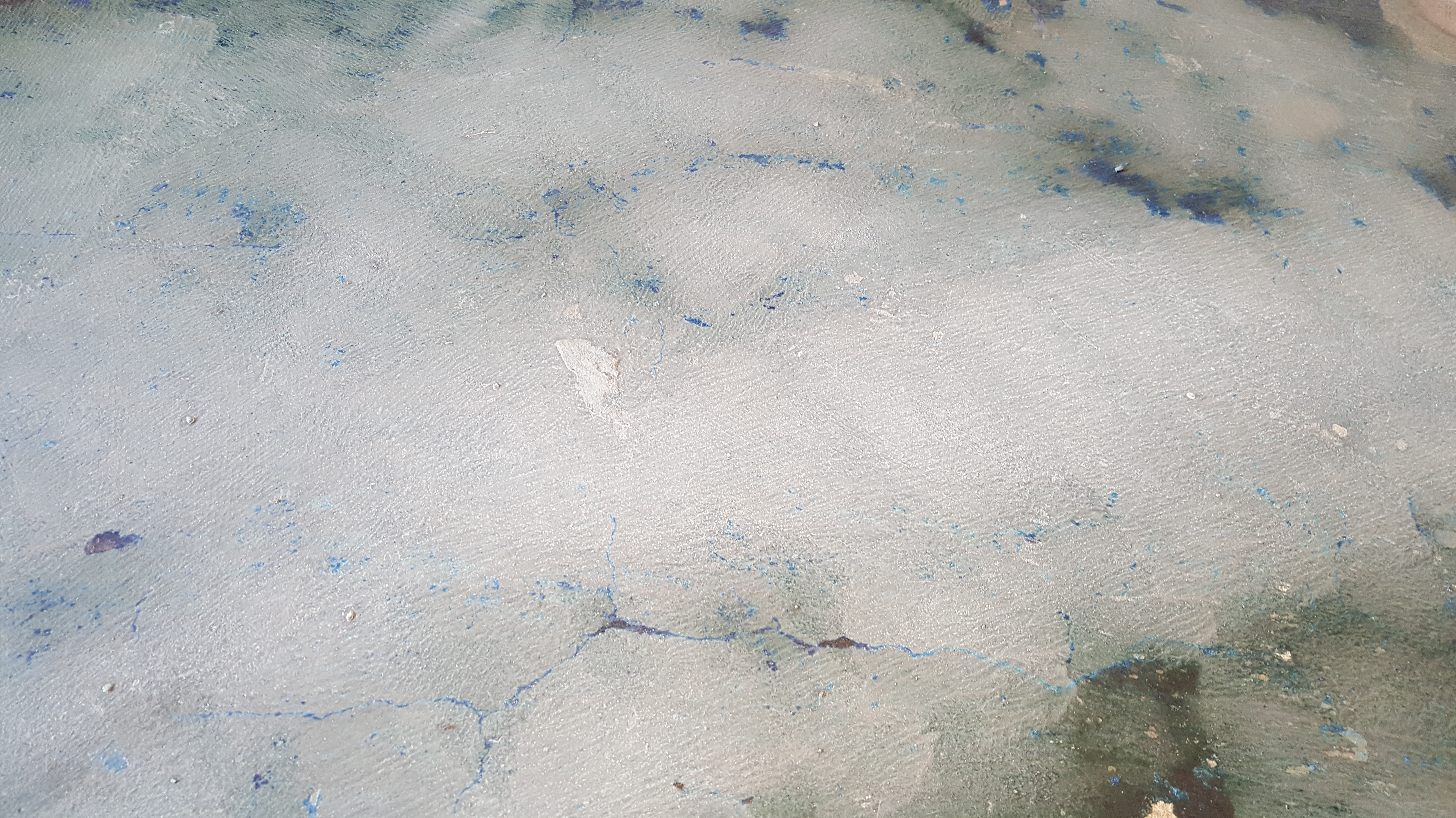

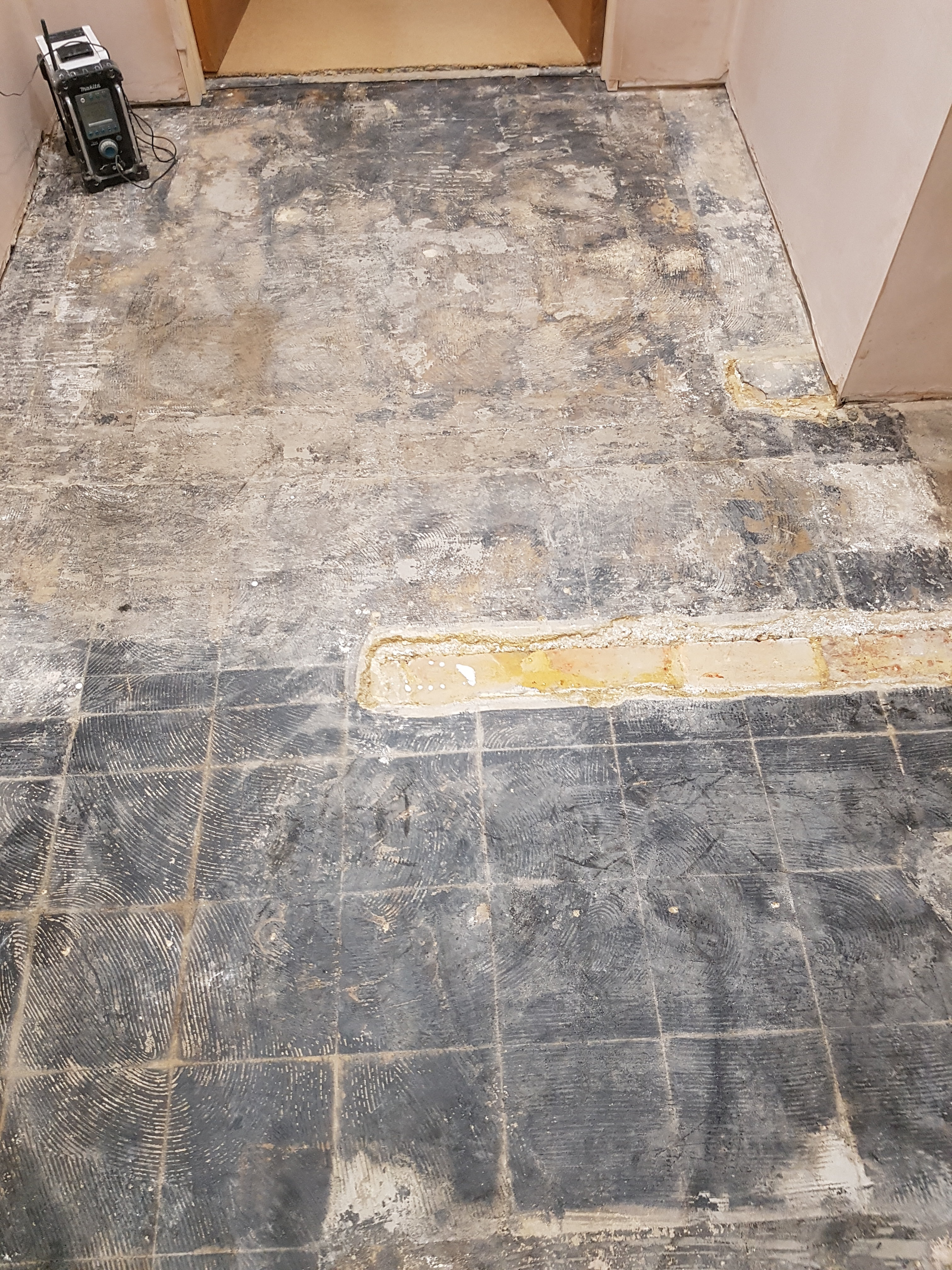

There is black (looks like some kind of waterproofing) paint on a concrete kitchen floor. Ive primed it and its taking ages to dry. Any ideas what it is? I want to slc over it.
Its giving off some lovely blues and greens.......very strange.
Most likely some old bitumen glue type stuff used to stick down old vinyl tiles. Best option is to prime it with prime plus grip, or make a slurry coat up. Normal primer isn't the way.
Q
Qwerty
Scrape off the worst lumps of the bitumen if any and then slurry coat it.

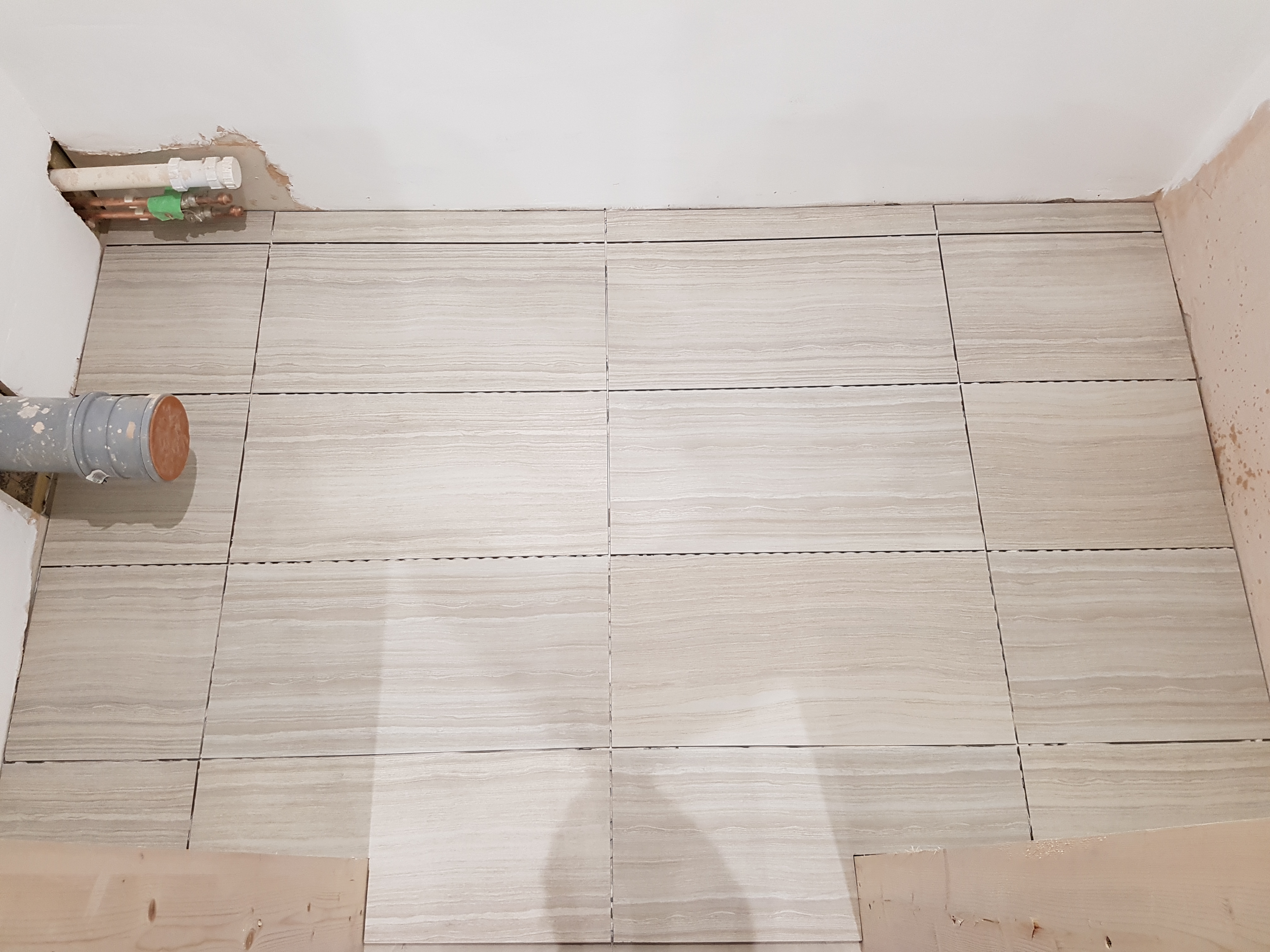

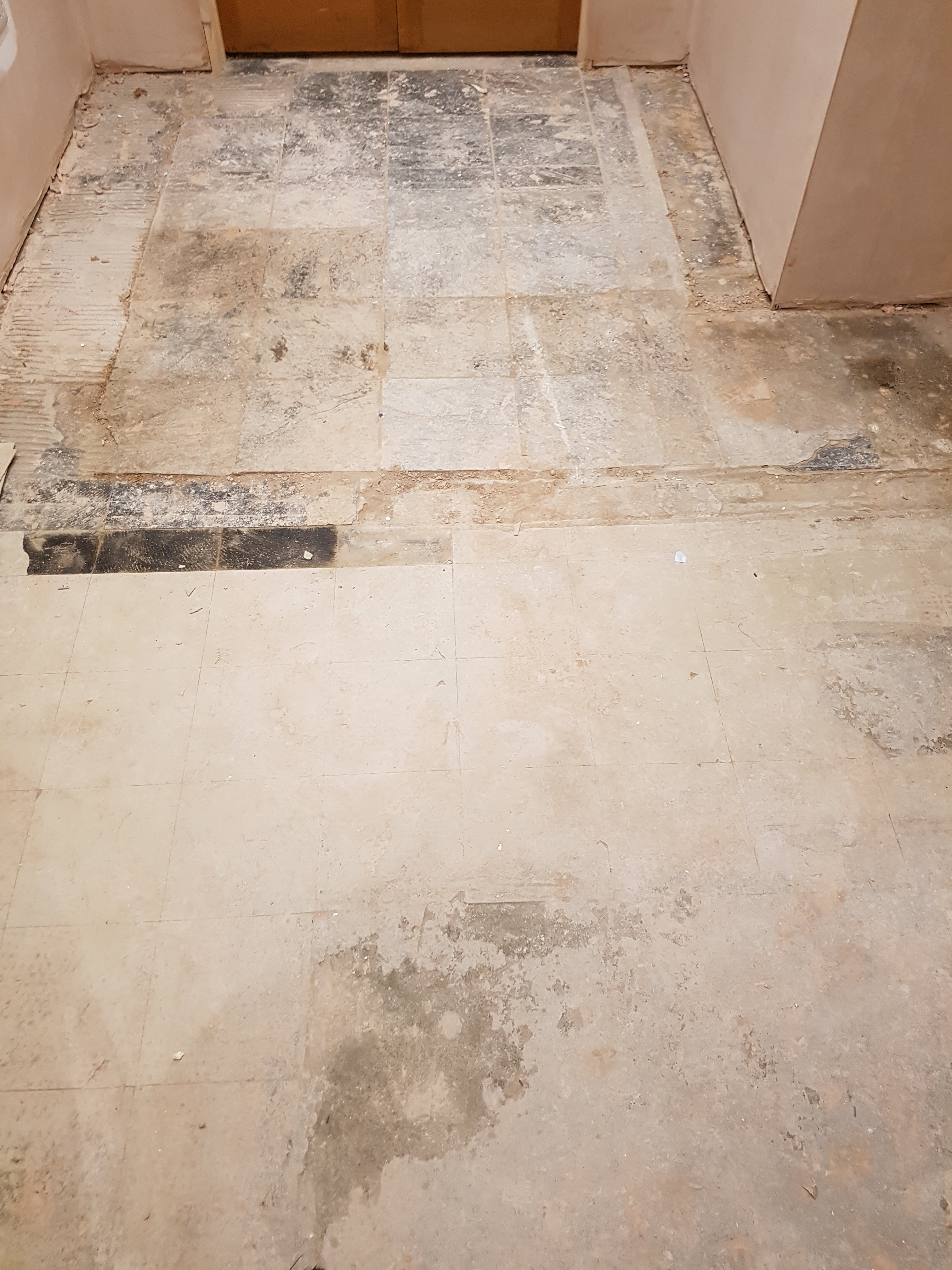

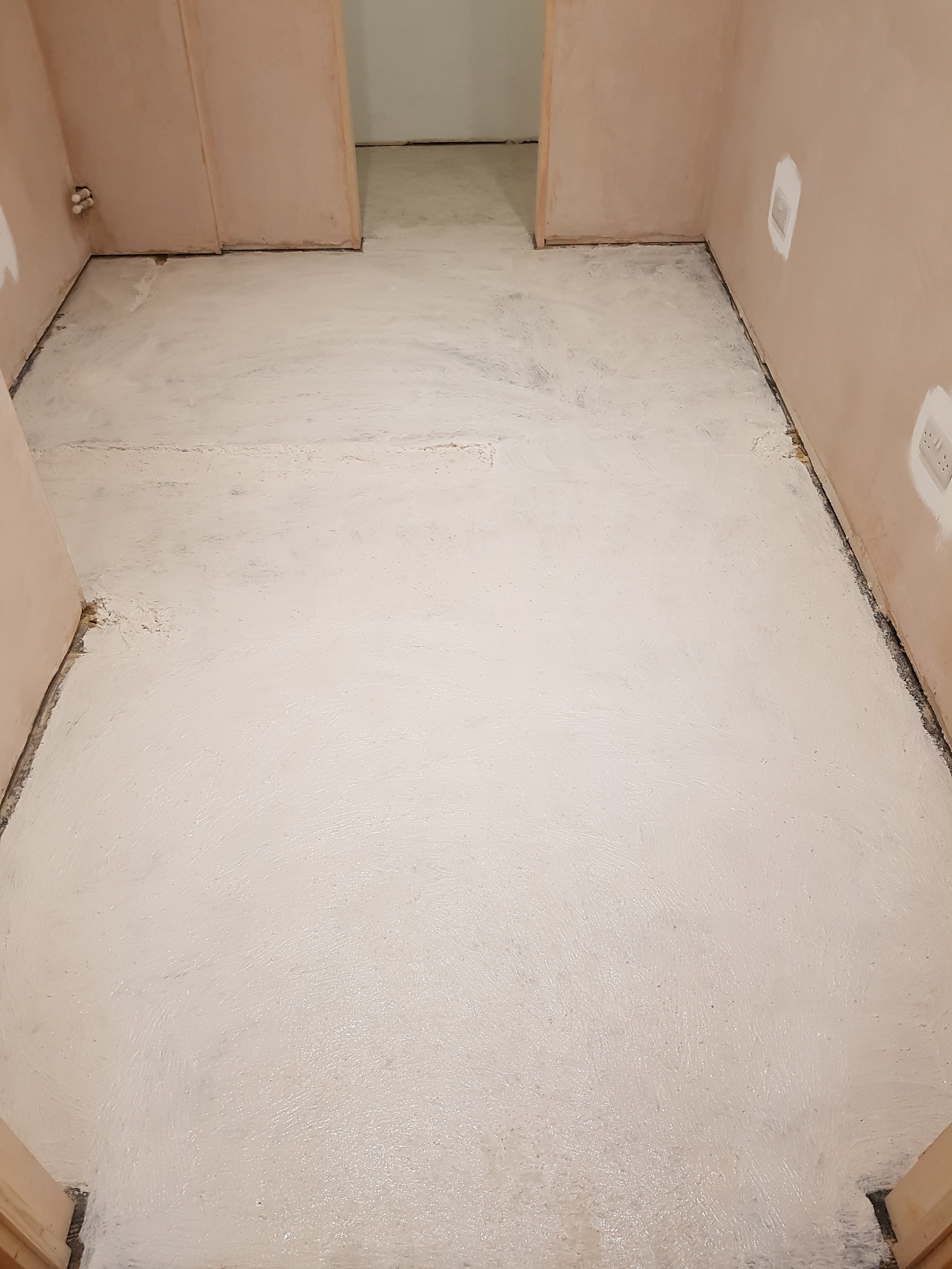

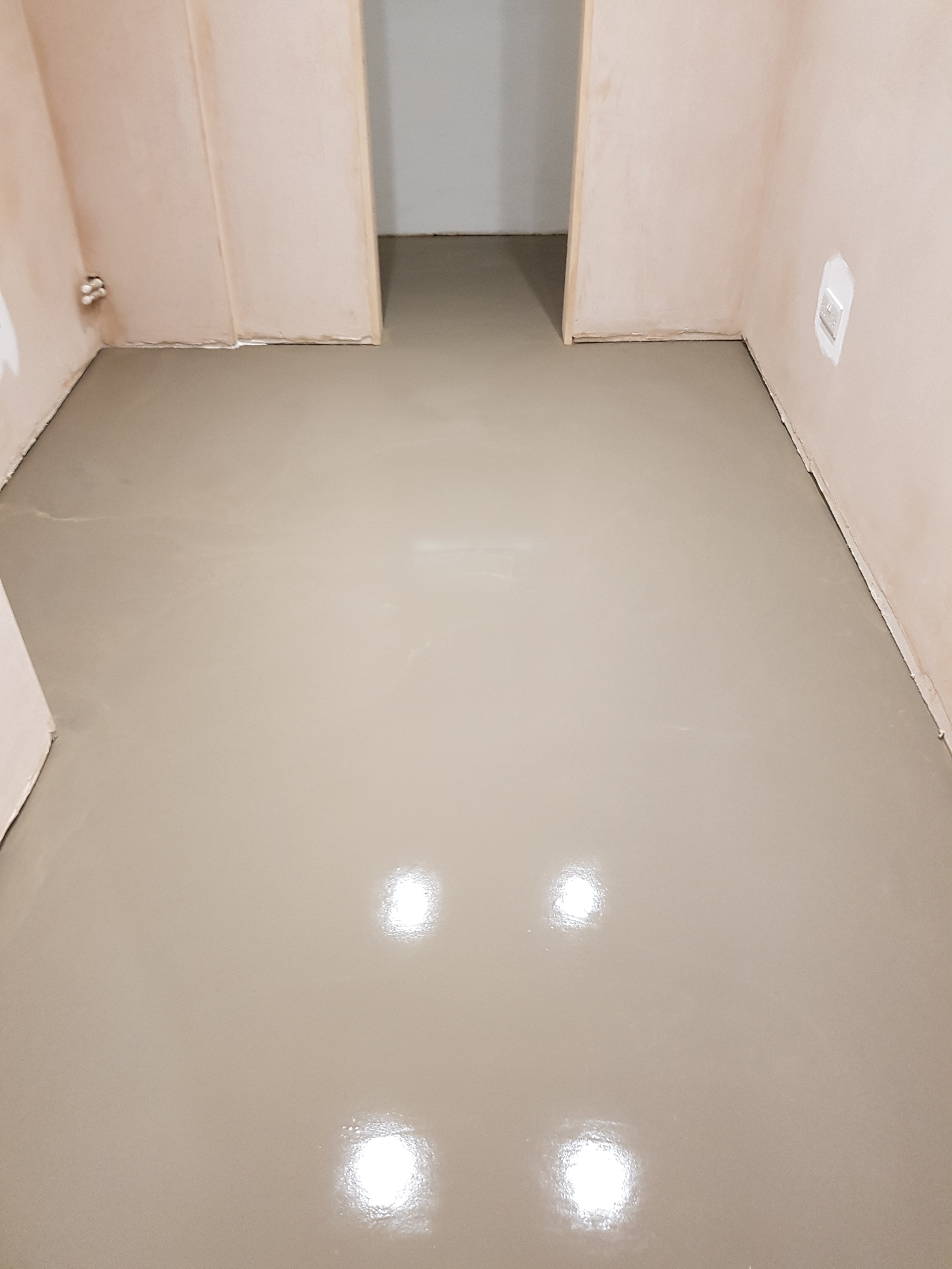

Here's one I did at the start of this week....
Remove, scrape, sweep, slurry, level, prime, tile (with great difficulty.... B&Q sizey rubbish tiles), grout, paid. Boom!
Interesting, I use the pre mixed stuff just stir it up and roll it on, dries like 80grit sand paper. Similar when I've mixed my own, what's your mix? Did it take forever to dry
Sean Kelly
647

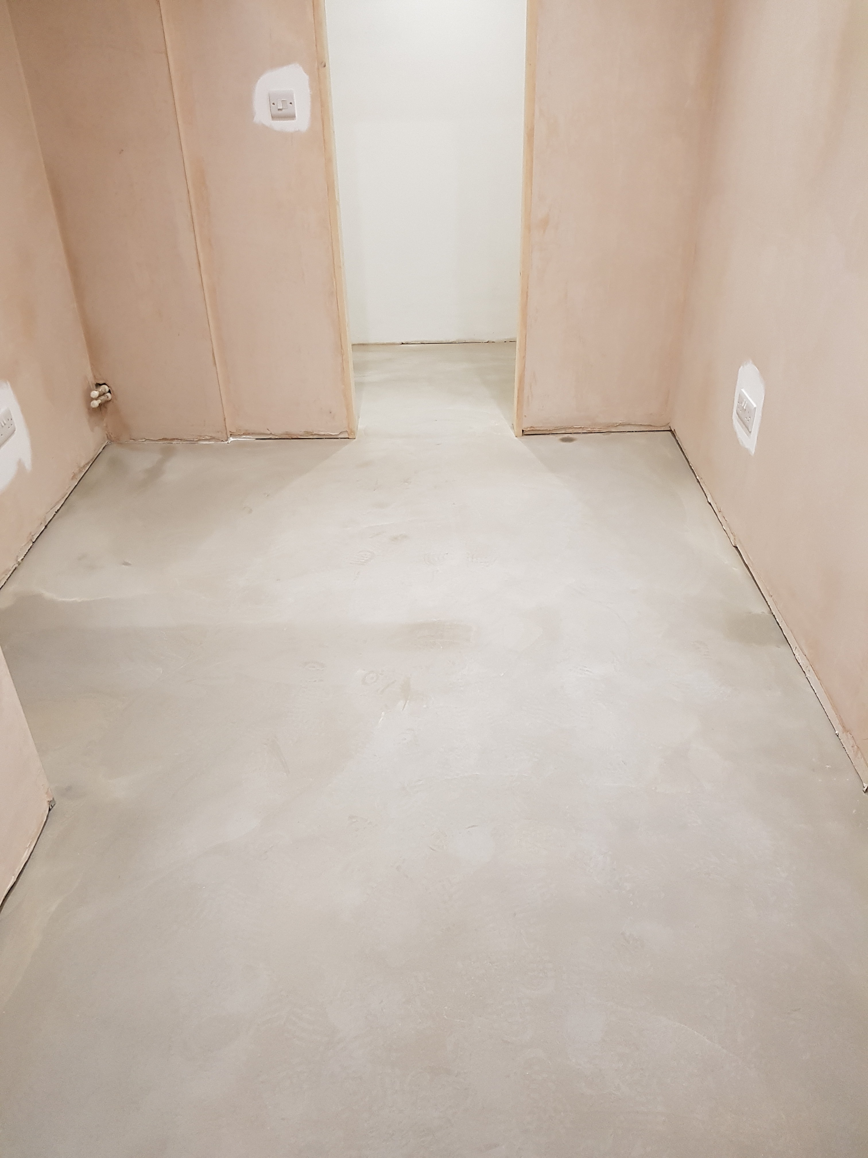

Cheers Lads. I've come across a bitumen floor b4. It was a sticky residue on the concrete. This one today was like a paint but i could not scrape it off.
As i said i primed it.......It only took 1.5 hours to dry!
I went over it with BAL level max. As it said no need to prime i thought i would prime anyway.
Q
Qwerty
No, it dries in a few hours. SBR & water mixed 1:2 with rapid set addy. It should really be 1:1 but the extra water makes it easier to roll on with a 4" roller
