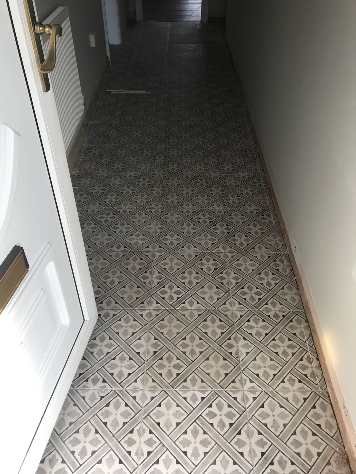

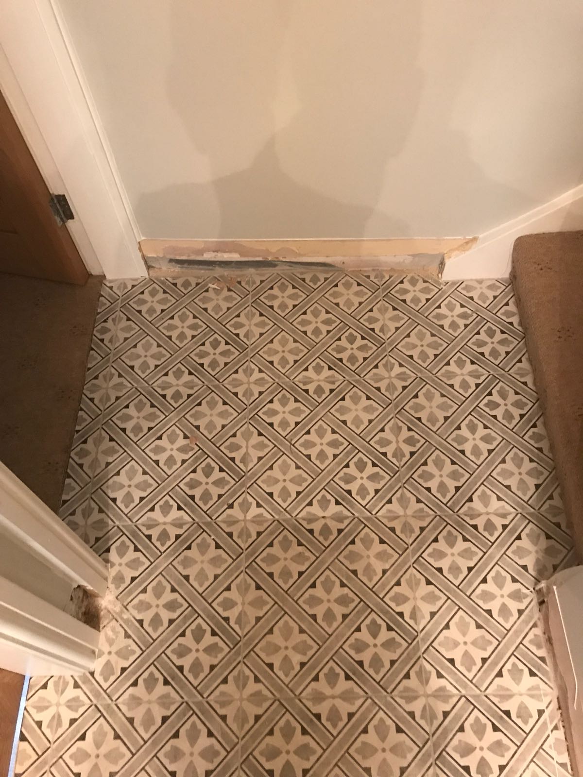

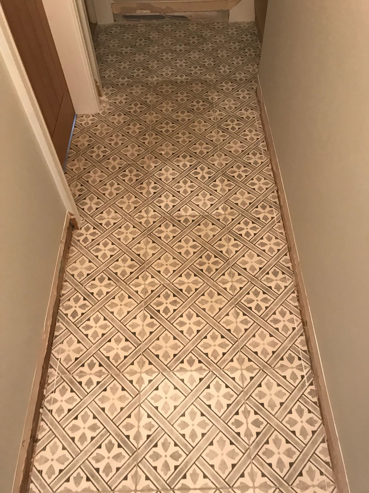

Bct, Laura Ashley, Mr Jones floor tiles discoloured after a few weeks
Laura Ashley Tile Mr Jones
From British ceramic tiles
2nd fix off the same tile same issue not glazed discoloured one of their reps admitted that there has been a misfiring issue with the kiln shocking that they are still selling then

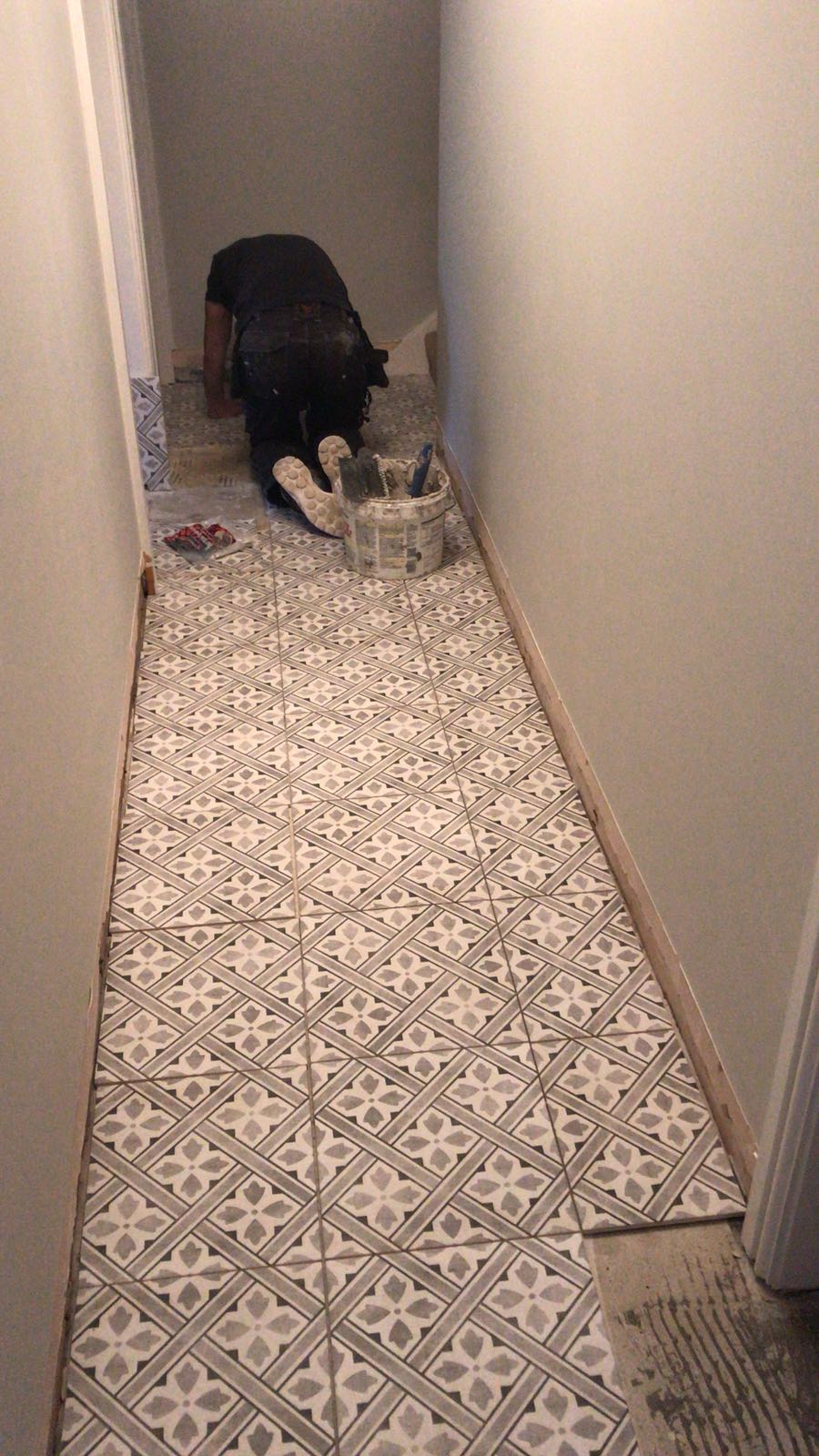

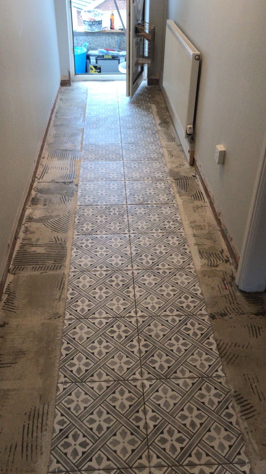

They were sold as floor tiles and advertised as floor tiles, they were fine when they went down, but in the daylight you could see a difference in the sheen coming off the tile, the ones with an almost matt finish or no glazed discoloured and looked horrendous in a matter of weeks

Some of the pictures you can see there is a different glazes in the natural on some tiles then there are pictures of the tile after a month completely discoloured it happened twice to us six month apart all the same batch
