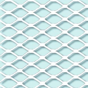

I did not see. which was plaster.
use primer. no mortar. use type (Planitop Mapei / keralevel kerakoll).
secured engagement. as it says bricklayer is also ok. make some hole. not hurt. you could fix. also a steel mains. thin. prior to shaving.
E3131_104089_00.jpg :thumbsup:
