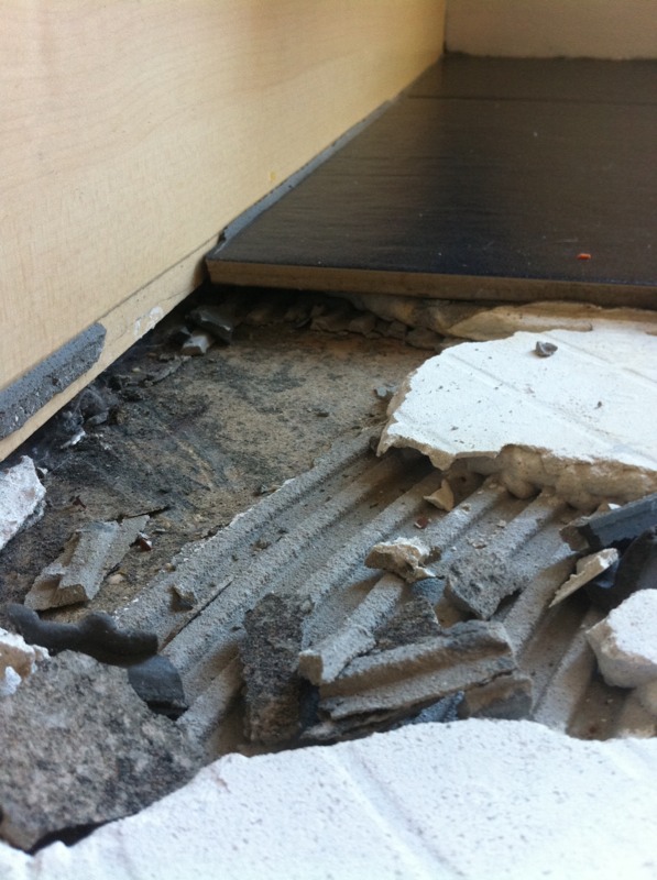

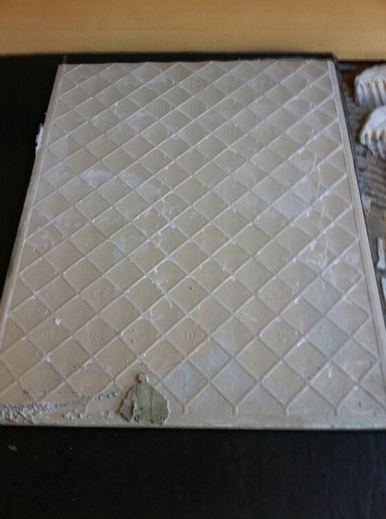

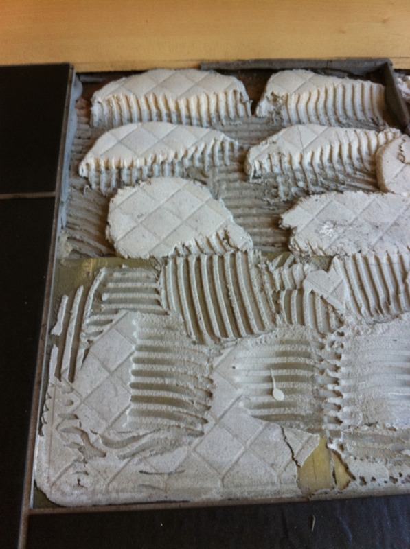

Went to investigate cracked grout and tiles moving the other day and this is what I found!!!
Discuss Another rogue. in the America Tile Forum area at TilersForums.com.
How big is the gap under the tile...nice work:yikes::yikes:
we seem to be seeing more and more of this lately......its a joke, chancers trying to make a quick buck due to lack of work, while the pros pick up the pieces..
it's not a diy sos job is it Dougie?
for who ?This guy is an approved fitter for .... you guessed it!!!
