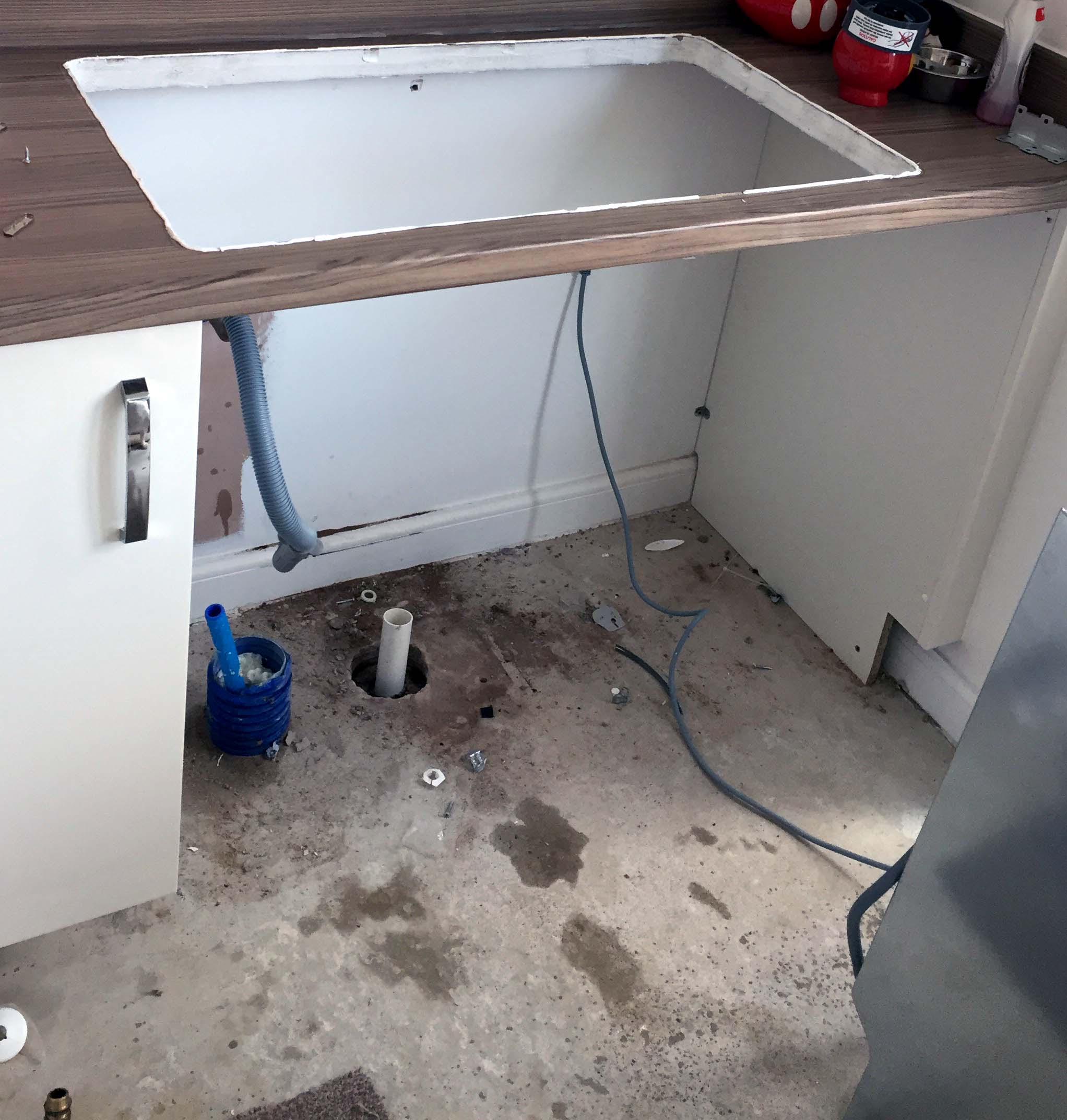

I have a feeling that all Barratt homes are Sand/Cement screed, (based on recent local plots) but would double check with them just in case . Failing that, if you can take a picture and post it up here, we may be able to ID it for you. It wouldn't be wise for us to advise a solution until you know what you're dealing with.
Andy Allen
18,311
If its a new build on a housing site i can almost guarantee its a sand and cement floor, give it a good scrape to remove any debris, prime with an acrylic Primer and tile away..
BTW. .....They sometimes level the floors with SLC which can look like a anhydrite screed .

Thanks chaps for the quick reply,pictures attached I will get my daughter to ask the site people as it is a big build that will be going of for years. I will have a look and a poke but I have a picture taken when they let us in at pre plaster stage to see where all the pipe and cables were and it looks a bit light grey like the photos of Anhydrite I have seen. But another one taken the other day when they had to rip out and replace a cupboard looks like sand and cement.

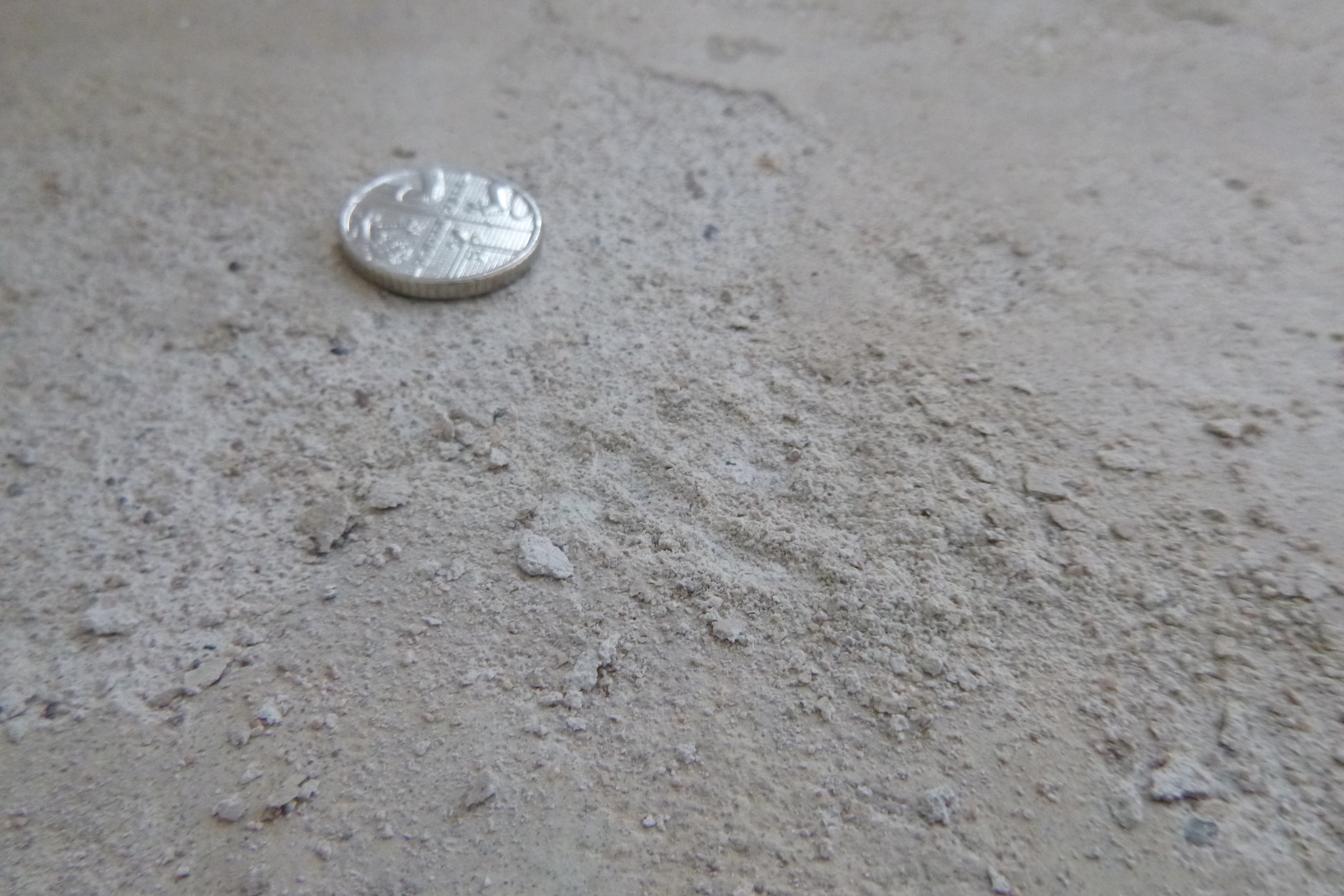

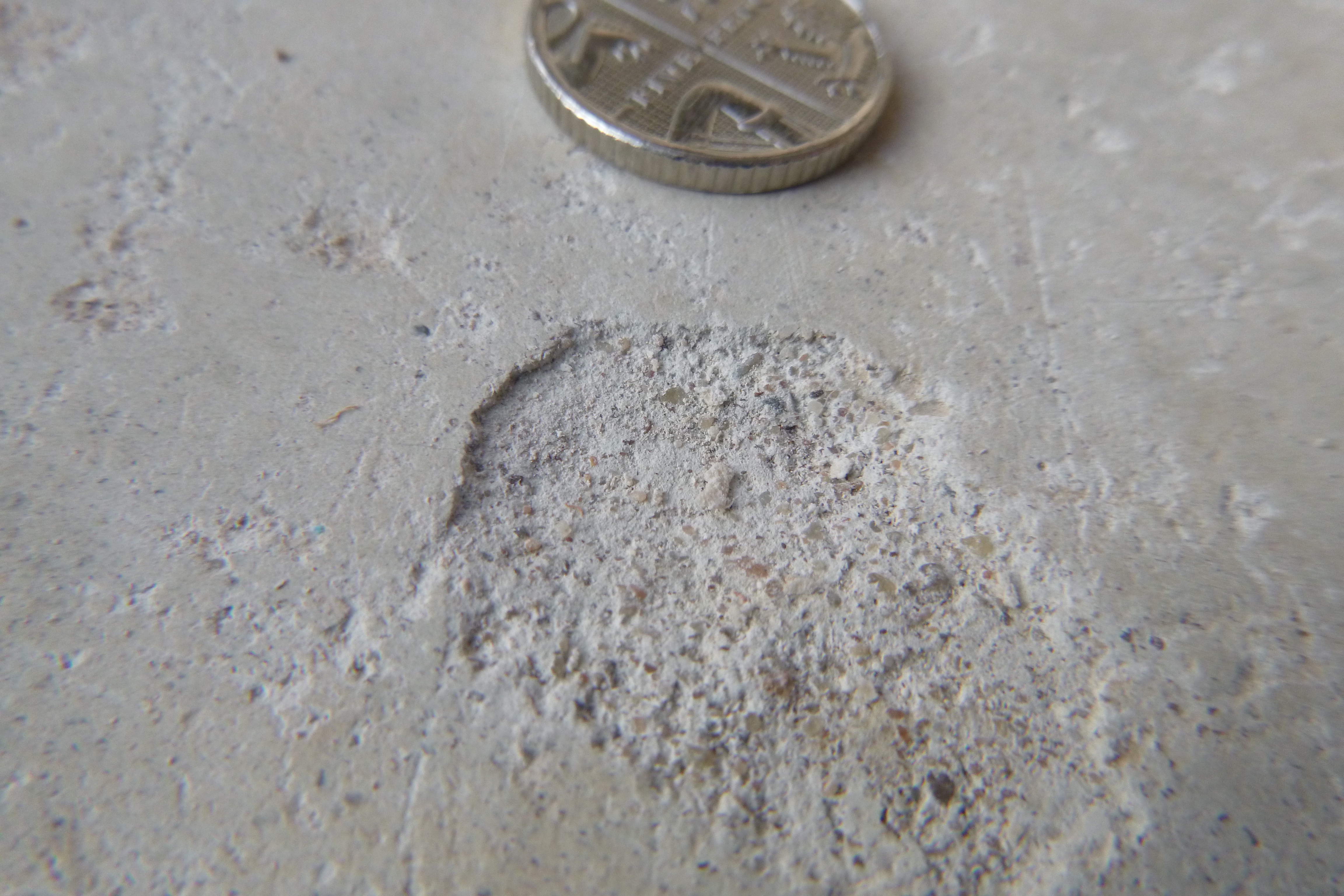

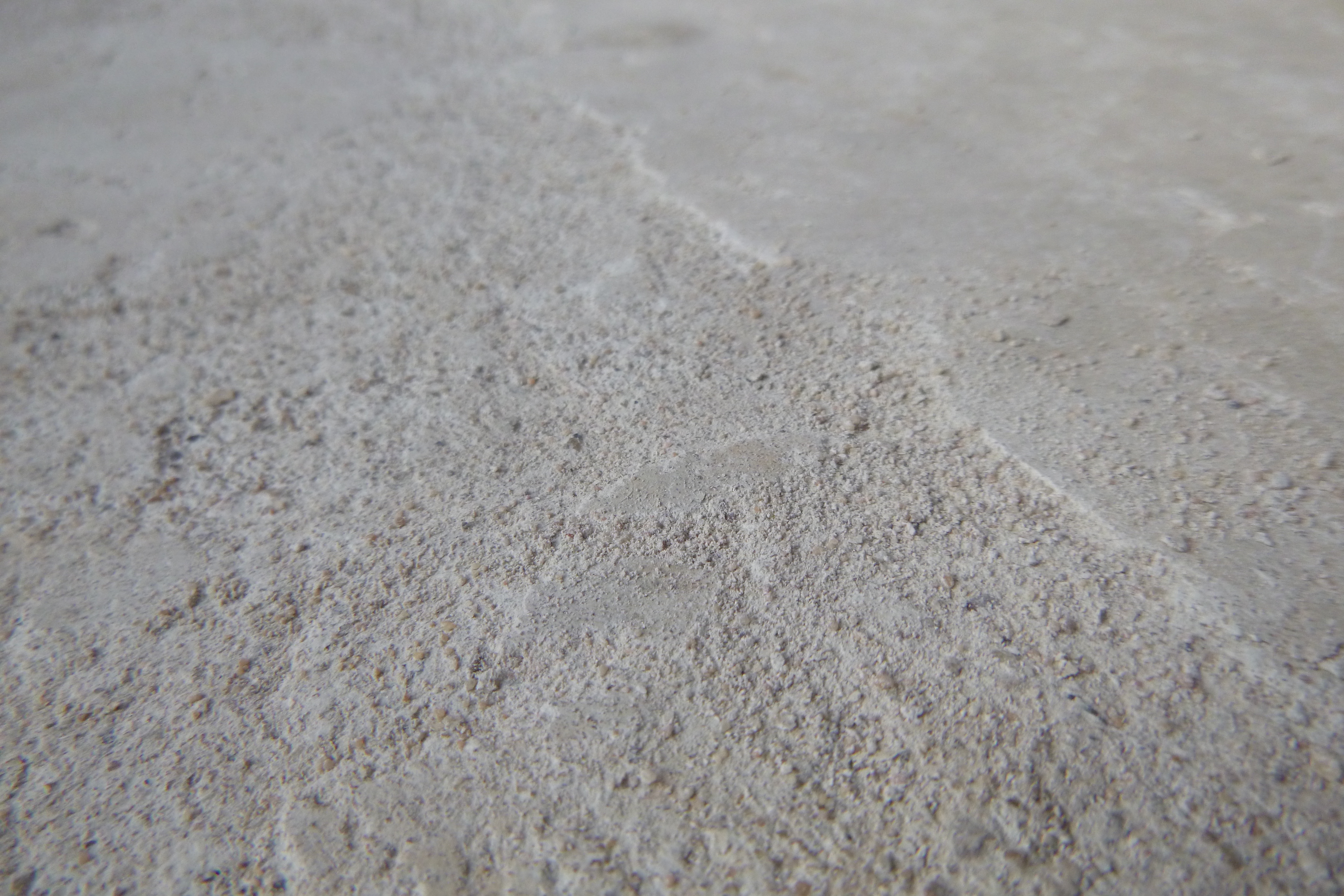

been over today and spoke to a site manager who said that the floor is concrete and then its floated to give a smooth surface. On closer inspection I can see that some of the top smoothed layer has come off leaving a harder screed looking surface.Some areas are compleatly free of any top surface. Some of the smoothed areas are quite hard and others are easily scrapped off. Is there anything wrong with this approach.
Sand off the areas that are weak and leave the rest.
Seal with two coats of Prime Plus | Flexible Primer & Bonding Agent | Tilemaster Adhesives - http://www.tilemasteradhesives.co.uk/preparation-products/primeplus-flexible-primer-and-bonding-agent
And then use Standard Set Extrabond | Standard Setting, Polymer Modified, Wall and Floor Tile Adhesive - http://www.tilemasteradhesives.co.uk/adhesives/standard-set-extrabond-tile-adhesive
Its a kitchen and the tiles are ceramic 60x30.

Just Rizzle
looks like a screed layence has settled on surface like anhydrite i would sand off as this is loose and will not secure the adhesive or slr and must be removed before tiling
