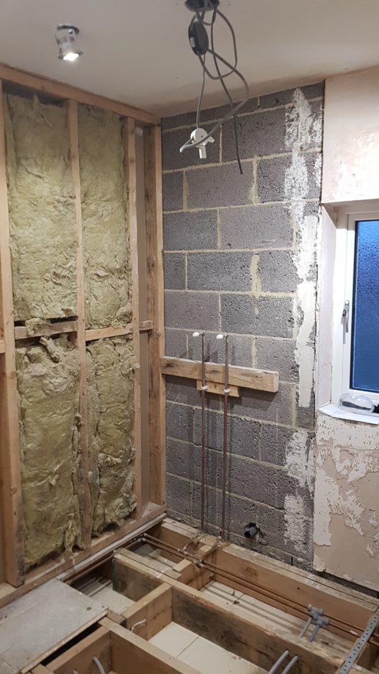

I would very much appreciate the advice of anyone who has fitted Marmox boards as I have decided to use these in the shower area of my bathroom refurbishment. First, a couple of photos to show the extent of the area to be boarded:
Ignore the pipes on the breeze block wall. These were used for the old shower, as was the waste pipe. The pipes and wood supporting them will be removed. The copper pipe in the floor will need to be re-routed as it runs exactly where the shower waste will sit - typical!
Having performed lots of research and taking advice from the tiler who quoted for tiling the bathroom, I have decided to use Marmox boards to board out this area. I plan to use 5 sheets of 1250 x 600 x 12.5 boards for the stud partition wall and use metal washers and zinc coated screws to fit them.
The breeze block wall is a little more difficult, in that the boards will be butting up against the existing plasterboard and this varies from 22mm to 27mm off the wall (front of skimmed plasterboard to wall surface). The existing plasterboard is 12mm thick, so it is the dabs that cause this variance. I plan to use 4 sheets of 1250 x 600 x 20mm boards and use the dab and dowel technique to fix them i.e. drill the board in 5 places (each corner and centre) then dab adhesive on the back over the drill holes and press to wall. I will use the thickness of the dabs to match the existing plasterboard levels. When dry use 60mm dowels to mechanically fix after drilling through existing holes. I plan to place each board horizontally; one on top of the other, so each board will be cut at around 1000mm.

Having used the Plumbers Forums, this is the first time I have posted on Tilers Forums and I confess I'm disappointed at the lack of help I've received, so I'll update this post myself now that I have made some progress.
My questions were:
1. Should I use 60mm dowels or 90mm dowels?
I will be using 60mm dowels.
2. Any advice on adhesive to use? I believe it has to be cement based flexible adhesive (C2)?
I purchased some Ultra Tile Fix Pro Flex SP flex Rapid Set Wall & Floor Adhesive S1 in grey as this was recommended by the company I purchased the Marmox boards from.
3. While Marmox sell 10 metre rolls of self adhesive, waterproof tape, it seems to be VERY expensive (around £41 per roll and I need two!). Is there any reason why I couldn't use liberally applied DOW silicon in the joints between boards instead of the tape?
Having spoken to Marmox they explained that the silicon may shrink so wouldn't be as waterproof as the tape. Rather than purchasing the expensive Marmox brand I purchased a 20m trade roll of Aquafix Self adhesive waterproof tape. This is also a butyl type tape and costs half the price of the Marmox brand and appears to look the same (from images).
4. What would you recommend for waterproofing between wall and top of shower tray? I was thinking the Marmox waterproof tape could be used, but again, this seems expensive for what it is!
I have sufficient tape to use this to waterproof the shower tray to wall joint as well as all the multiboard joints.
5. How should I transition between the Marmox board and existing plasterboard? On the stud wall, the board will be fitted to the very left hand edge of the wall, resulting in an external corner. Does this need to be protected or taped in any way. The right hand side of the breeze block wall is not as bad, but there will still be a external edge along the window reveal.
Still not sure how I'll do this, but I have a choice between using the DOW silicon and/or the waterproof tape. I'll see how it goes and then check with the tiler before he starts.
Again, thanks for the feedback. NOT!
