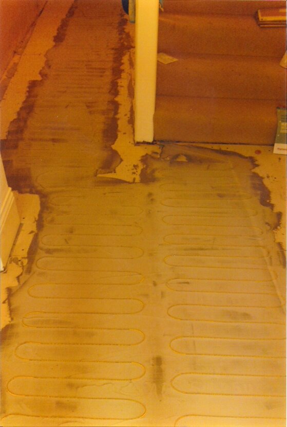

Step 1 - Fix floorboards - fix Hardie Tile backer boards - lay Underfloor Heating.

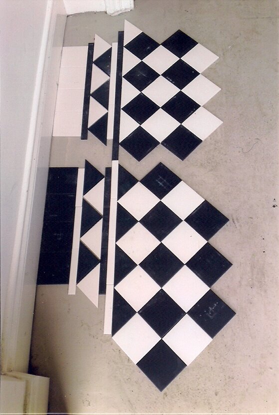

Step 2 - Lay out alternate design for customer choice.
Step 3 - set out and lay customers own tiles to agreed design
The setting out took over 4 hours with many lines of attack but the difficulty was in having no parallel walls ( being built in a crescent shape the hallway is 600mm wider to the staircase than the front door) However as the customer had many photos /designs of patterns running under the staircase this has helped the eye flow with the tiles IMO.

Gary - Its been a real pleasure to do - the customer is in design and has set ideas on what he would like it to look like - but in discussions he's been open to suggestions (ie I've got my own way so far!):thumbsup:
CJ - the joints are 2mm pegged, fixed with Webber grey fast set flexible over Mapei fibreplan SLC over Thermonet UFH over Harie tile backer boards over T&G boards/chipboard flooring. Grout is Ardurit C2 grey!
The setting out - I took a line through the middle of the Entrance Vestibule (still to show in photos) - through the middle of the top hall area - through the middle of the lower hall area (near the staircase) - stepped it over 300mm so the line went from the front door right through to the back kitchen door. A laser line ensured it was straight.
With a bit of tweaking the area towards the rear kitchen area became straight with the wall and then it was just a case of making sure the half black triangle came up against the white strips on all straight edges.
