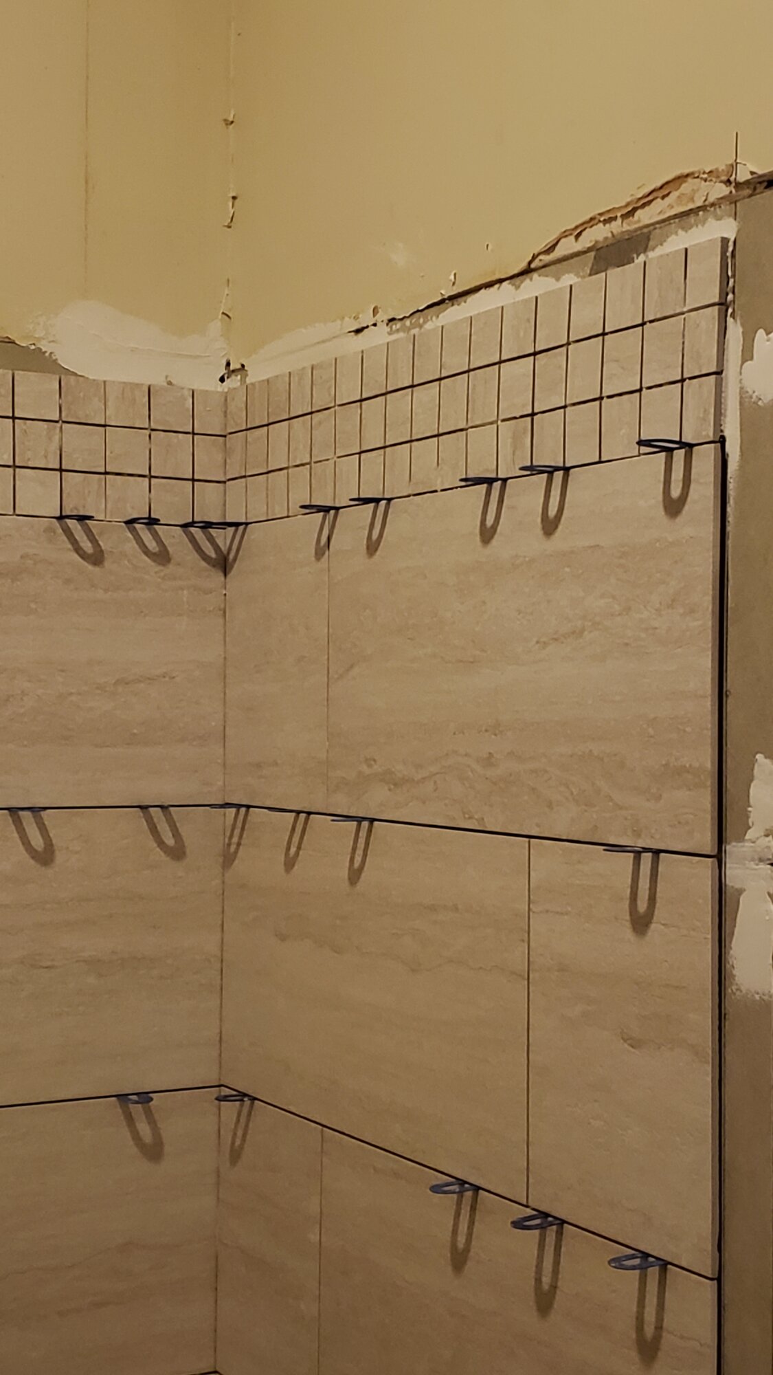

Good Evening Folks.
I'm going to post a few pictures & would like to hear some feedback from tried & true industry pros. I have tried to point out the issues that are staring me directly in the face, but the other two parties involved are denying they exist, can't reconize them & are feverently insisting "grouting" will make it all go away, while im insisting all work must stop until this is addressed. It's one of those situations where your being told "don't believe your lying eyes", "no no, that didn't just happen", "nothing to see here, move along folks".
If what I'm pointing out is "Normal" like the GC & Tile Setter suggests, then please let me know as this is causing conflict between me & the customer; whos lack of understanding, I believe is being completely taken advantage of.
Please advise on what you see wrong.
Please advise on whats passable.
Please advise on what the ultimate solution would have to be.
Please forgive if there are a couple duplicates as I'm doing this on the fly & didn't realize they continued on today installing more time, thus making the possible border issues harder to address. Was that on purpose, idk..
Apparently, my concerns weren't taken seriously & the GC convinced the party to continue. Following pictures are from work done today.

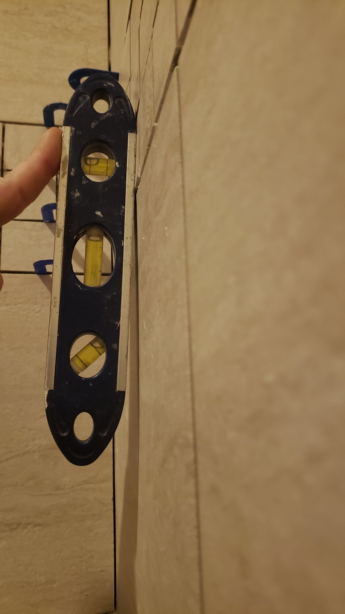

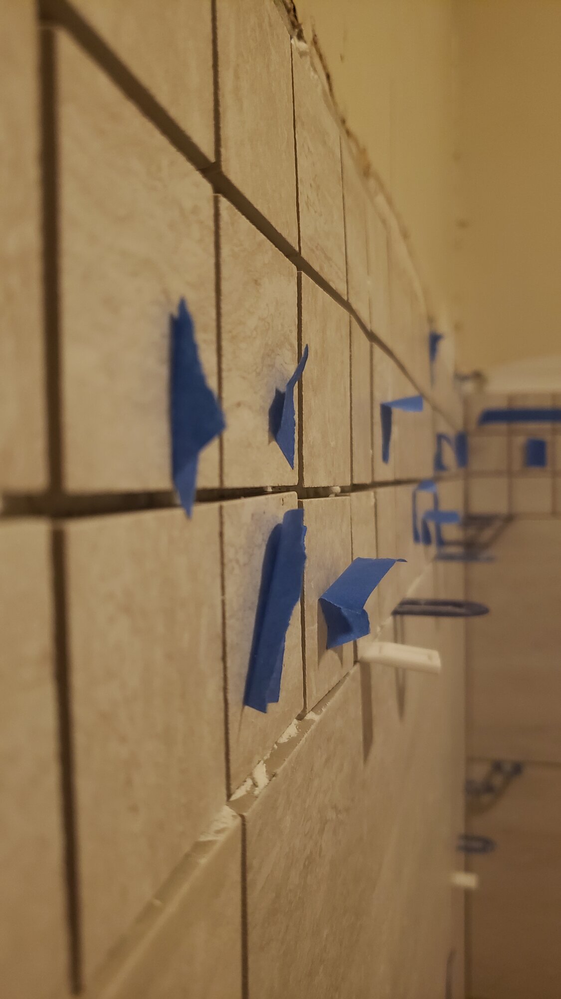

I could repeat this picture of the level all over the Border of this job. In other words there are many many many, (countless actually) areas which read the same. If this is normal, then fine, but I believe it's the root of all problems here.

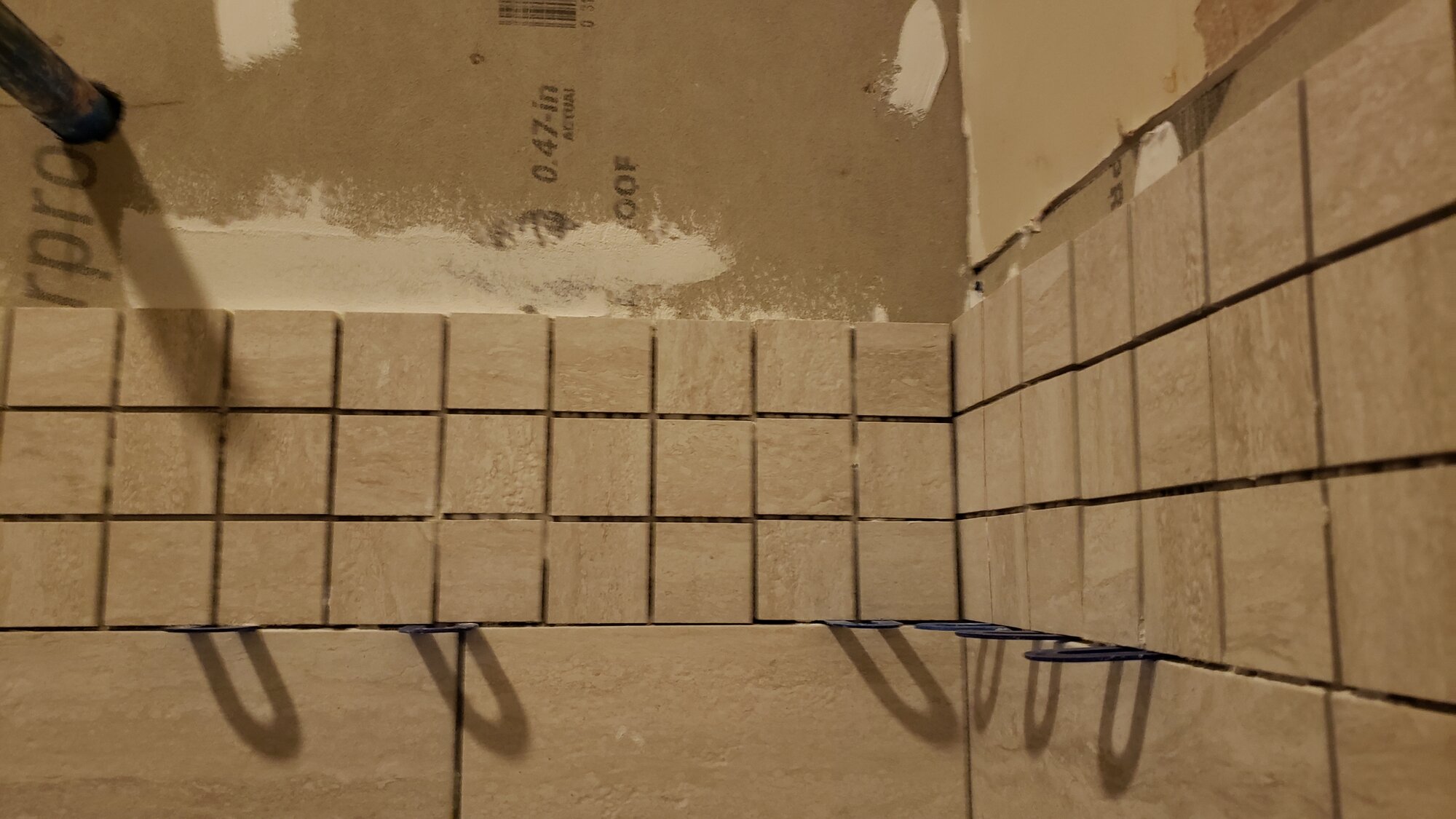

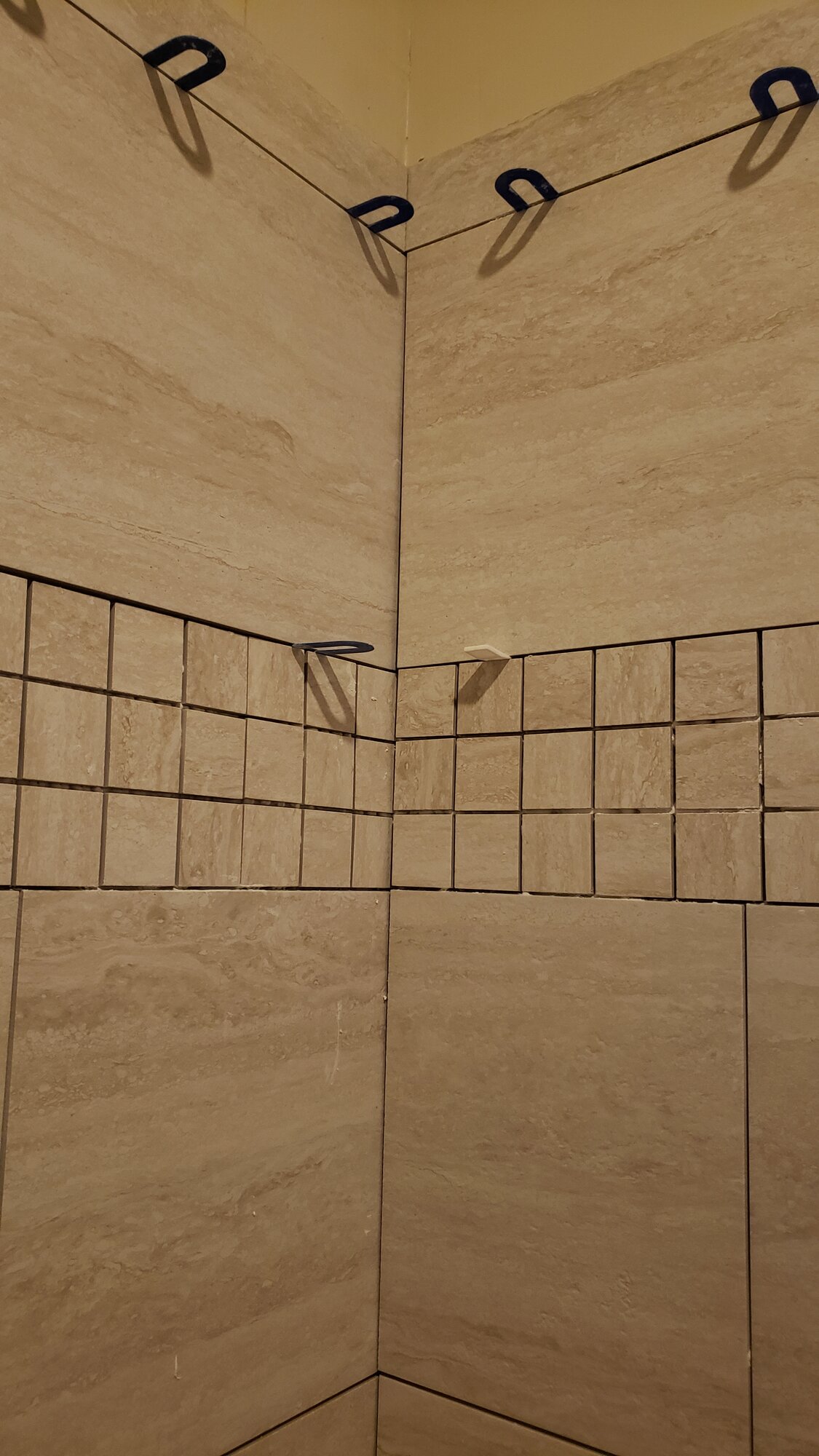

Apparently this corner below was supposedly reset today along with a few other areas. I heard the work happen, yet it all still looks the same to me, nothing matches up, gaps are buggered, tiles still crooked or bulging.

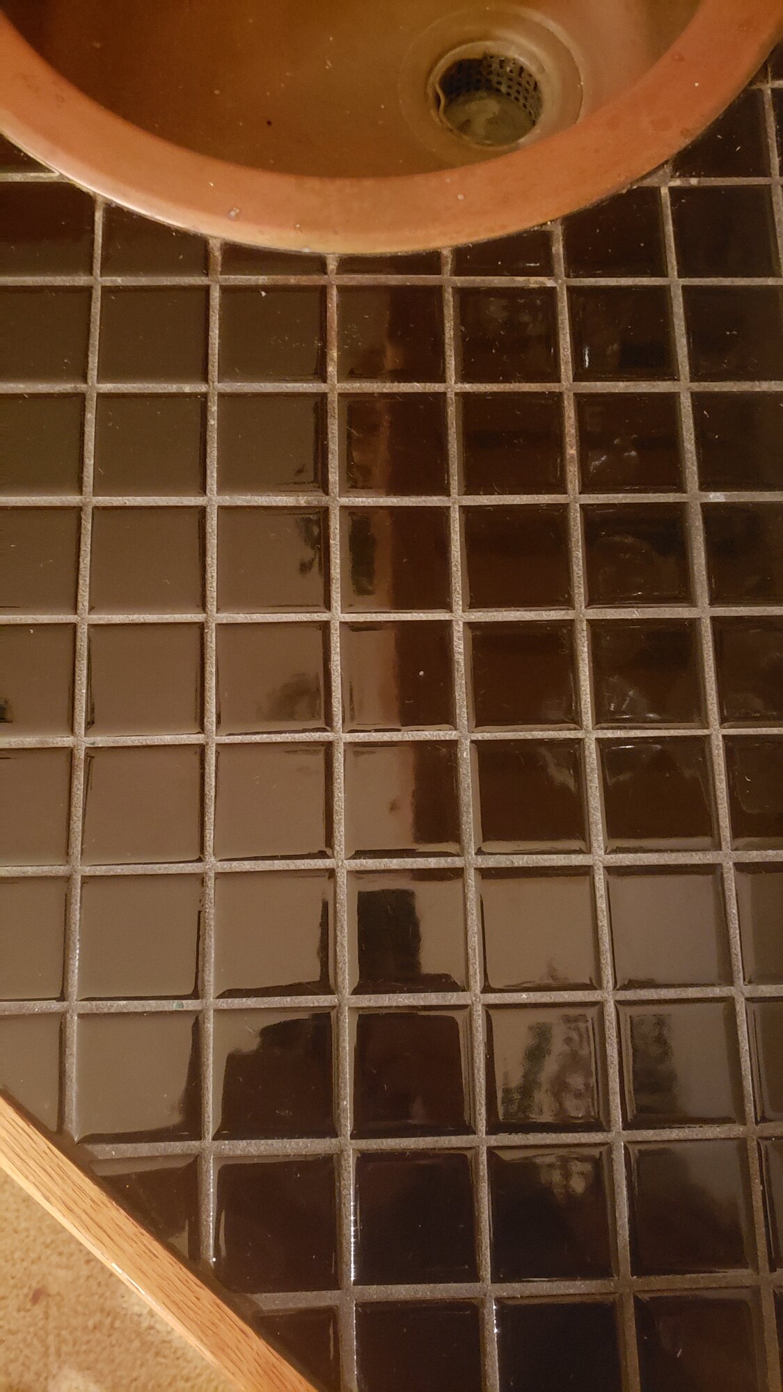

The coins I'm using here are only trying to show how uneven it is layed down. There's little ledges i can rest the coin on EVERYWHERE, throughout the entire border. It's as if there's mountains & valleys if product under there.
