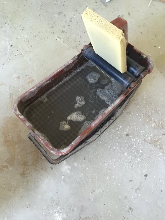

Washboy Woes
u
two problems here, sponge to wet and trying to remove to much liquid from the floor in one hit.
try shorter sweeps across the floor then work up to longer one to you find the max.
I have ordered the ramondi sweepex. Doing a 30m polished porc floor next week so will give it a go there and report back.
Let's hope so! With it being polished porc, it's recommended to use flexmaster additive with the 3000 to help adhesion to the polished edge of the tile so might take a little more washing off.
Unless your using an s2 adhesive I'm not sure that you'd need an additive in the grout
Tilemaster have recommended that you put the additive in when using highly polished porc to help the grout bond to the polished edge. It happend with another tiler who uses the same shop as me, the grout came away from the edge or edges of the tile and that's what they said.
