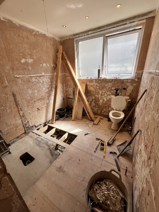

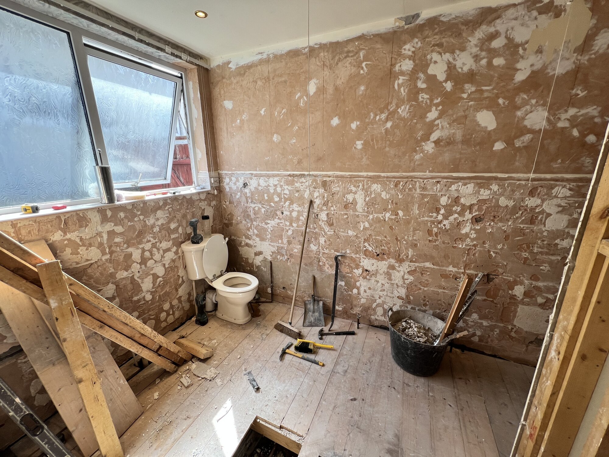

What would you guys do with the walls to prep for fitting 1200mm x 600mm Onice Verde (Porcelain) tiles. In places the plaster is loose so obviously i'll take that off, but would you hack back to brick and the use backer board or.....

Knock it off and use plasterboard adhesive at 300mm centers, knock it level wait for it to set then drill and screw right through each "dot" to the brickwork. That's fitted mechanically then as per tiling standards.

Thanks Dan. Yeah the tiles are beauties. I went with the hack off option. I have to do the floor too, so planned to overboard with the STS insulated board. I've ordered 50 of the tiles and on initial measure up I think i'll get away with very minimal wastage.

Check the weight of your tiles per sqr mtr. They should be fine to fix to 12.5mm plasterboard. ( no skimming). If there’s a wet area ( shower ) then tank that area prior to tiling.
Going to use Dan's method of dot and dab and then screw it once its dryed out. using sts construction board in wet areas
