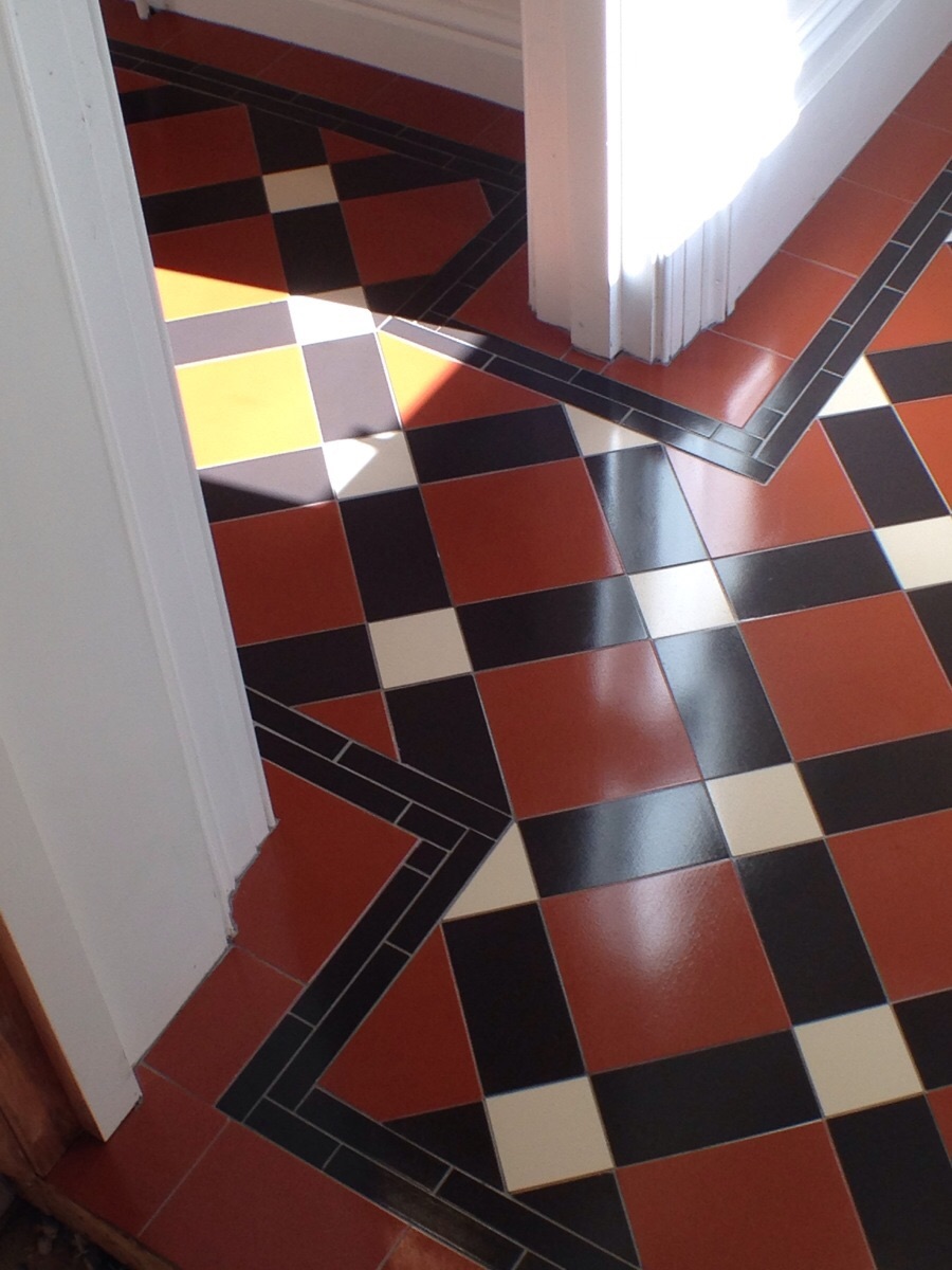

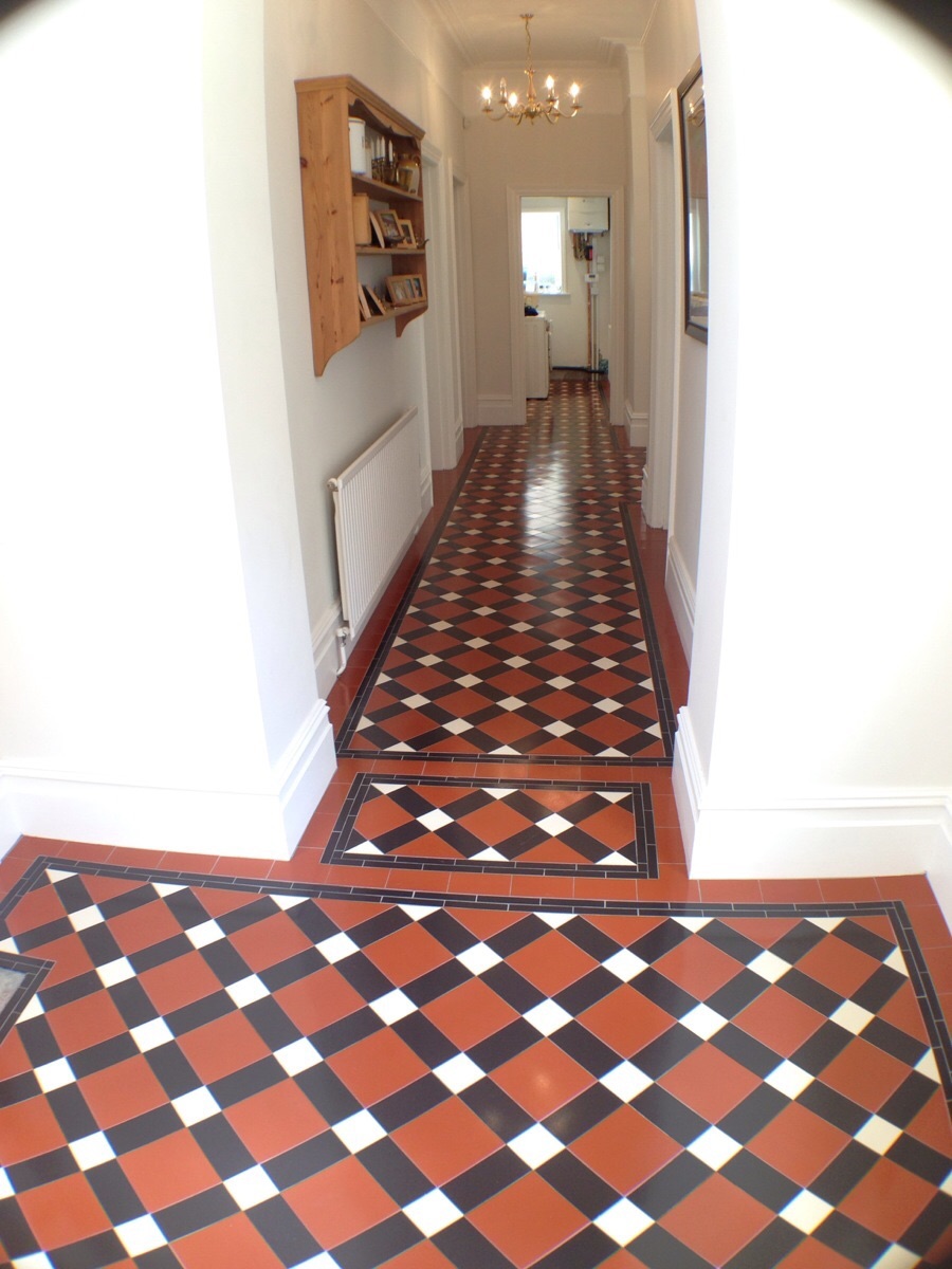

.if u'd like a shine on the finished floor u can use something like this...
Natural Stone Sealer | Stone Sealant Products | Sealer For Stone | From Nu-Life Stone Care
This floor was finished with the above sealer.
But a finish like this takes more maintenance.
