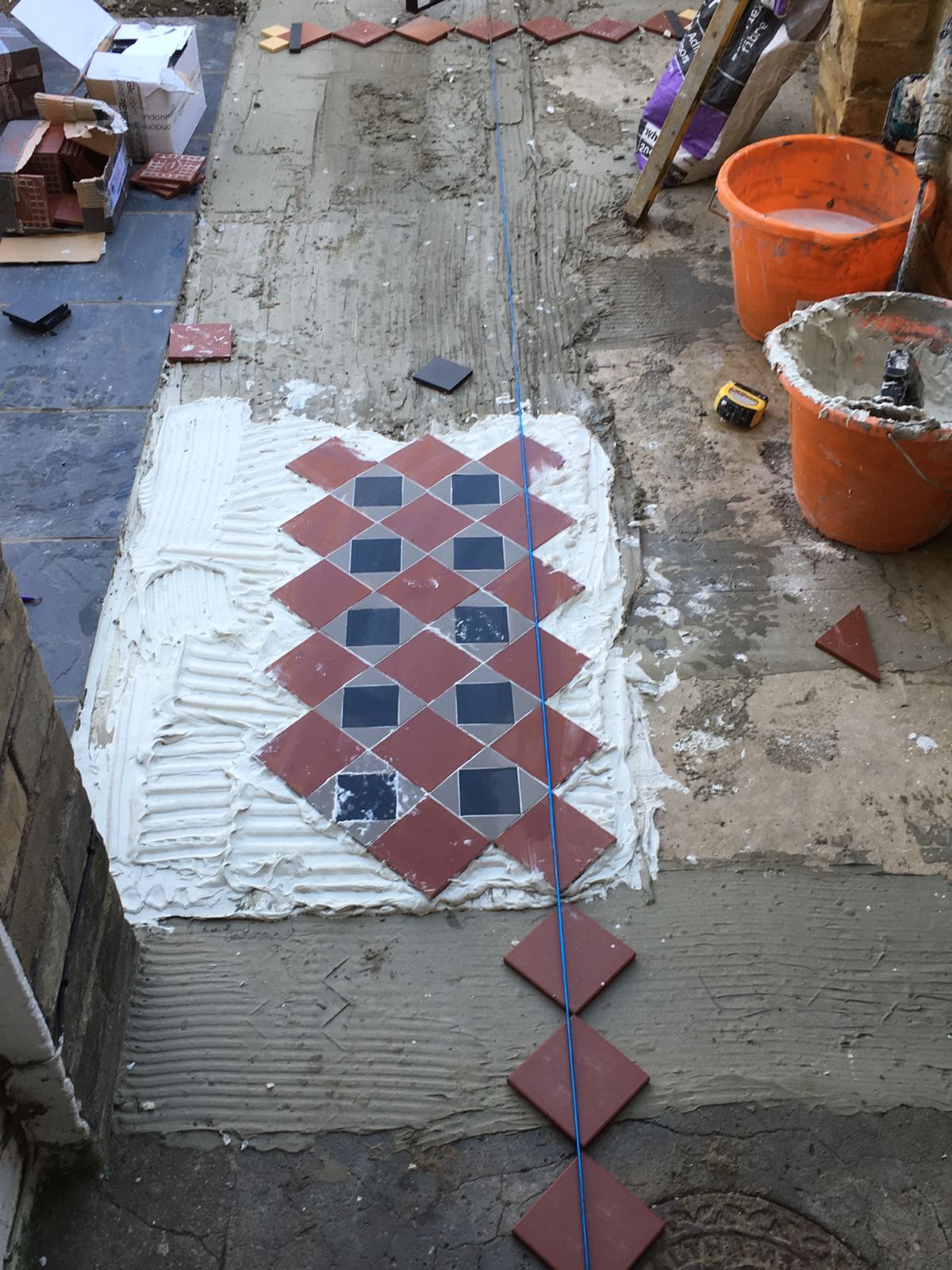

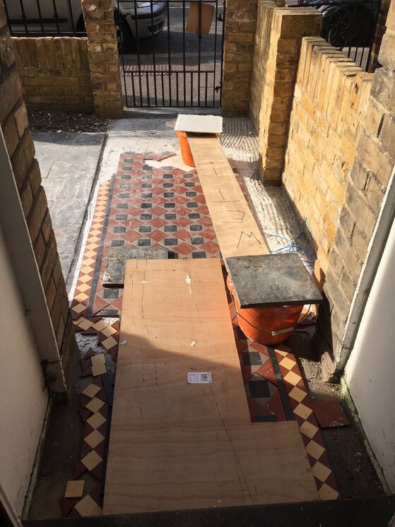

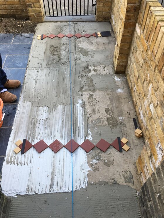

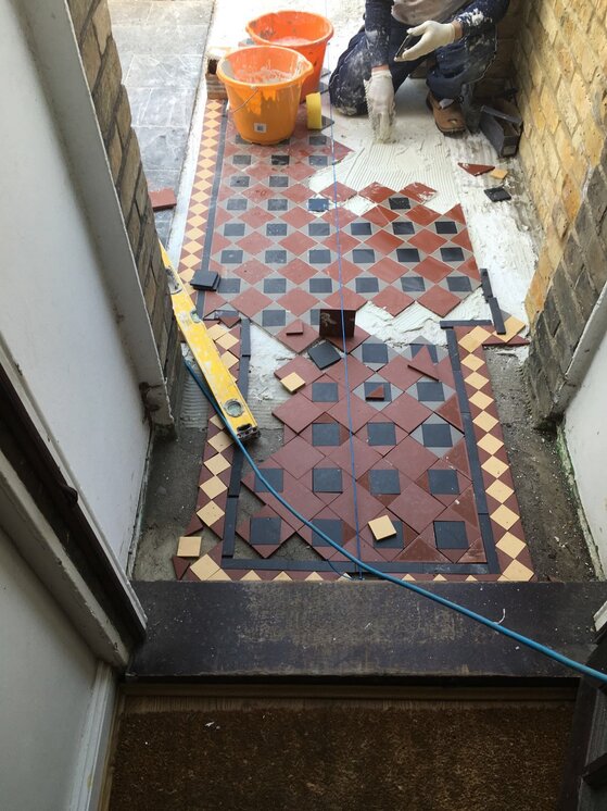

Would be interesting to know how much he charged. Was it dot and dabbed? Did he dry lay prior to tiling?
Here are some pics prior to him starting to tile and in the first week of tiling.
He did not dot and dab and he only dry laid some tiles...
IMG-20160505-WA0008.jpg IMG-20160505-WA0005.jpg IMG-20160421-WA0009.jpg IMG-20160420-WA0010.jpg IMG-20160420-WA0005.jpg IMG-20160420-WA0001.jpg
That 'tiler' hasn't got a clue, that adhesive 'bed/PREP?' Is an absolute mess and don't start me about the setting out. He's a guy that's maybe seen someone do it before and thinks he can do it to and is chancing his arm. Nothing more needs to be said really, a picture paints a thousand words as they say!
Being small tiles the pathway needs to be flat as a pancake, the third pic from the top what is with all the adhesive😕
He said 'he had to use a lot of adhesive to build up the heigh of the base as the existing base was not high enough...'
