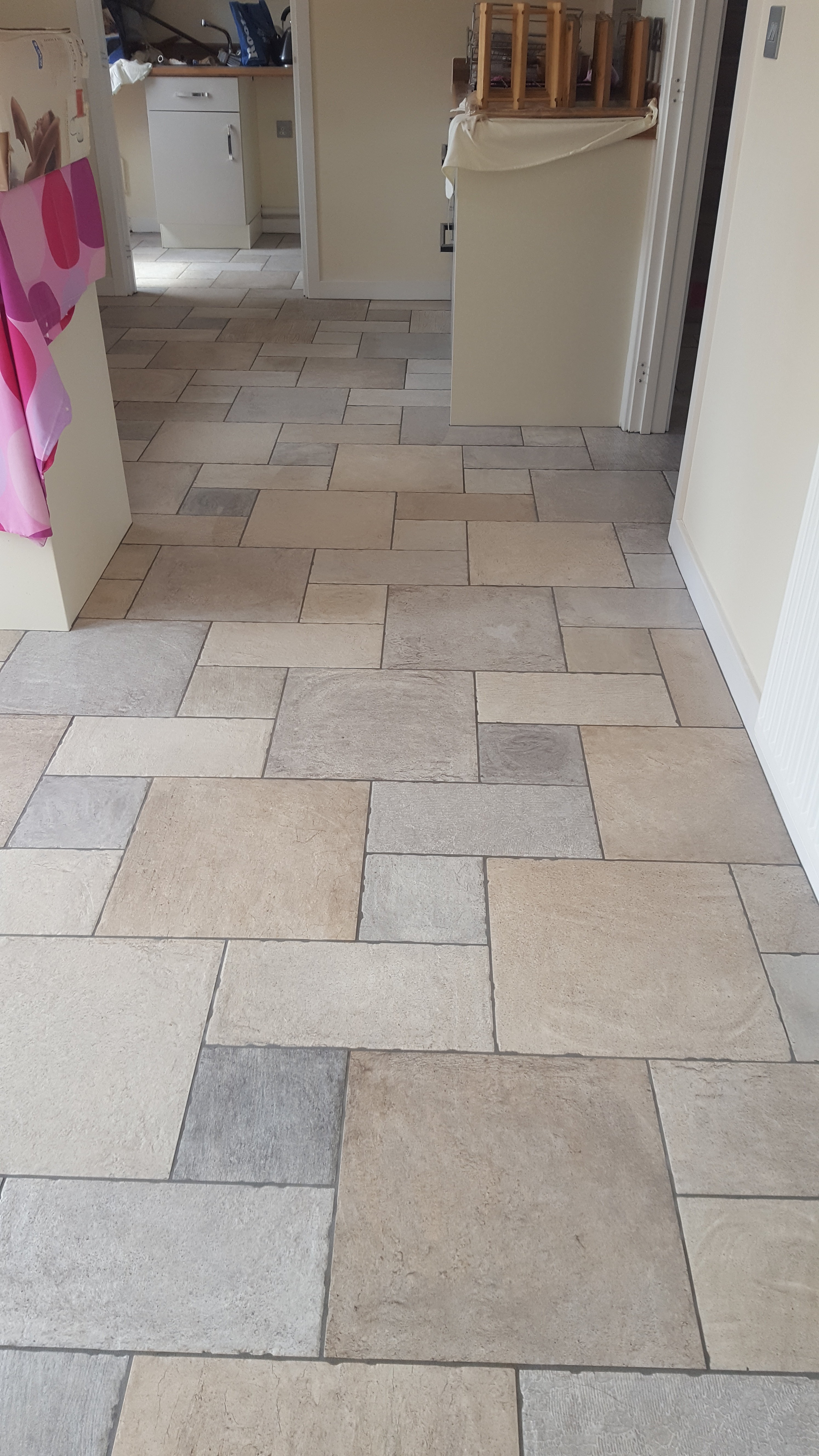

This floor I did last year, it was a hall running into a kitchen, dining room, utility, and cloakroom.
Everything was squared off the left side wall in the hallway. A Dead straight row of tiles were fixed down the length of the hall into the kitchen, I then laid the tiles in the other rooms working off this row, using long straight edges..
Hey Andy,
That looks very good! Fancy a trip to Ireland 😉 so looking at my layout would it be best to start on the right wall in the hall? And then dry lay them out in to the kitchen to the units and to the right wall? To make sure it would all be square.
Also as stated before, does anyone know what is best? Tile before or after skirting boards are on. I going on the side of under the skirt board as it would allow for the most “hidden” expansion gaps
