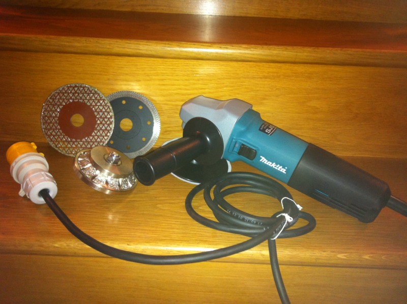

Got my new tools this evening from stonetools.
I only ordered late yesterday evening too !!!
I already have the discs for polishing but got a new bullnose bit as you see.
Brilliant prices and service from stonetools.

let me know how you get on with the vanity blade mate.
mines a bit tired and was considering getting one off stone tools
