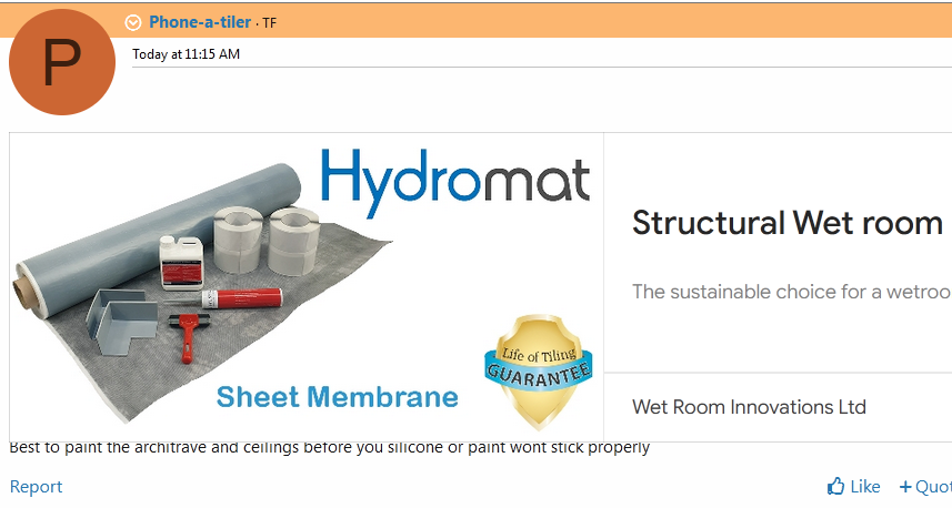

Unfortunately I can't read your post Phone a tiler, as these ridiculous adverts are obscuring it- see attached image.
I reported this problem to admin weeks ago and it still isn't resolved. Hmm!
