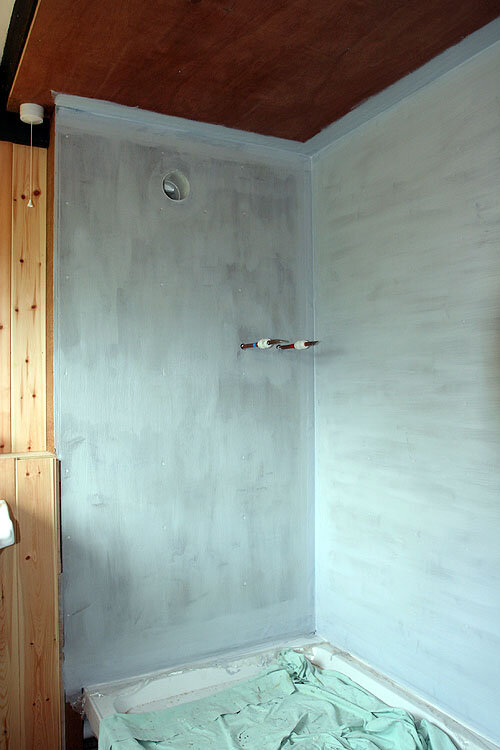

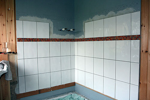

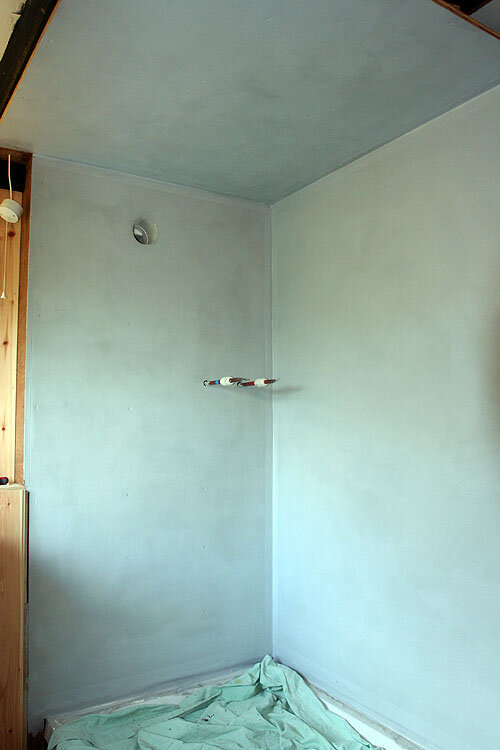

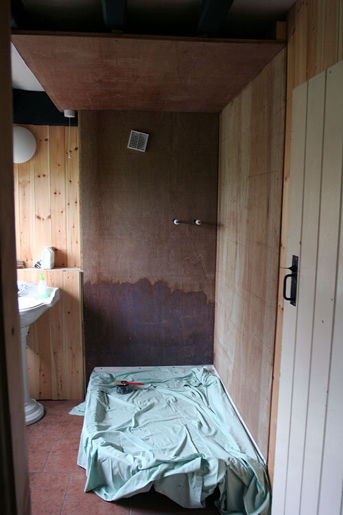

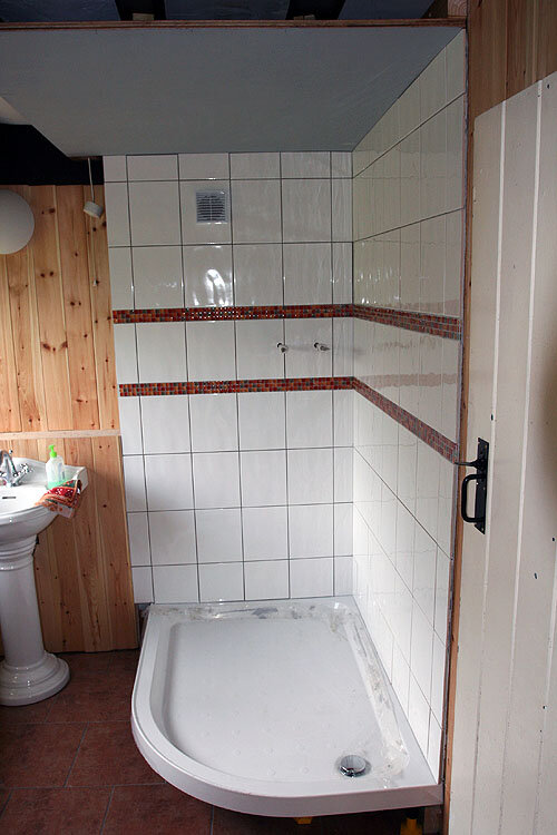

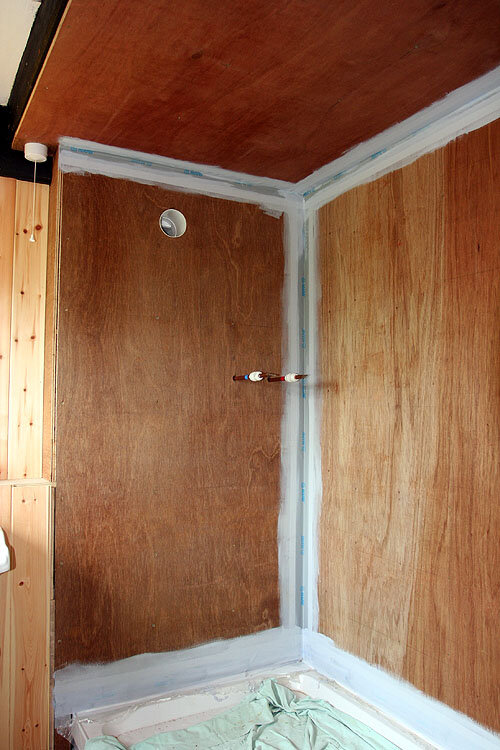

OK, I said I tended to make slow progress but here are some photos as requested by Daz (that'll teach you!).
Just to recap, the walls are 18mm wbp ply on a close studded 4x2 frame and screwed at about 10-inch centres (closer around the edges). I used a Mapei waterproofing kit and applied three coats. I then fixed the tiles with Mapei Keraflex as recommended by Mapei's technical helpline.
I cut the holes using 365drills diamond holesaws. A bit expensive for a DIYer as I doubt I'll ever use them very much again, but they certainly made an easy and neat job of the holes.

So, my next obvious question is about the grouting.
What is the latest and greatest in grouting that will not discolour and harbour mould?
I've read about epoxy grouts but the thought of trying to neatly apply "araldite" between tiles seems a bit alarming. :lol:
OK, I'm sure it can't really be like that but, seriously, is epoxy grout something worth considering or would the modern 'wipe-it-in-wipe-it-off' grouting be just as good these days?
whats happening with the ceiling flyfisher? have you tanked timber on it?
Yes, and I'll be tiling it this week sometime.
