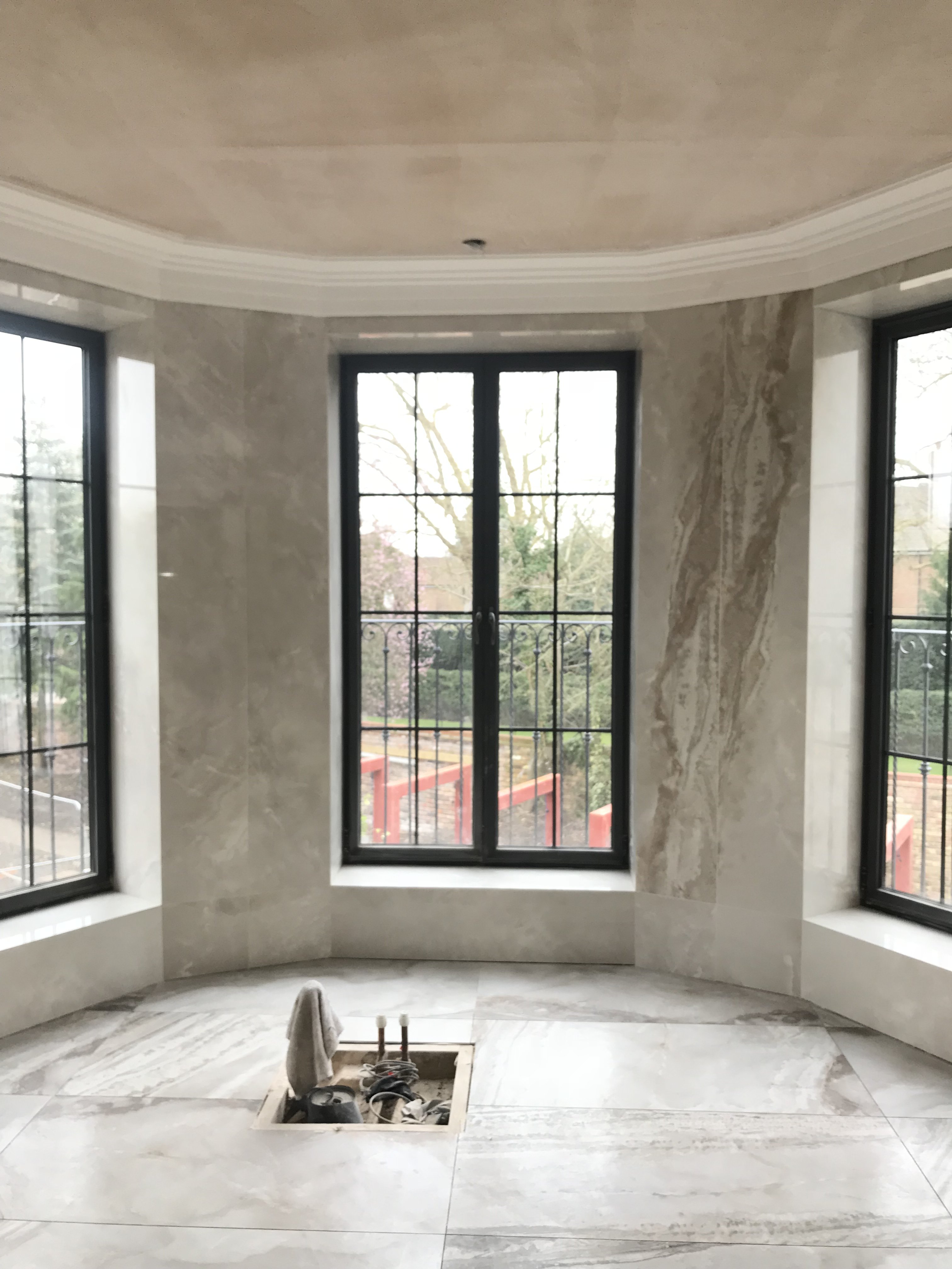

Both rooms. Lowering the ceiling to suit ?
Was the coving an after thought to make way for the bad set out....😛
No I’m serious actually Andy.
Every wall, bar two or three, are around 125mm, including all French doors.
That’s why there’s so many double cuts everywhere.
We’re thay 1.5m wide, it would have been a lot more seemless.
Same as height, was either a 290mm cut at floor or 150mm cut at cornice.
A 3m would have gone full height. 🙂
