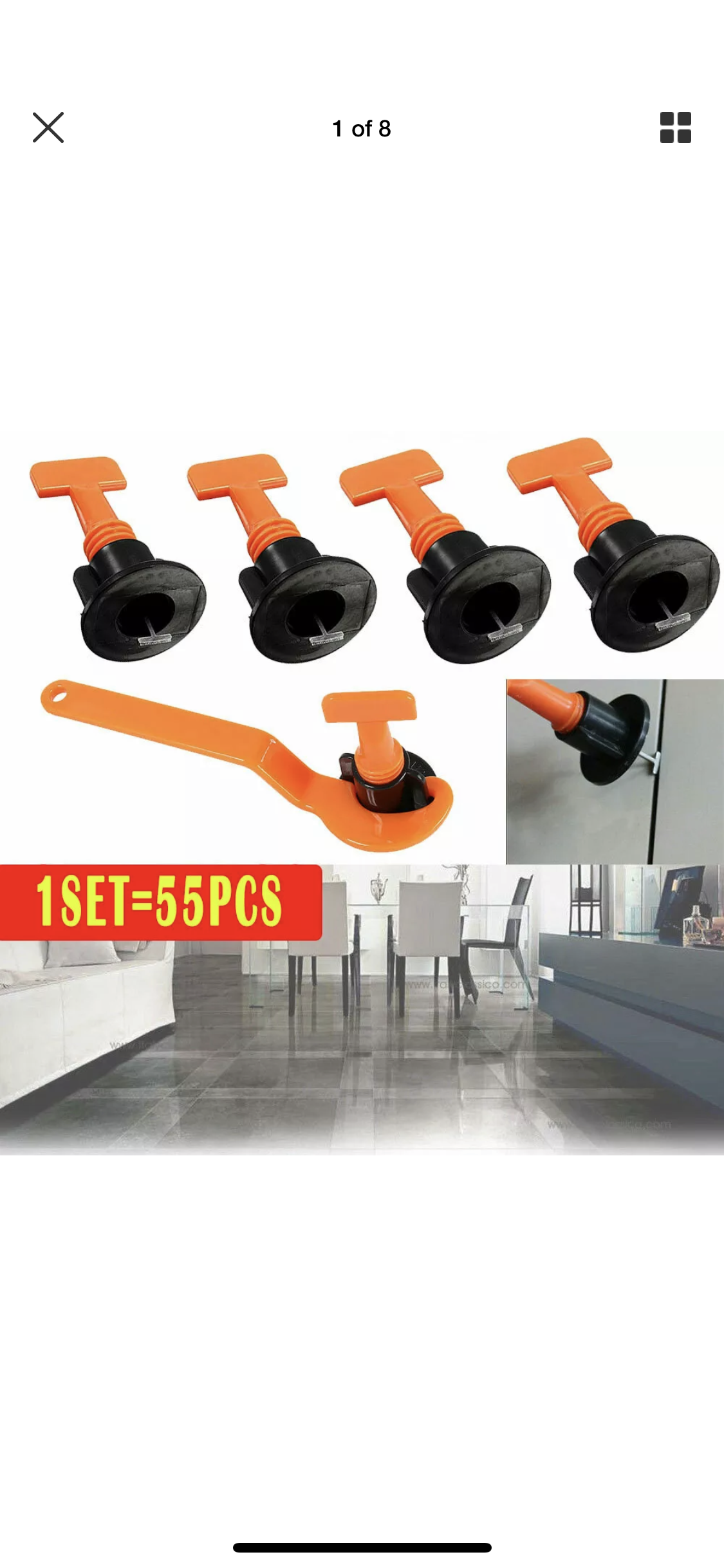

I guess I’m good then. Thanks for your advice. I have 50no of the attached. I tried them, they work well for levelling, but once you unbolt them, you have to hold the handle tight otherwise the t part snpases off easily, also it shifts the tile if not hold tight again . Hence I think the wedges are the best option, the correct one for my tiles atleast.
