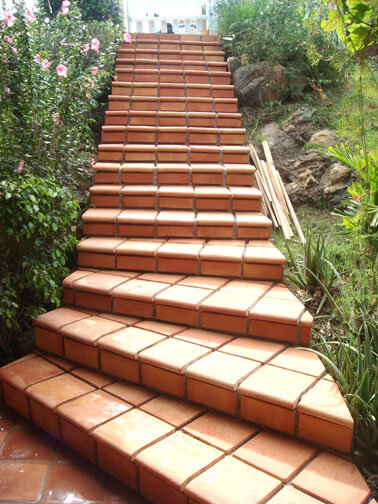

Hello,
I posted some pictures of the steps. The sealer I used is called H&G concrete sealer. It was recommended by a local paint store.
I put one coat of sealer on so far. I didn't grout it yet, as one wouldn't do with Saltillo tiles before sealing first.
I hope this helps.
Thanks.

Elon do a really good sealer for Saltillo tiles which is almost like a polyeurethane sealer it is called Bentens it is the best sealing product you can get for terracotta ,this would hold sand with out it wearing away however you can purchase self adhesive carborundum tape which is often put on step treads to make them non slip
hope this helps
It is a nice job...and looking aroung i din't think it is the uk either.....lol...
so shouldn't have any probs with the face blowing off them in the freeze / thaw factor...
and thanks for the pics..
