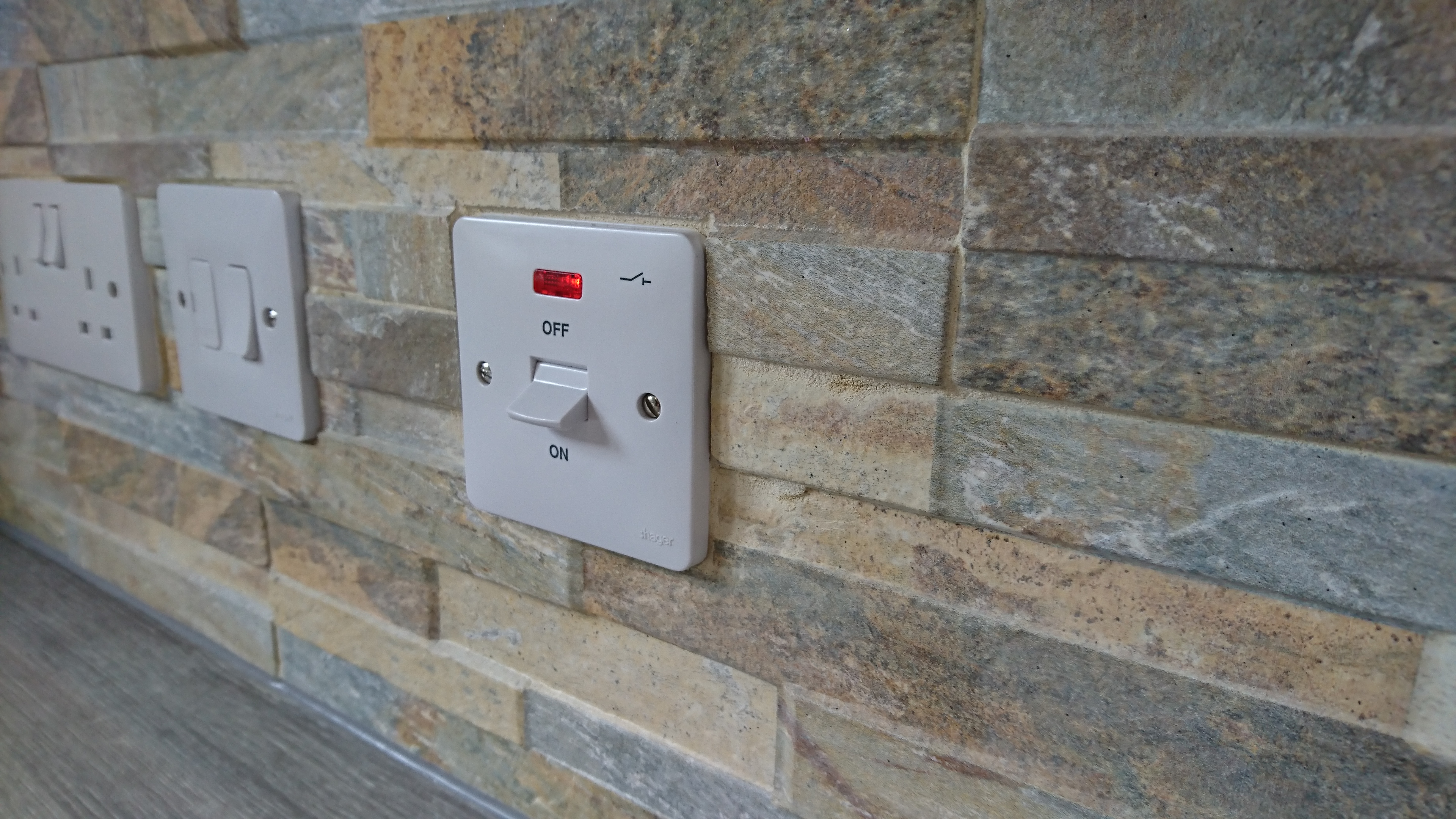

I put a spacer behind the socket/ FCU and cut the tile to that.
Like this.
Like this.
Like this.
Thanks for that, what size spacer did you use?
Did you grout between all the tiles? Just asking as I head ready some people hadn't grouted the tiles and just butted them close together.
Also wondered if you found it hard to grout due to different heights and textured face of the tiles?
