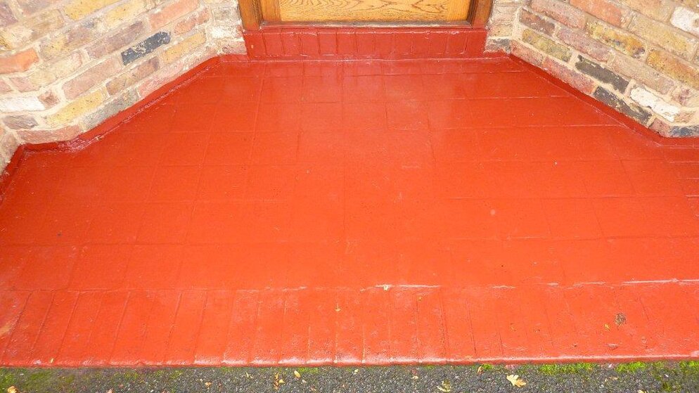

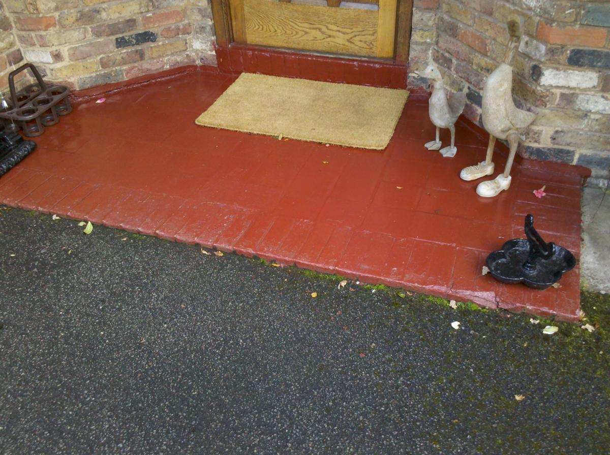

Just been given a 2 day job to tile a porch. I popped around today to have a quick look and found painted brick & quarry tiles.
I know the paint will have to come off, but do you think that a layer of SLC would be best suited before I tile? Slate tiles are to be laid, but I am concerned that moisture could cause efflorescence. I have only every tiled with slate indoors. At this moment in time I do not know what type of slate the customer is having.

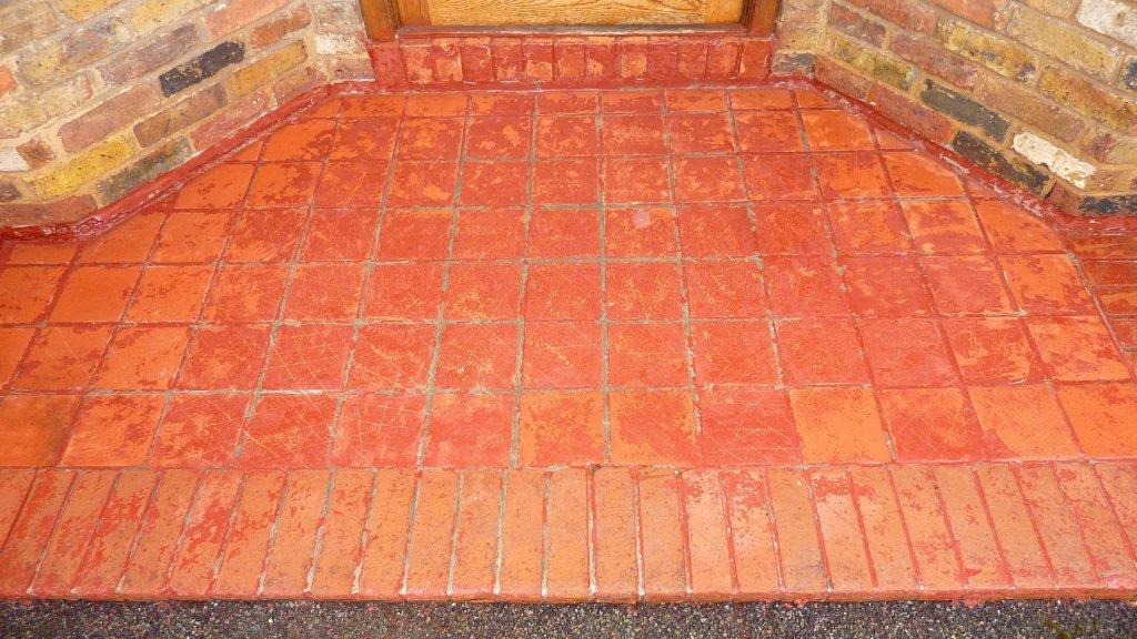

Rich, Just for you.......(as requested).
It was a bit of a bugger to get the paint off. I tried a stiff nylon brush attachment for my drill, but that did not do much damage, then I tried a wax remover, but that did not do much. Then I used a pressure washer which did the trick. The step had 2 thick coats of paint in May, but I found several layers of paint and loads of wax polish.
