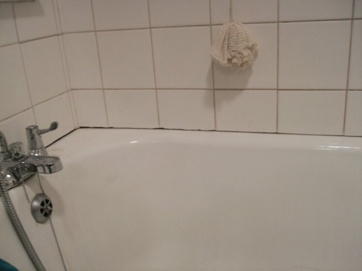

Evening all. I have just replaced the Silicon around my mothers bath as the ols Silicon had split and come away. I thought while I was doing it I would take some snaps so that I could put up a post on the dangers of using Silicon over grout.
Using a Silicon joint in tiling is not just to make a nice finish. It is used to keep the joint water proof and it is also used as a movement joint. At any junction where tiles meet another object like a bath, basin or another tiled wall/floor the joint between the two should be left totally clear of grout. I find that the best way to do this is to grout in all the joints running into the expansion joint and let the grout set off, then I run a knife or a paint scraper along the movement joint to remove all the grout. I then let the grout dry completely. When I come back to Silicon, I make sure all the joints to be siliconed are clear of any grout/adhesive/dust but sweeping, scraping and hoovering the joint out. After this I give all the joints a wipe over with meths on a rag to remove any grease and grime. Then I am ready to apply the Silicon. The Silicon is there because it is much more flexible than grout, grout will just crack and will let water through. If you grout these joints and then just Silicon over the top, the grout will crack and come away from the joint taking the Silicon with it, this is what has happened in my mothers bathroom below.
You will have to ignore if you can the god awful tiling, it was done by my step dad many years ago, he is so proud of it bless him it has never been changed. If this room had been tiled by a pro the cuts along the top of the bath would (should) be even all the way along the length of the bath (makes it easier when it comes to Silicon).

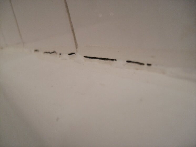

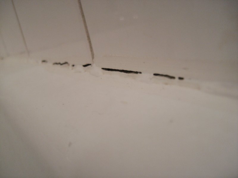

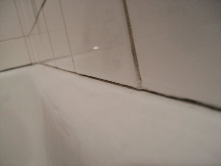

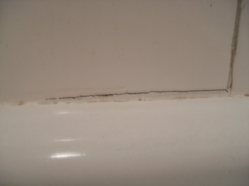

Notice how the grout has come away from the joint behind the Silicon and taken the Silicon with it.

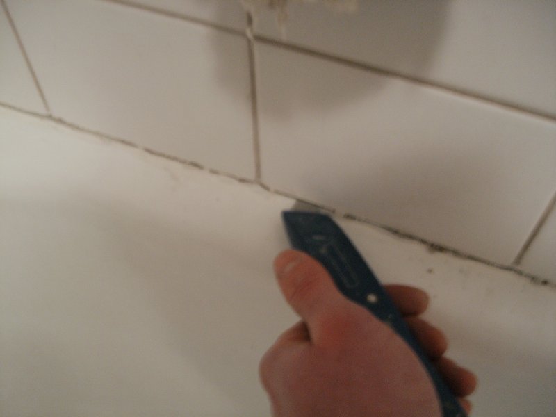

A stanley knife is used to cut out all grout/adhesive/grit from the movement joint then the joint is hoovered out to remove all dust.

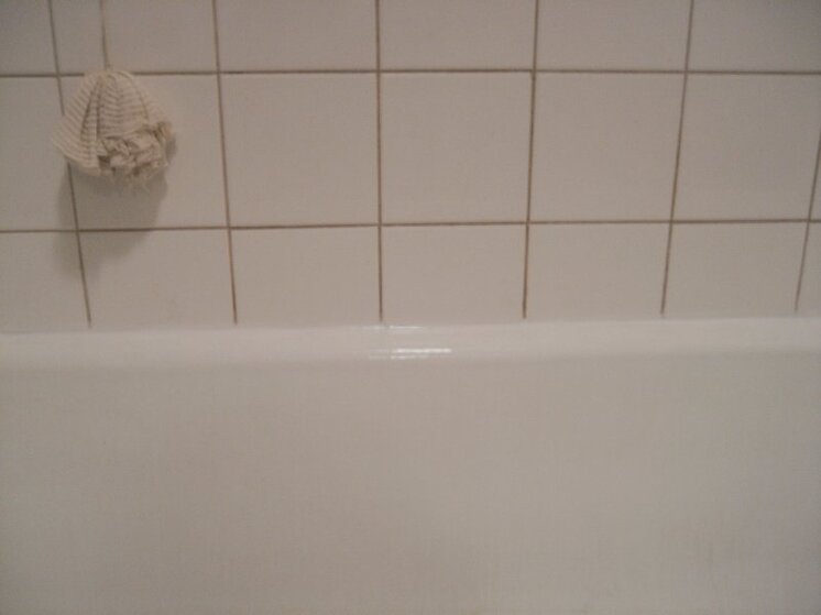

The joint is then cleaned, rubbing a clean rag with meths along the joints will get rid of any grease and will totally evaporate and leave no residue.

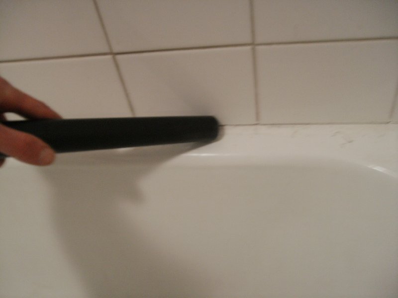

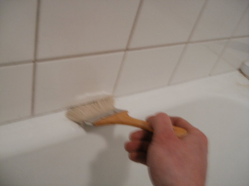

To be safe I give the joints a quick brush out with a clean brush to make sure no dust has settled in the joint after I have hoovered it out.
