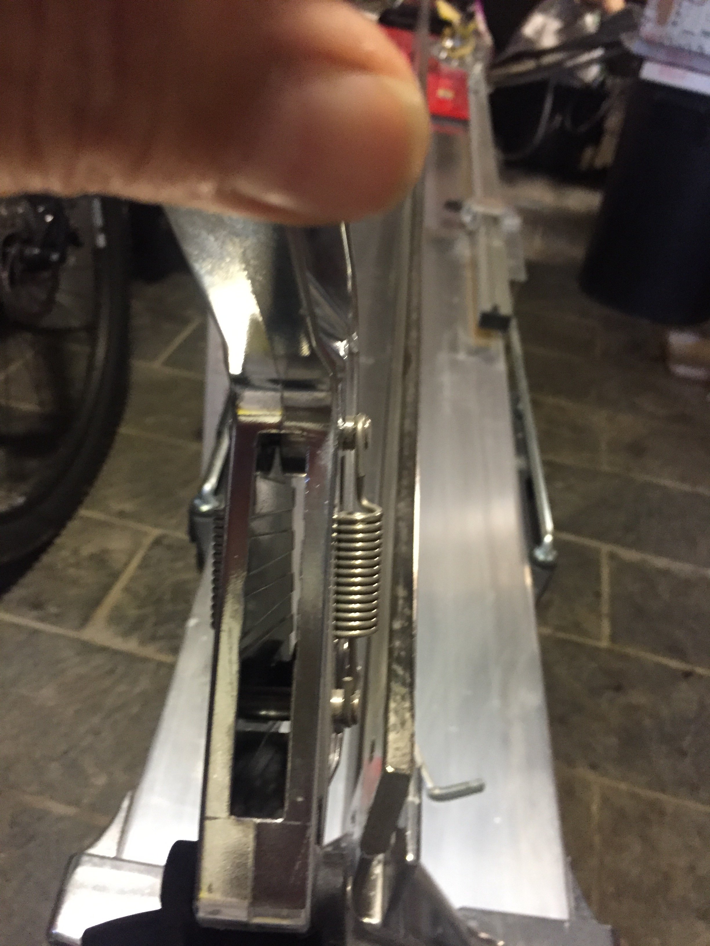

Sigma 3e3m
1 time every 10/15 days.
I clean with a cloth.
wd40 and dry it with a cloth.
as a user manual montolit ahaahah
At the end of each day I wire wool the rail, take the handle off, give it a quick wire brush inside and pull an appropriately folded face cloth through, the hole procedure takes no more than two minutes
I never removed the handle
it works!!!! thanks lee flinstone very good 🙂
