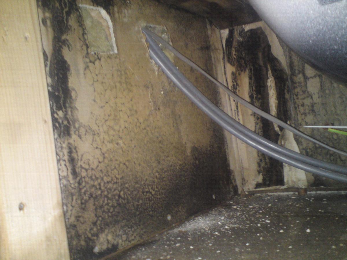

Tanking is a must IMO as it prevents further damage if the tiling fails, which it does occasionally. Cement based grouts are not waterproof and still allow some moisture through to the substrate. Green plasterboard is only moisture resistant and will break down if allowed to stay damp. I always install a membrane for tanking, and for very little cost, gives you greater peace of mind.
Below is a pic of green plasterboard that's been allowed to stay damp for a continued period of time from a leaking shower.
Here is some water damage under the bath which spread across the bathroom floor and damged the ceiling down stairs on a job I refitted.
The benefit of membrane is that the water will not get through. If using tape with liquid tanking kits you can seal over the bath to wall or you can seal full wall and then floor area including intersection where the wall meets the floor giving total peice of mind for years to come. You can also choose sheet membranes.
This picture you see was a job that was probably double sealed e.g. gap of bath and wall was sealed before and after tiling but these seals break down and fail eventualy and permit even more water to enter vulnerable areas. Tanking will prevent damage when your seal fails (seals should be maintained even when area has been tanked)

the sooner tanking is incorporated into the building regs the better imo, I hate having to battle with building companies that won't have it installed:mad2::mad2:
