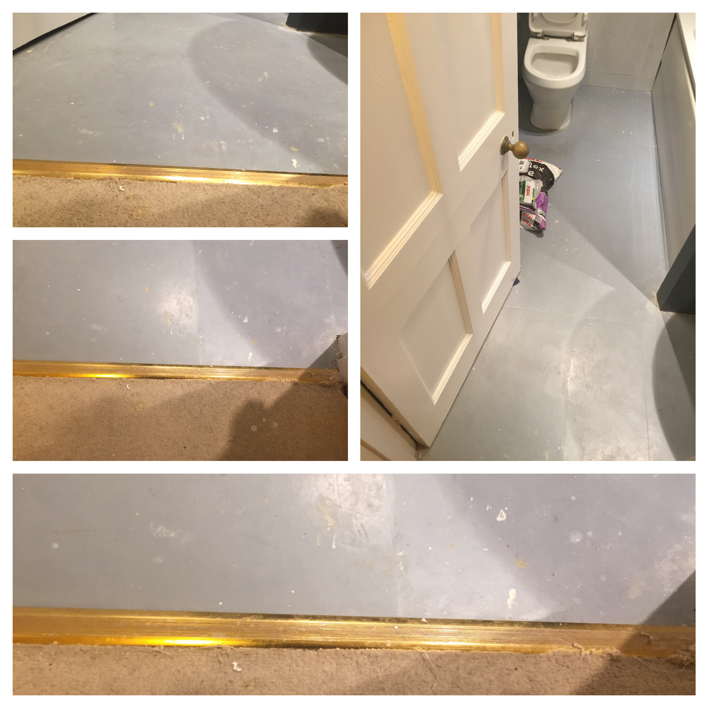

here are some snaps of the kitchen and bathroom floors
