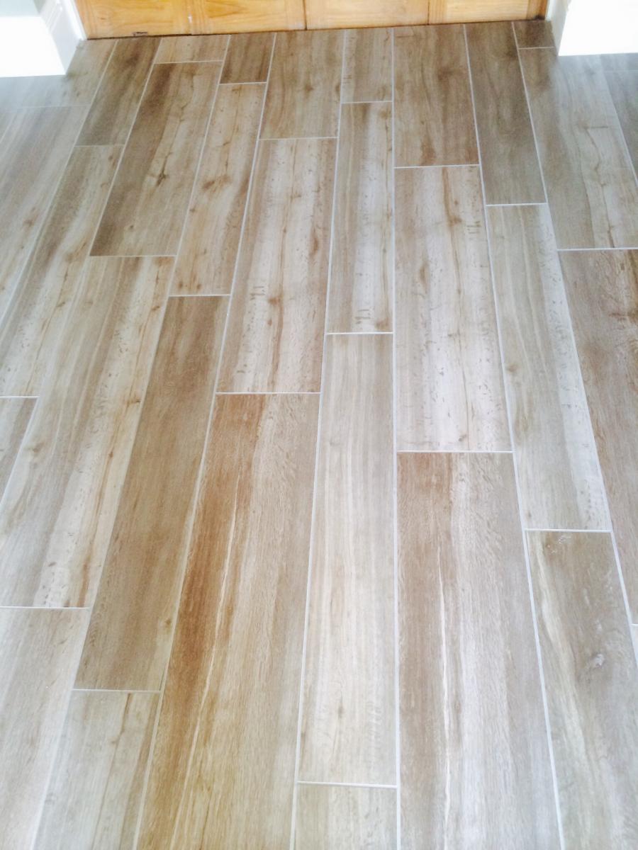

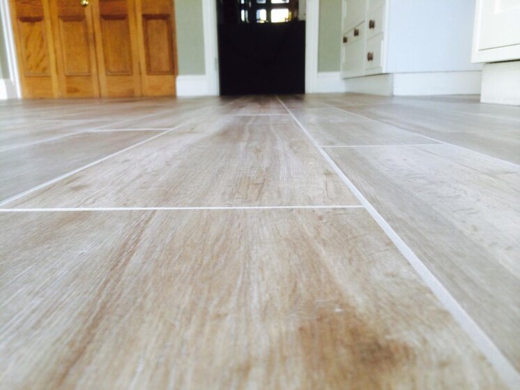

Here's some pics of the floor I did this week. Don't just take your off cut and start a new row as you may end up with a slither. It's best to keep checking your measurements and forward plan to get a nice even and manageable look, IMO.
Daz, that's nice.
Obviously you have to make sure you don't end up with a daft cut at the finish of a row,
I've seen a few & they are too uniform for my liking, that's not to say they aren't right, I just prefer it done totally random like the way you have done.
