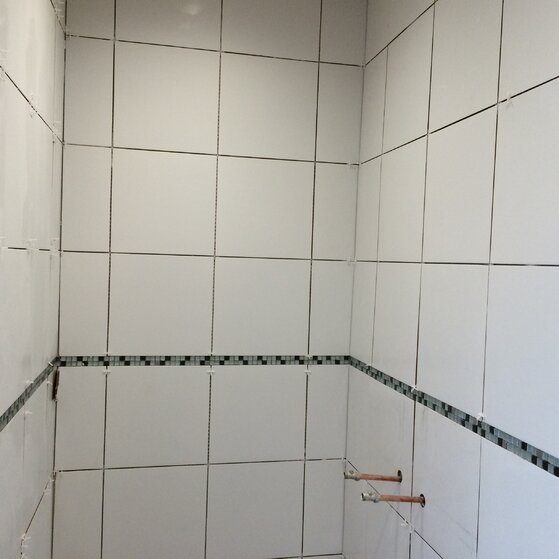

Hi everyone. Been on an ensuite that I created for a customer. Shower, basin, toilet. 24m2 walls, 4m2 of floor all in ceramic. Every day I've had at least one niggle with customer about something or other on my tiling. I think it's fine. Ive used bagged adhesive, walls are all primed also. I think they are getting a bit too picky. My background is I've been a plumber for 12 years now since school and tiled every bathroom myself after about 3 years in so a good 9 years experience. Any thoughts?
mainly about tile cuts and thinking I'm wasting tiles by not starting from edges and there was one tile lipped of which I dug out and replaced. I explained that you can't start from a wall because of the levels etc. Like talking to a wall. I'm patient and like to make my customers happy. A line has to be drawn somewhere

As above, you're going to end up with some small slithers of tile around the window reveal, but that's about all I can spot. Your setting out on the back wall on first photo looks fine to me, if we are being really picky, then I would say there is some unevenness across some of the tiles.

Picture 1 - the cuts to the back wall on the left hand side are uneven and short. Doing the back wall first and then cutting the side walls onto it would disguise this until grouted/sealed.
Picture 2 - mosaics are squashed into border gap and show signs of unevenness. Put a gap the size of your mosaic border + joints all the way around 1st and allow adhesive to dry before inserting mosaic.

You've tiled onto unprepared emulsion walls.

I've primed the walls. Tile above window I replaced. One thing I did kick myself for is not shifting a half tile or so over to make my l cuts a bit easier. It's annoying when your being watched constantly. All advice taken in. Thanks
