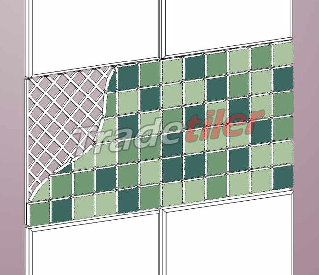

Should have used BEAVA MESH TO ADD THICKNESS TO THE MOSAICS, OR ADDED A THICKER BED OF ADHESIVE TO COMPENSATE THE DIFFERENCE IN THICKNESS.
Hi Kelly
We supply a sheet to put behind mosaic or tiles to increase the bed thickness
Have a look on our web site here:-
http://www.tradetiler.com/homelux-mosaic-mat-mesh-backing-sheet-300-x-300-x-1-4mm.html
