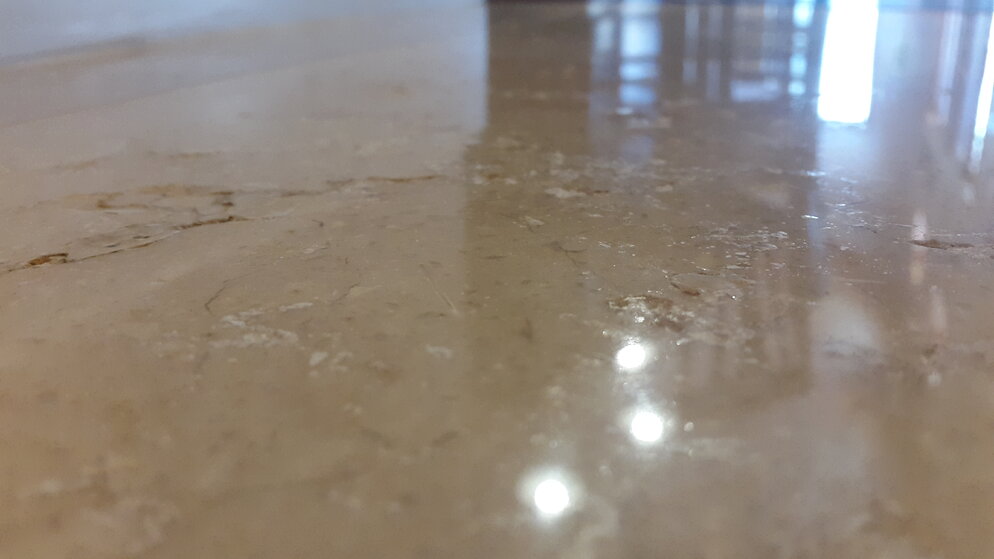

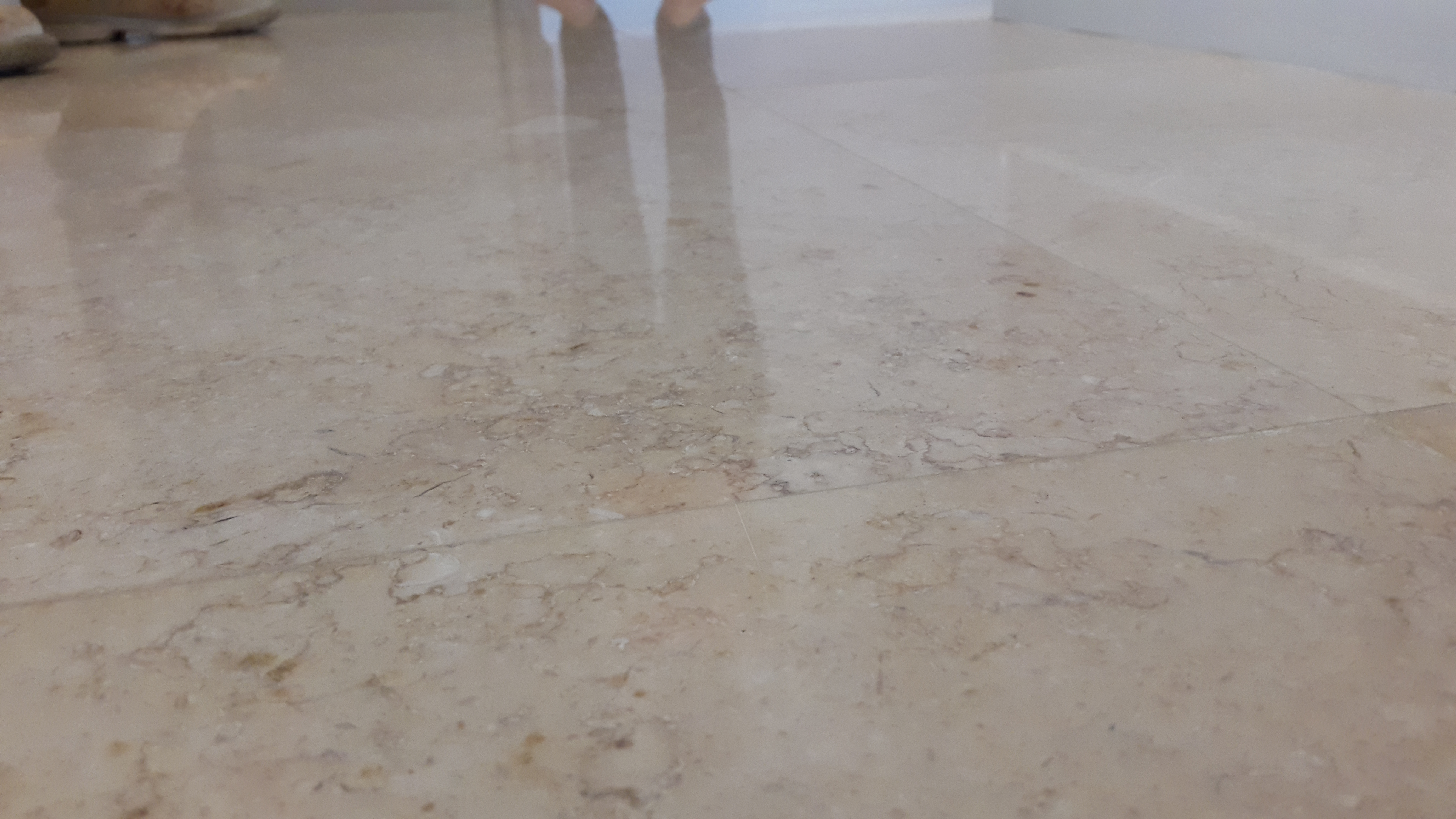

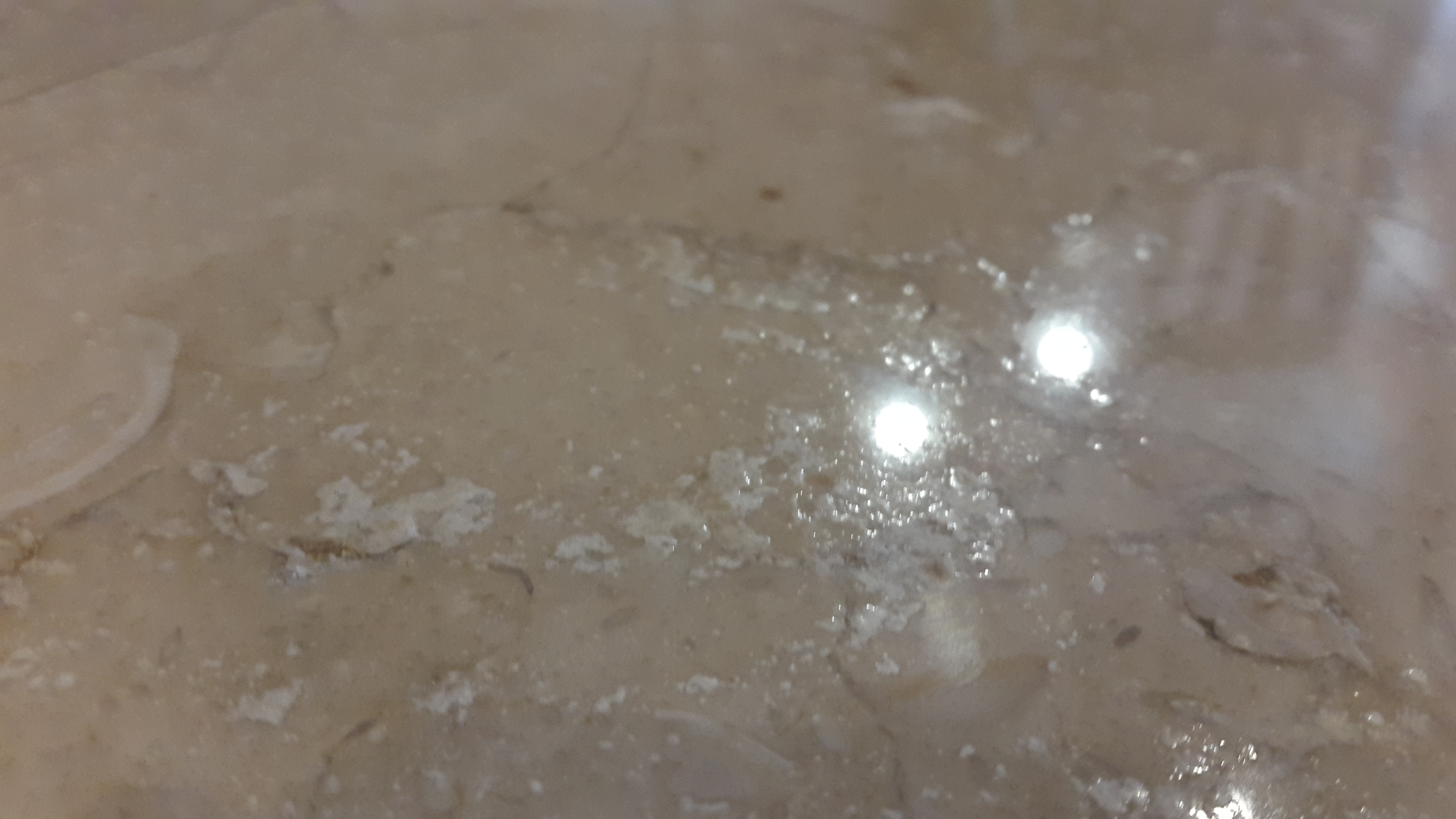

What is happening to a very few select tiles is almost a crazing, a bubbling up if you will from the veins of the marble. This appears to be breaking down the highly polished surface and leaving a rough, almost chemical burned surface before it eventually eats away at itself and leaves a little loose marble.

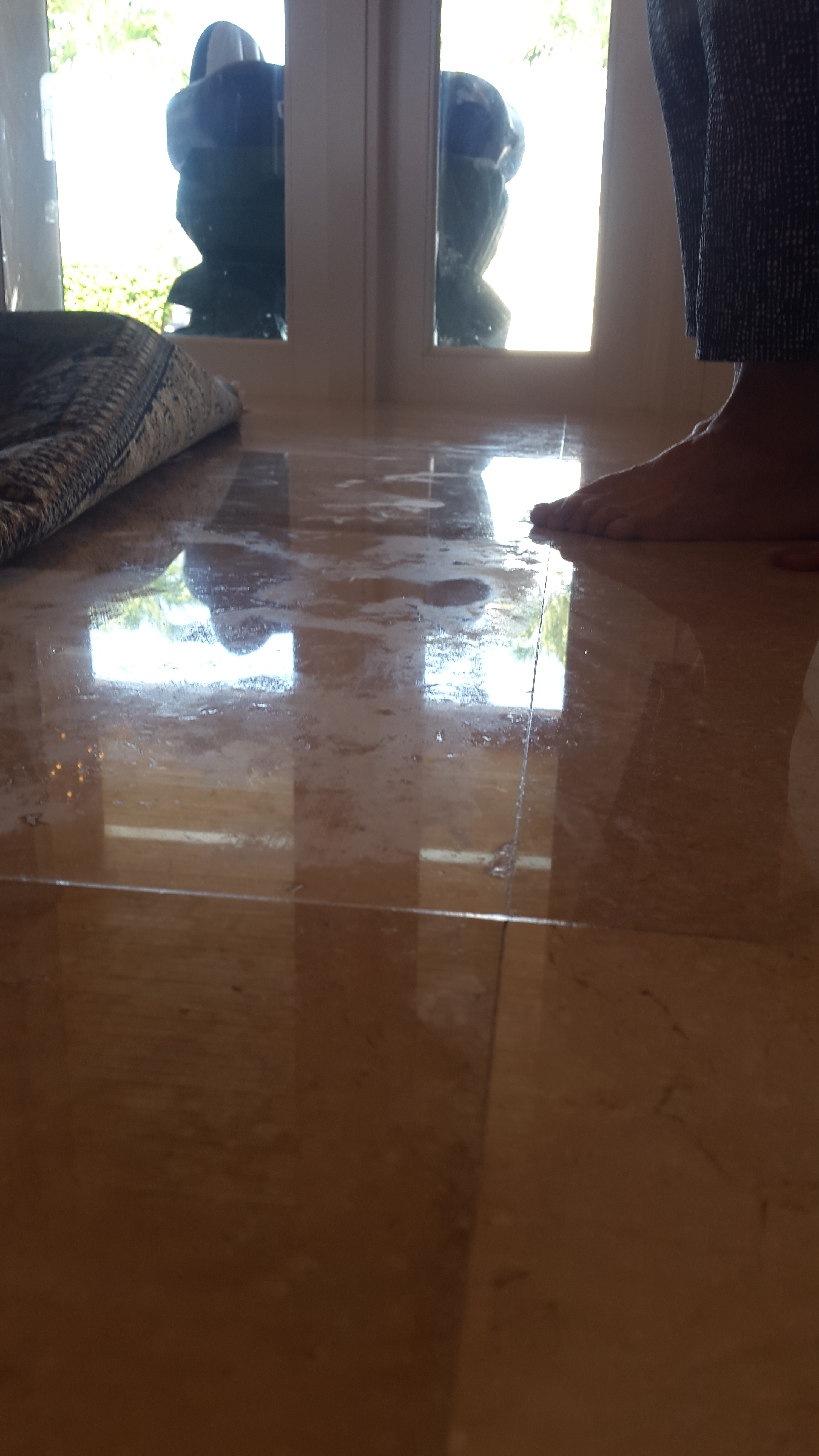

On some tiles there is what appears to be an orange peel feeling and underneath the rug, which is where the cleaner seems to not mop (with water, no other cleaning products at all, so they say).
On others there is a residue which can be rubbed off with a scotch pad before returning over the course of a few days under the rug.
I am unsure where the marble was imported from, I am guessing a firm in Miami as that is where most of the material gets delivered from, so it makes sense to purchase from tile/slab suppliers here.
The only other information I can give you is that the house is next to a canal and that the plumber flooded the whole floor at one point during the install. At which point of the install I am don't know.
I can also say that the tiles that are affected in one certain area are showing dark patches which to me suggests water ingress.
I can only assume that something from the sub-base is rising to the top and causing this issue. No tiles have been removed to check what is happening below it as they do not have any attic stock.

Hi cam, could be a mild spalling effect in some areas,most likely moisture related, salt traces and evaporating moisture migrating from beneath as these form mineral salts this can expand the stone through and at the face and de laminate, can effect if the tiles are sealed before all moisture is released before sealing, have these been sealed? These will require mechanical finishing , but if the contamination is deep, more likely replacement to match the factory finish or surrounding stones.
The last picture, was that dark mark under that furniture leg, if furniture stain a stripping agent or stain remover to remove . Or are there more of these in other areas

The last thing that i noticed was the dark patches around the affected tiles which led me to believe this is moisture related. The temp here never drops below 23 during the evening, during the day its can hit 33 and the humidity can almost feel like me mother just asked me to check on the christmas turkey for a baste. Air conditioning must also be a variable added to the pot, due to the cost of services over here.
I can only assume the tiles were sealed, without going into too much detail, the finish is immaculate. These boys know their stone as this is the main product customers want on island. Sealing, protection and informing the customer is part and parcel of the service that is provided.
The local tile shop stocks fila, lithofin amongst other brands which all provide a service to the need of the specific stone.
I have suggested that one tile be removed and an identical tile with highly polished finish be cut to size and replaced once any moisture test is conducted.
The last picture shows the staining on the tile in the same colour that the legs have. Customer was quick to defer the possibility it has anything to do with it. I'll take that one on the chin until I have any more opinions.
The companies guy whom conducted a moisture test said that it is most certainly an environmental issue. Unsure if there is any dpm below the slab, this is going to be a long and lengthy process to decipher exactly what is happening.
thanks for the reply bob
Good luck with investigations, possible furniture stain, could try a mildew remover product , 2-10 min application can sometimes remove these if the solvent stripper fails.
