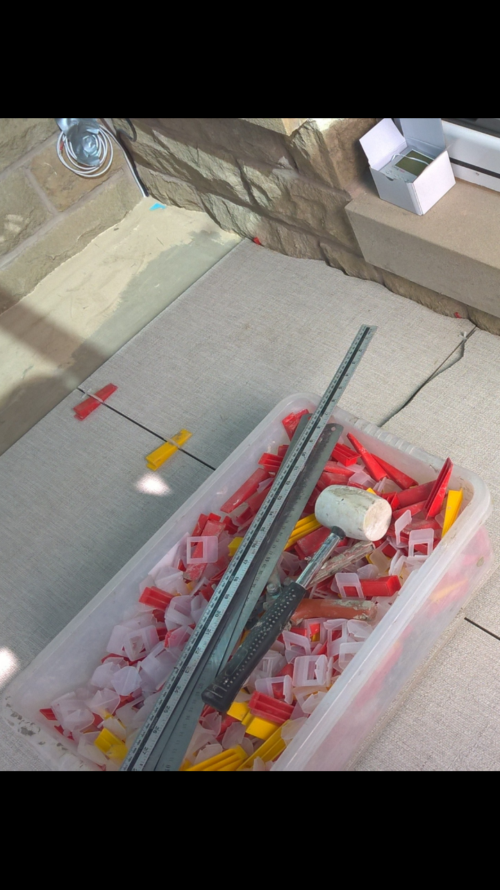

Just pour em into a big plastic tub...looks like your know what your doing then 😉View attachment 102062
