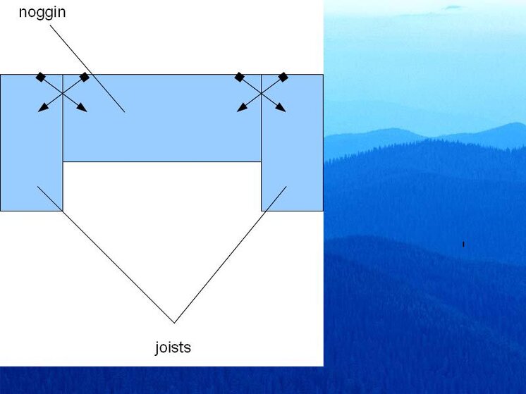

I would suggest screwing the noggings with screws on an angle with two screws on each side of a noggin. I think it's less stress on screws hence better joint.
The arrows are the screws. Never mind the Blue Hills, I had to ruin a sample picture from my computer to upload the idea :thumbsup:
The reason screws and nails are angled (toshed/toe nailed call it what you like) is because as it is not parallel with the end grain it is stronger. It has greater resistance to withdrawal this way.
However, with modern screws or ring shanked nails (improved nails) the strength is pretty good.
