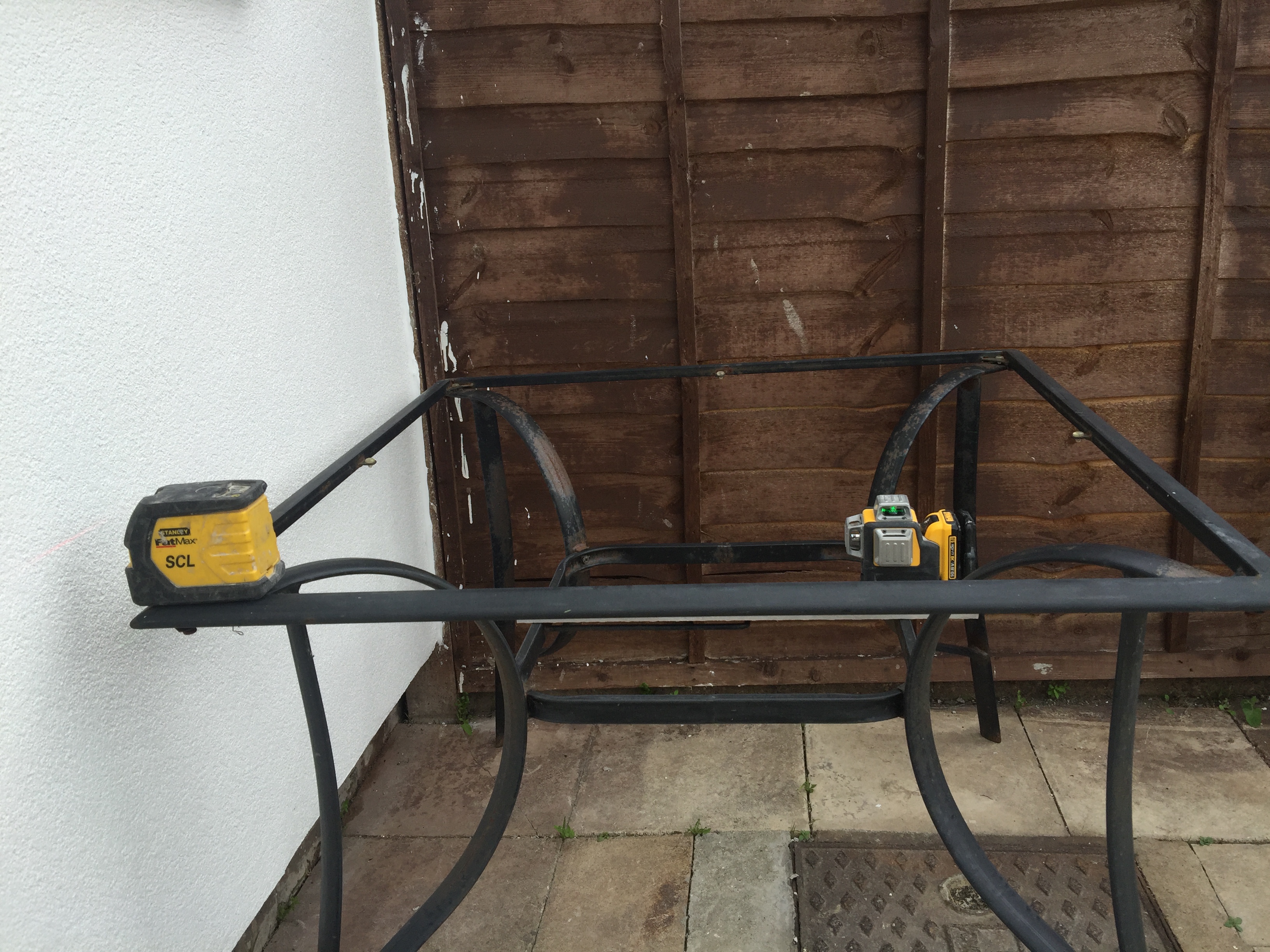

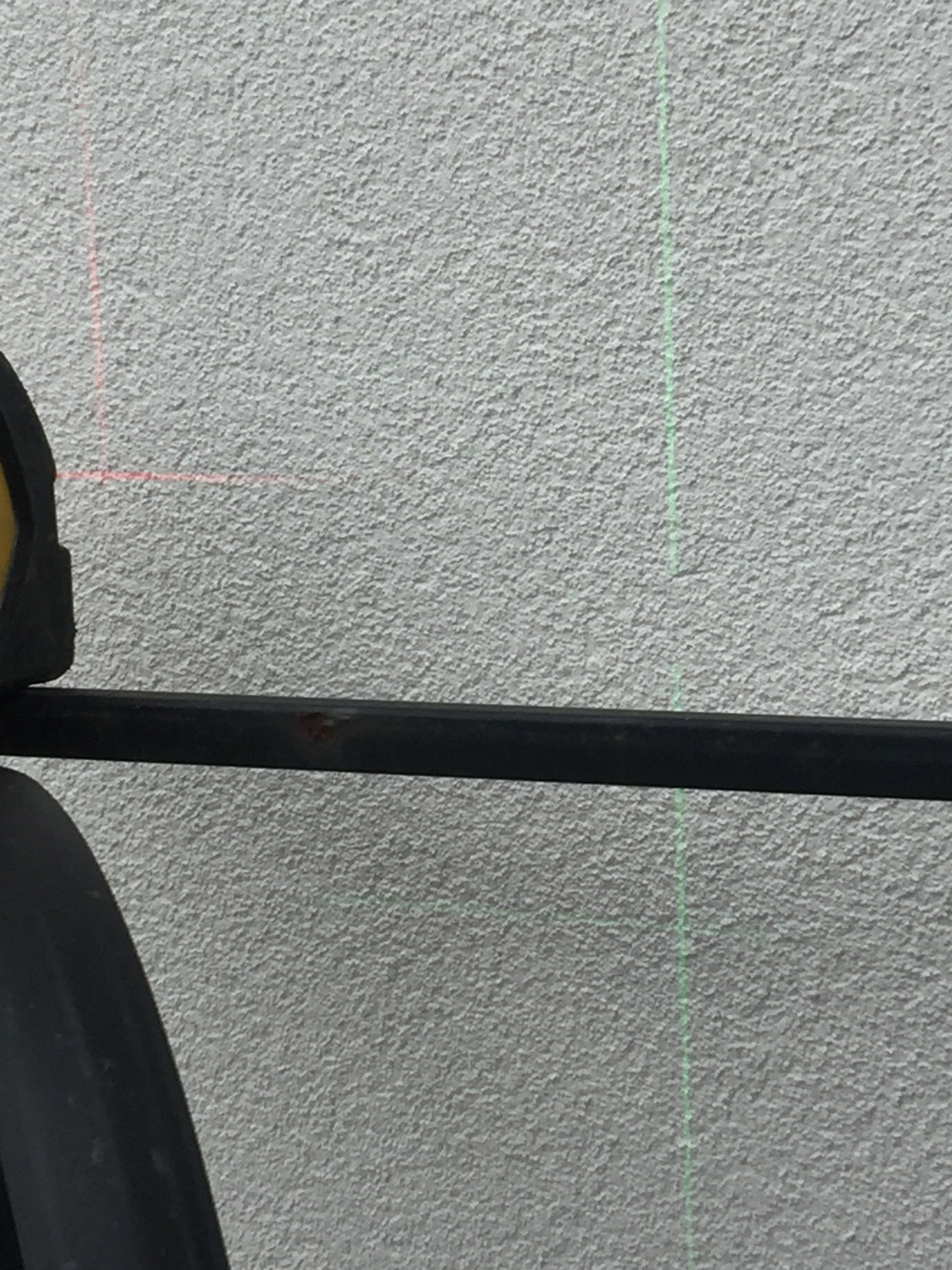

A little test performed just now at 1pm in the garden, bright sunlight, on a white wall!
U can see cross hairs of my old Fat Max SCL laser and the cross hairs of my new Dewalt green multiline laser. (The horizontal green line is below the black line, they were different heights.)
Second pic shows the green line extends much further than the red.

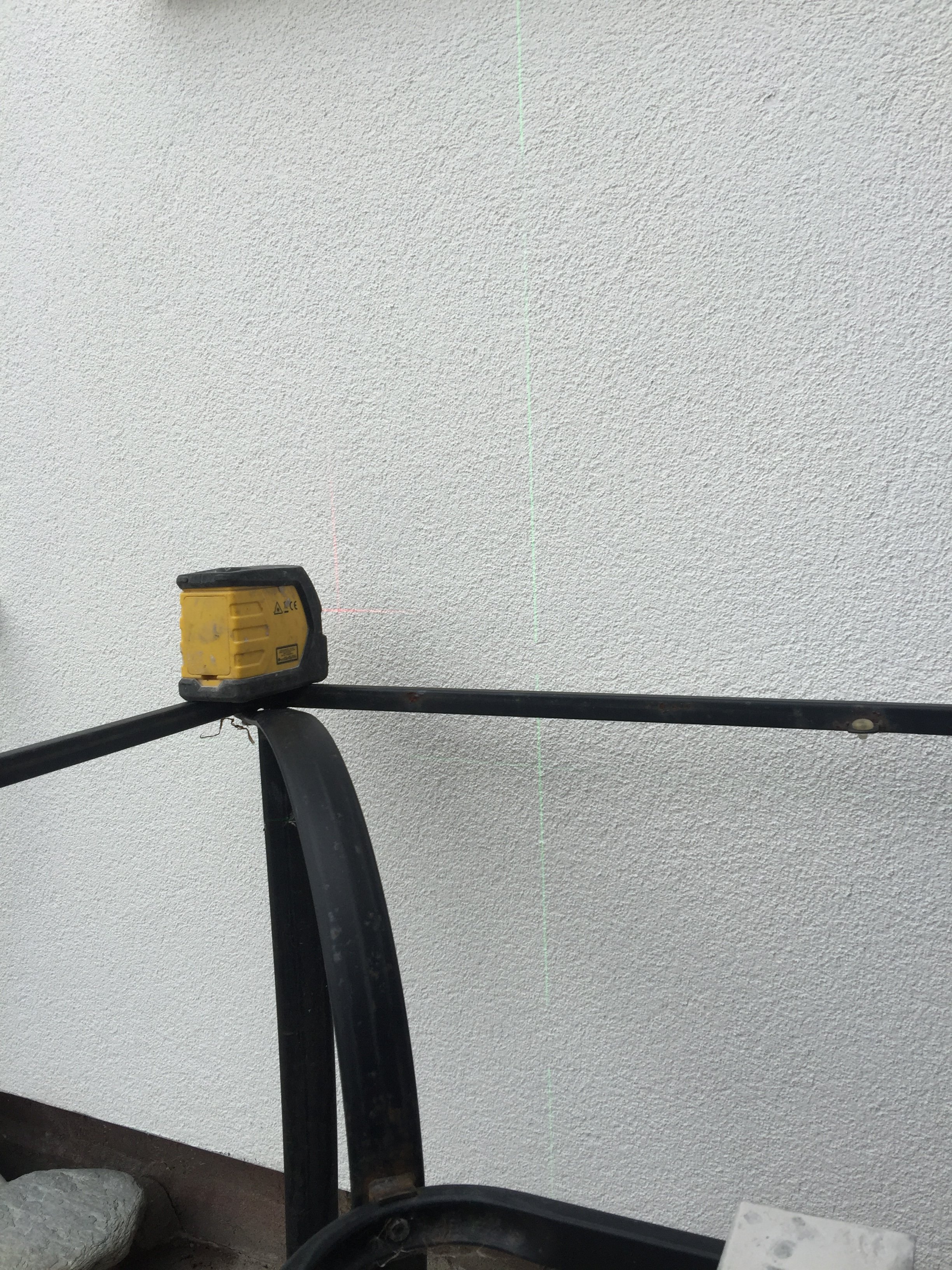

Third pic, well, conclusive proof I think.
Oh the Fat Max, 75mm from wall,
Dewalt, 790mm! 🙂

Yep, there's no comparison, the green laser is much better, but you get what you pay for as the saying goes
