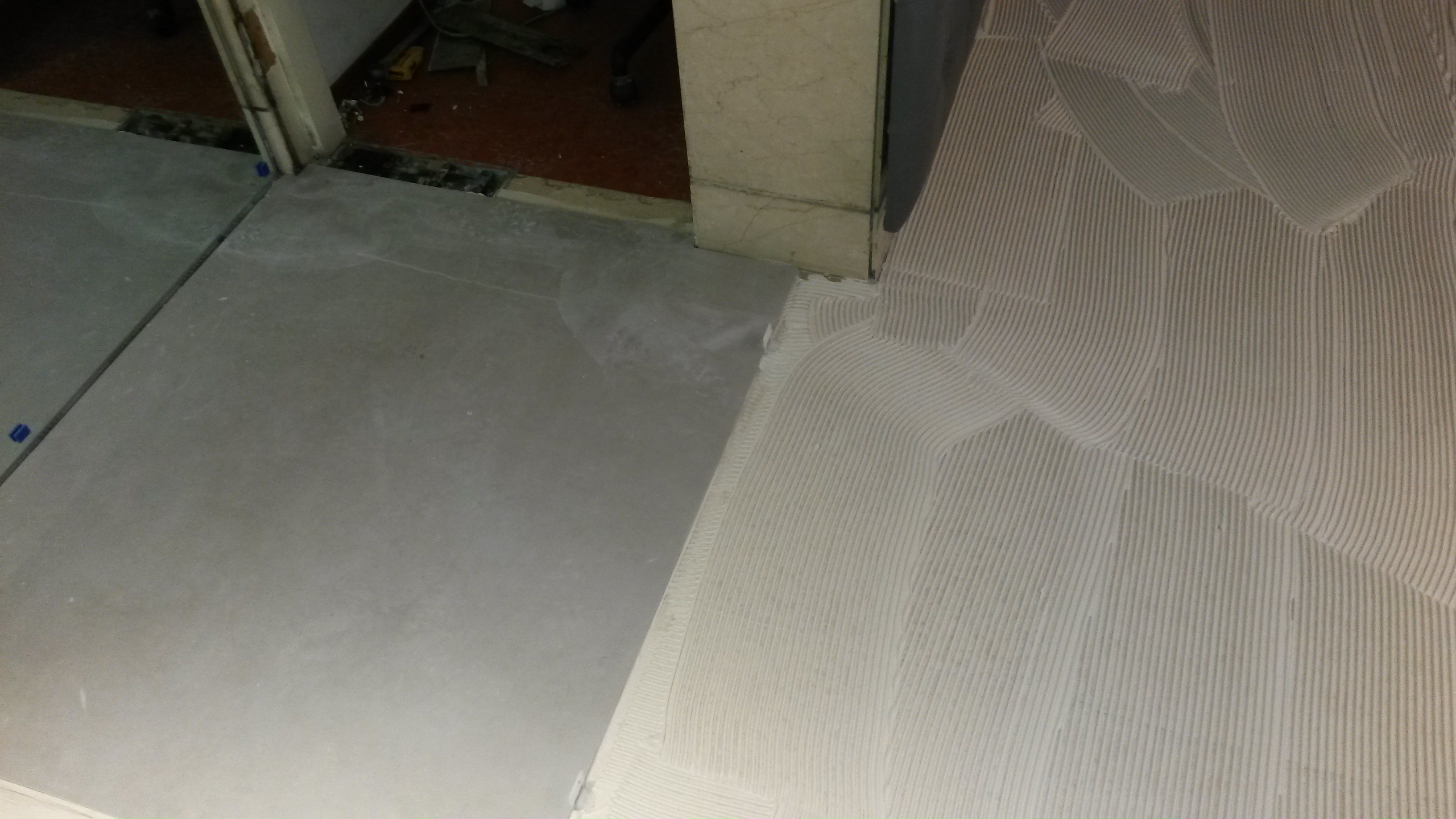

I Italy Nov 21, 2015 #11 Simons70 said: View attachment 78355 3000x1000 mm,right adhesive,right mixed,right trowel,Ray know better! No 3mm with fibra glass,is a nightmare... Click to expand... I give an spatulated glue on the fiber Last edited by a moderator: Nov 21, 2015

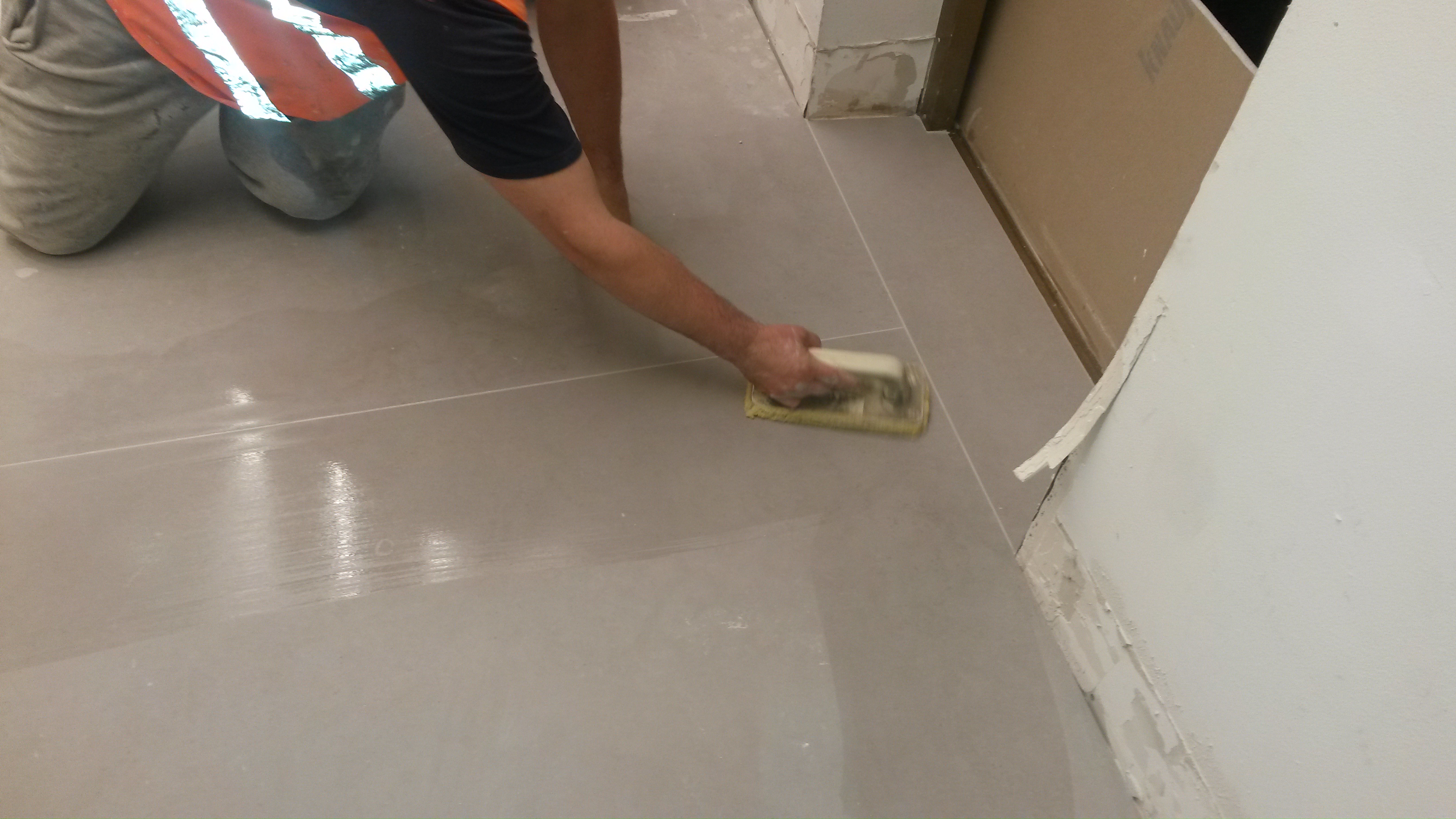

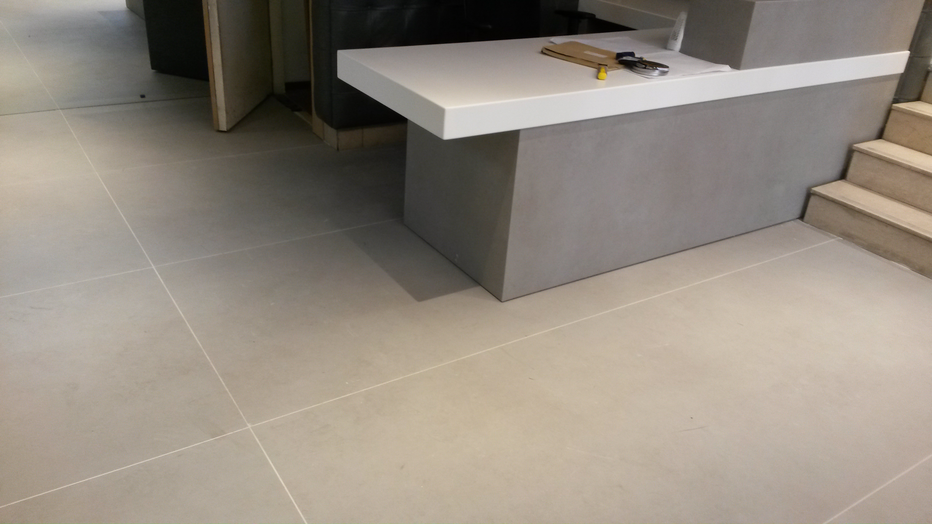

I Italy Nov 21, 2015 #13 Simons70 said: View attachment 78356 View attachment 78356 we broke some pieces 3mm,really hard! View attachment 78357 Click to expand... hai,hai,hai @Simons70 it is normal to break a few piece (piece, no whole slabs!!!) great job simons
I Italy Nov 21, 2015 #14 antonio said: hai,hai,hai @Simons70 it is normal to break a few piece (piece, no whole slabs!!!) great job simons Click to expand... grouting it seems very wide. I'm wrong? I control you @Simons70 ,ahhahaha that beats me , is old 🙂

R Rizzle from the Portizzle Nov 21, 2015 #18 antonio said: latest work, recommended Mapei Ultralite s2. double spreading the same direction, horizontal or vertical, double spreading NO crisscross .(recommended by the course Mapei) Click to expand... you need to take a look at that adhesive under glass see how it spreads out you may be in for a surprise
