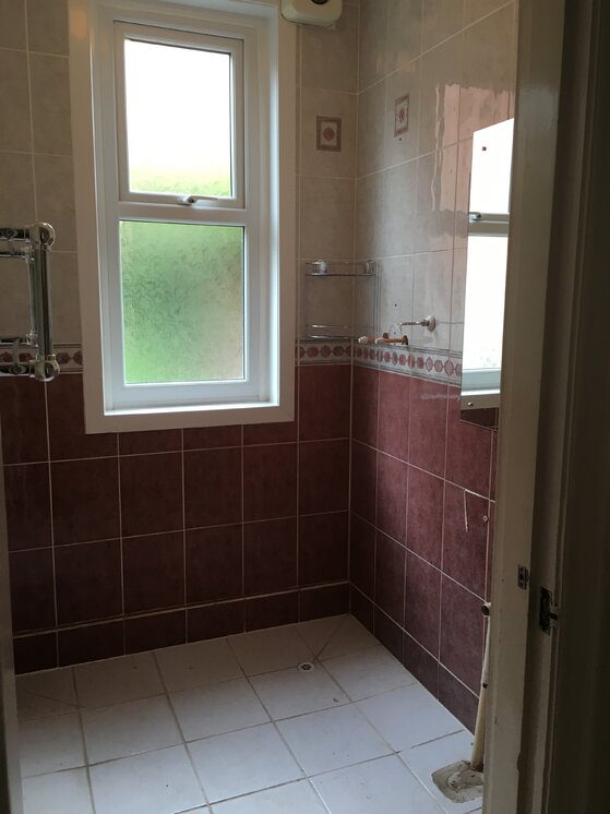

Im removing the existing tiles first, so will only know what the substrate is like once they're off. Possibly have to install backer board?
You will need a substrate capable of holding such a heavy tile, Hardie would be suitable.
is it an actual wet room or just a shower with tray?

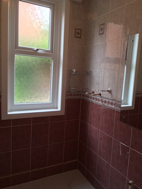

It's an existing wet room - very dated ... See couple of pictures
Nope, it's staying ... For now. They've been given the "posh" tiles by a family member from a high end tile shop on kinds road London and waiting to see if they can get some more. So they want to keep the existing old floor for now
I wonder if they know what they're letting themselves in for by being given this material.
That's all the walls stripped back to stud work and replaced. Tanking of the walls. Hardie is not waterproof.
And you're going to have to pay particular attention to the new join in the transition between wall and floor. This will now be a weak point in the install if the floor is to remain.
U may find u'll have to remove some of the floor tiles on the wet side of the room to ensure you get a correct seal between wall and floor.
Otherwise that will be the first place it will fail.
in fact do you know what you're letting urself in for, being as you've described yourself as a newbie?
Not trying to put u down or anything, but be 100% sure of what u are doing or there could be very costly mistakes to you.
