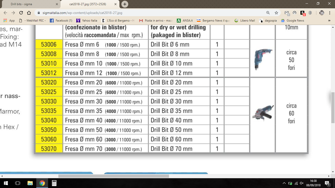

Some large diameter hole saws im experimenting with running at a slightly slower speed as peripheral speed at 12000 rpm with large drill is properly fast with a large diameter
Yeah I just had a couple of 35mm holes to do and I found it was better using the grinder on a lower speed.. Cleaner finish
Eh? i thought a larger diameter would rotate more slowly than a smaller diameter?
do you mean its better to slow them down so they're easier to handle?
The larger the diameter the faster it spins at the perimeter. Like bike gearing. Probably why larger grinders are less rpm.
I understand what you’re saying @Localtiler and agree with you.
RPM is RPM but the speed that the actual outer part is moving is faster. The bit that does the cutting is moving faster against the tile than if it were a smaller hole saw.
