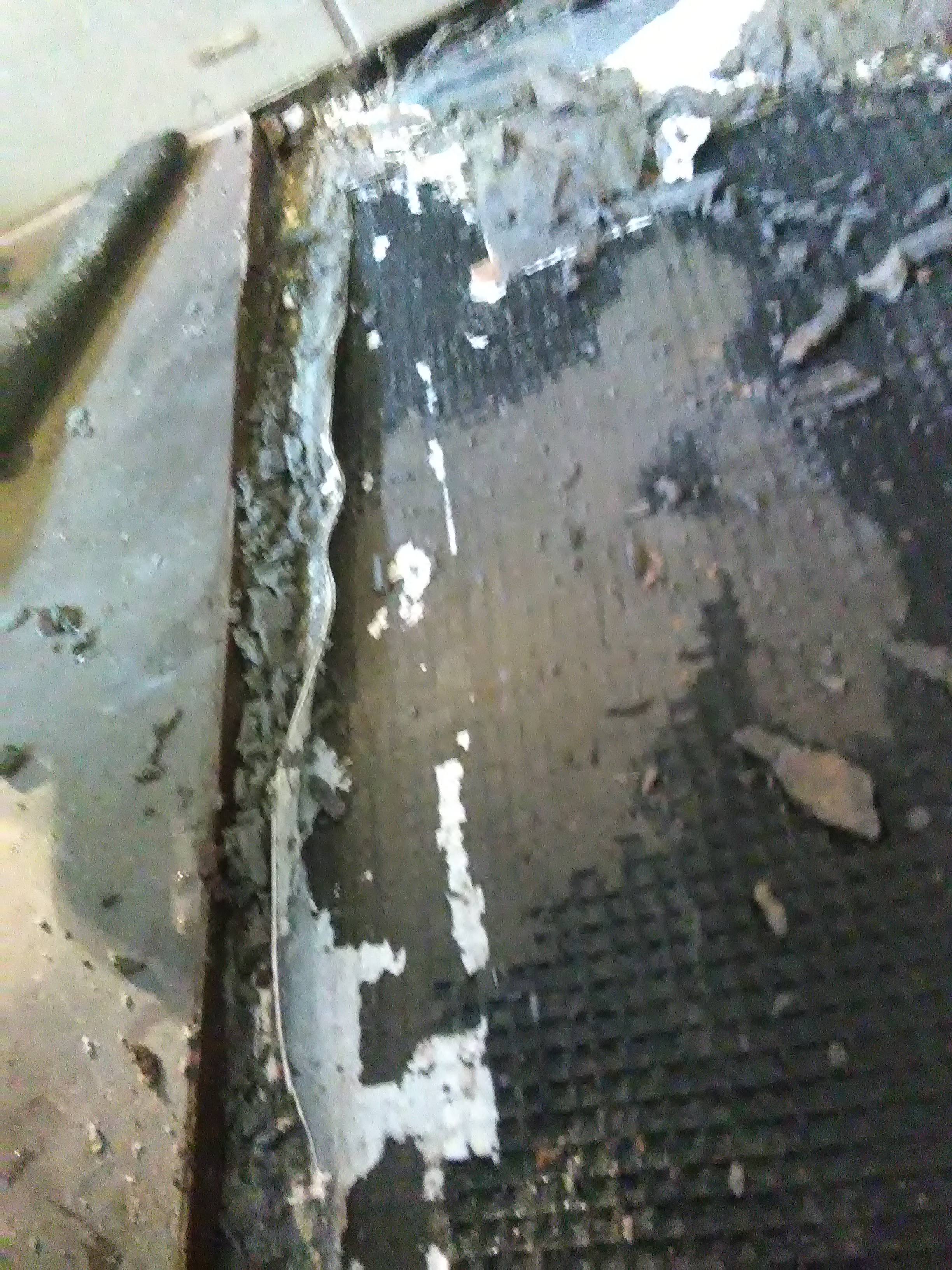

I bought a kit from ebay with the form, latex, skrim and corner parts and did as the instructions advised, one year later and I notice some grout loose, followed by a wet spot on the ceiling below.

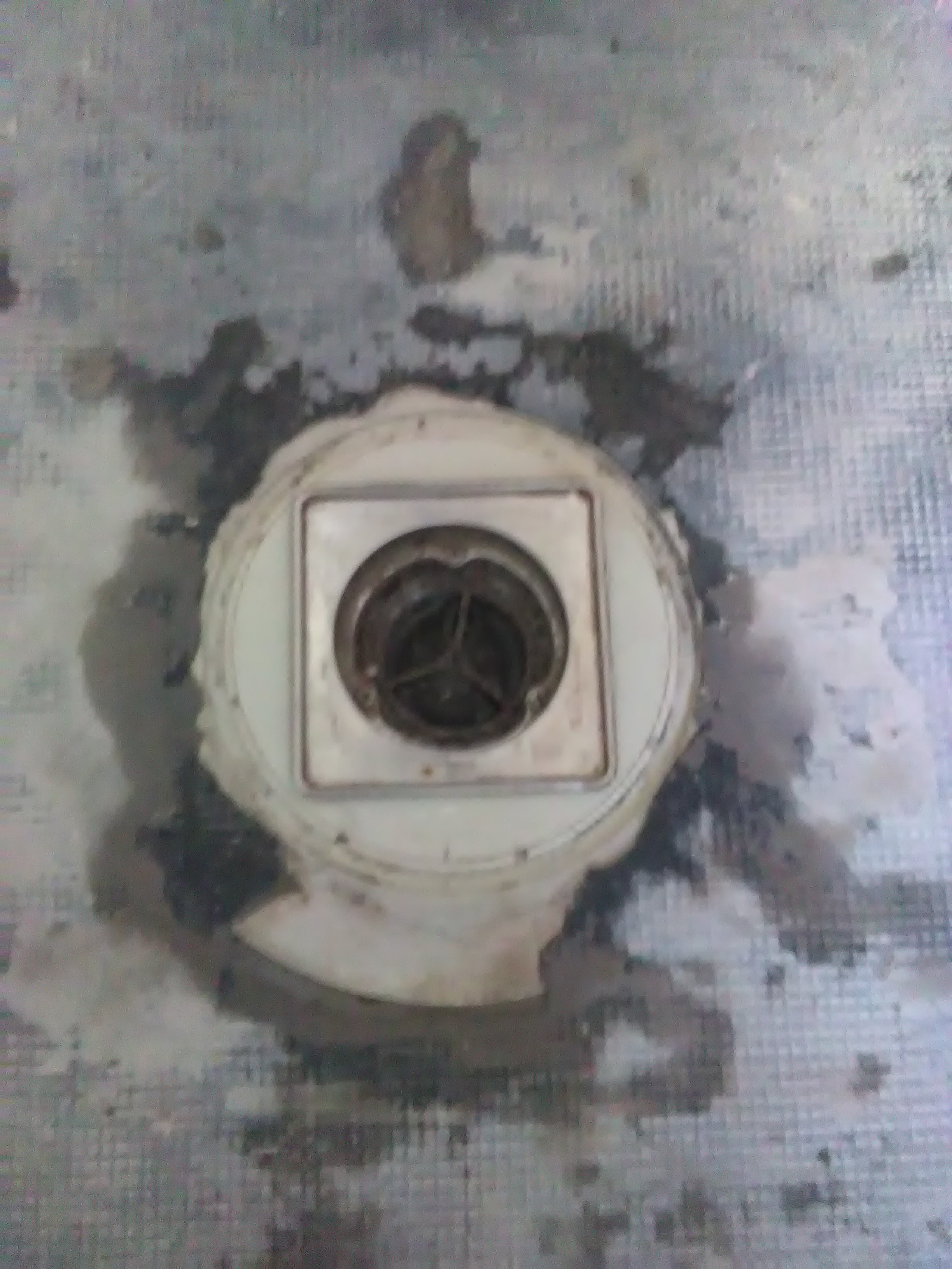

I took up the tiles this morning and found that there is loads of water underneath, the adhesive and also the latex seems not to have made a good bond with the board. On taking up the tiles, I noticed that some of the tanking is now ripped, I suppose I will have to remove the first course of wall tiles and completely re-tank the whole floor and lower wall, or is there a chance I can get away with sealing evrything down with a new tanking coat?

I have found that it wasn't the material (skirm) that has torn, just the latex, I'm cleaning it up now and think I may be able to get a membrane to lay underneath the corners and skrim, stick it down and seal the edges to it.
There also seems to be water penetrating around the ring of the waste, I'm thinking I could run the new membrane into the edge of the drain to stop this happening again..

The transition between wall and floor is an obvious weak point, you need to be sure on your ability to completely seal it.
That former doesn’t look very well either.
You should tank well beyond the wet area too.
Did the drain have weep holes around it, we’re they blocked?

I've just finished cleaning up and am sure that the material strips are intact and that I can seal a membrane under the corners, then seal the corners down to the membrane and have a 100% seal.
It's not just the aggro of removing the tiles, i'm concerned that I will pull off the waterproofing if I do so pretty set on this method now (I hate to be the person who asks advice then ignores it but I'm confident I can fix it!)
About the drain holes, I think this was the problem, it was my first wetroom and I wasn't really sure what was going on with that bit, what is the correct procedure here?
It’s fairly straightforward, if it has weep holes, make sure they’re clear, and use only grout around the drain when tiled, not Silicon.
If seep holes are not present, Silicon.
I have cleared the adhesive from the weep holes and the ring of the drain but this is under the tiles when its finished, is it just a case of leaving the ring and holes clear when spreading the adhesive, leaving a small void beneath?
I am thinking of coating the whole thing with two layers of mapei liquid membrane in order to keep the tiles at the same height now, fitting a sheet would involve another layer of adhesive, do you think this would be adequate?
