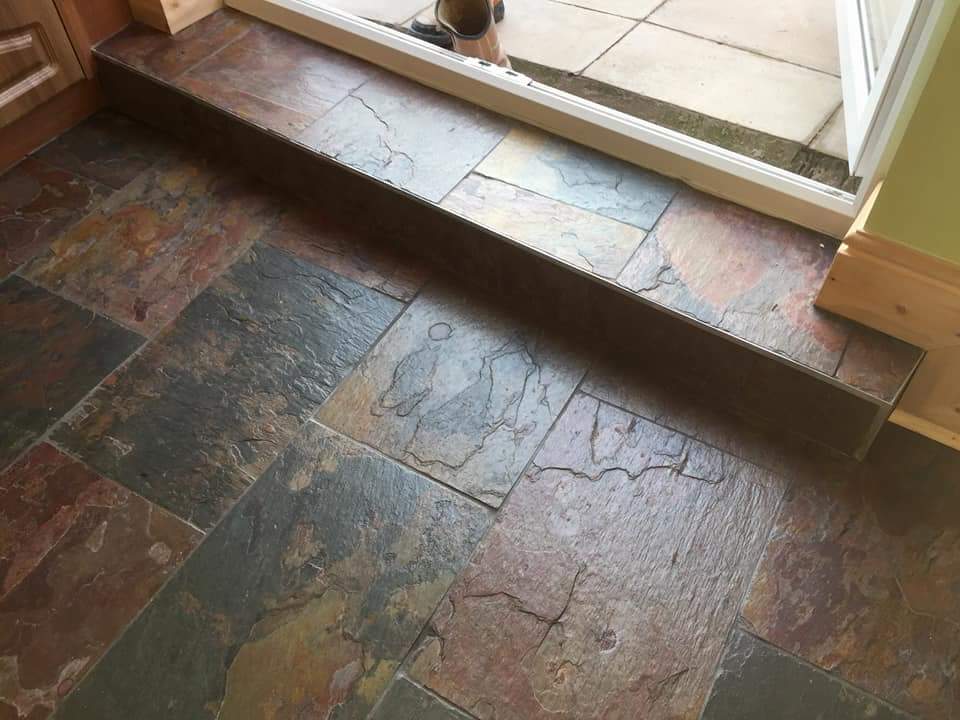

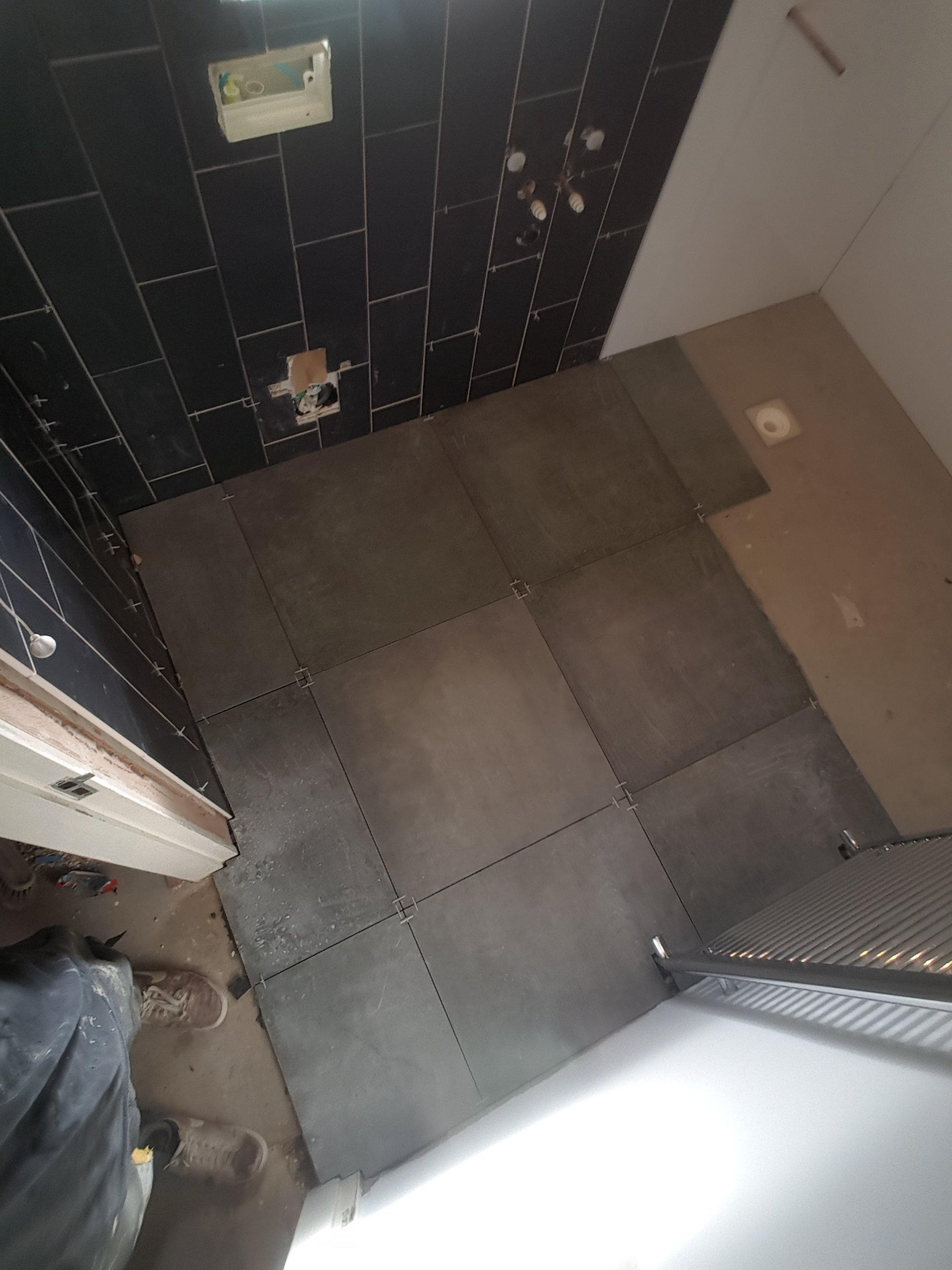

These are just a few pictures of my work over the last few months just to try and give you an idea where I'm at. I want to get faster as I'll be on better money when I can do it quicker but mainly I want to improve the quality of work and speed should come with time. Just to say I didn't do the shower area floor with the mosaics, my uncle chose to do them as I'm not experienced enough really and didn't feel confident but I did tile all the walls etc.

You can post all the photos you like, your tiling customers houses, without really knowing what you are doing.
I'm not being rude or arrogant. I'm not even trying to claim I'm a good tiler. I just want help and advice. I get that I should try and work for a tiler, which I'd love to, but it's not possible at the moment. The pictures where just so that people can have an idea where I'm upto. I thought I'd get help on here not a rude response. I want to know where I'm going wrong and what I can do to improve. As I said my uncle can only teach me son much and figured that I'd get help from people on here.

the guy just asked where he can improve ..
if its bases are wrong, it's not his fault.
but it is the fault of his uncle, which moreover tells him to be faster.
and that's the biggest mistake.
Thanks for understanding. I didn't even realise that dabbing tiles on was bad until I made this thread. I only have my uncles word to go off and my own research. He wants me to be quicker because it takes me twice the time it takes a subbie he used to use who had 20 years experience. I've asked a few times to start using backer board on the floors and he says he will look into it but it's more expensive. Quite often I have to tile on walls that aren't great and I was told dabbing the tiles is the only way to get over walls like that.
Hi those are British Ceramic fossilized wood effect tiles and as others have stated not the best to work with (slight variations in size and squareness) have done about 4 bathrooms in those but 3 were in brick bond making it easier to loose any variations. You should try to get a 6ft (1,800mm) level and small wedges to get the first course as level as possible and keep checking as you go. With those tiles you might have to offer them up as you go to check the grout joint and swap/turn around until ok as they can vary so much. Also never dot and dab, get a good slow set powdered adhesive with a good bed depth that should get you over most walls and give you time to get things right.

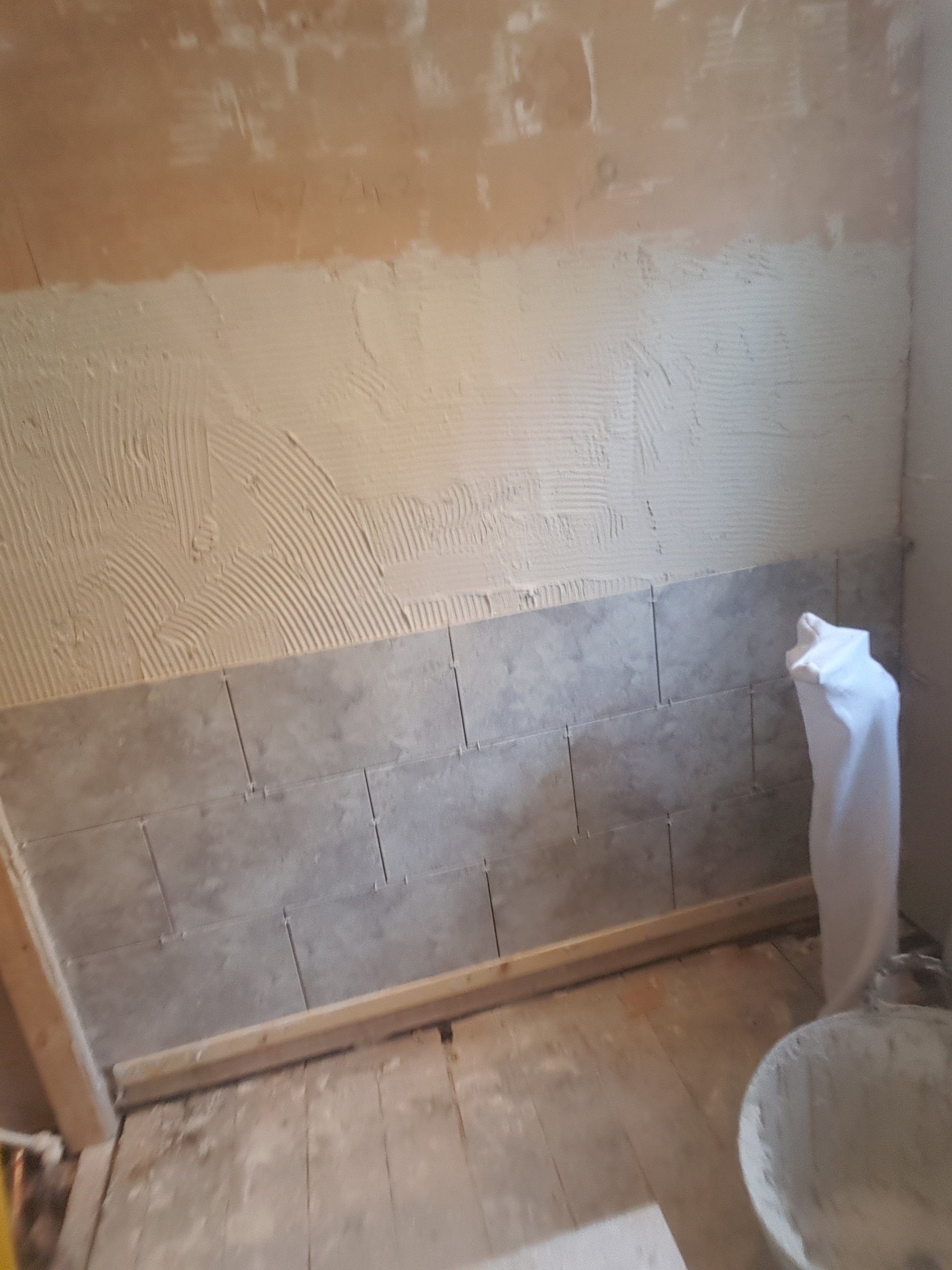

I've took your advice guys and startEd combing, just struggling with getting a thick enough bed but I'll get there with practise. I've had to add the odd dab to bring a corner out but that's it. Apologies for the blury picture, only front camera works.
